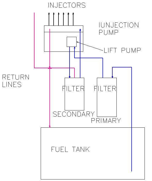

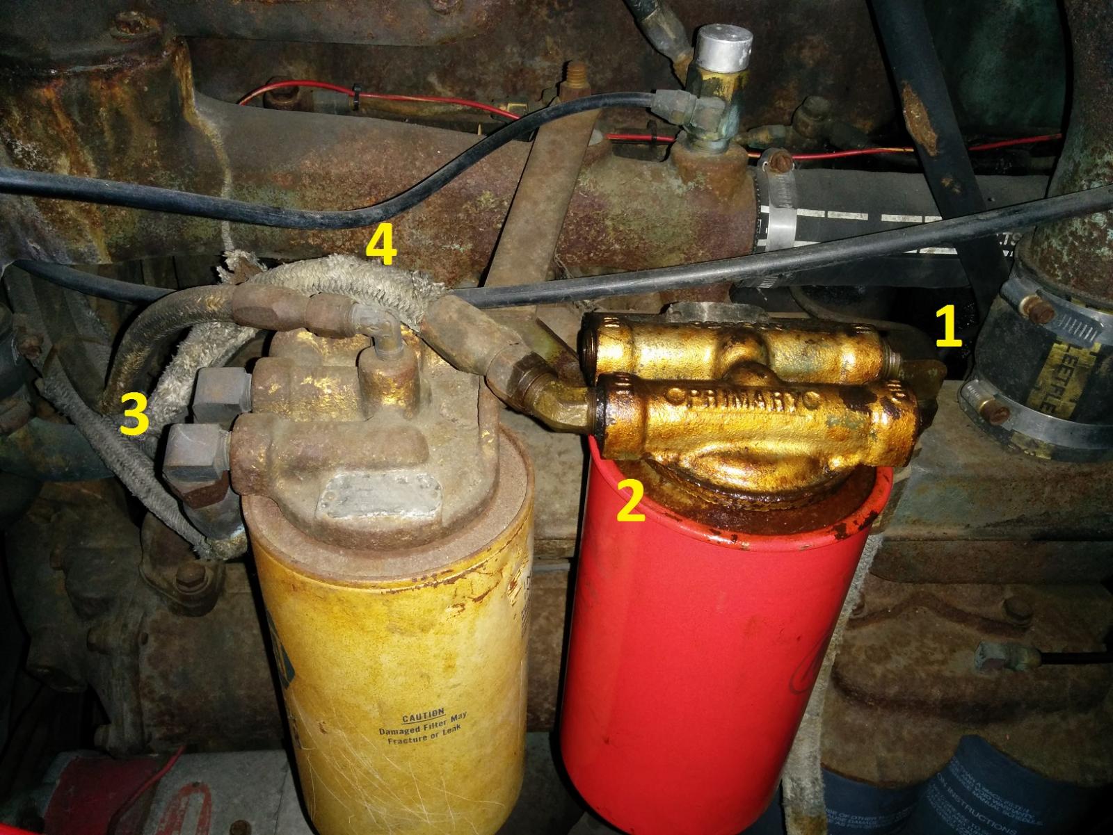

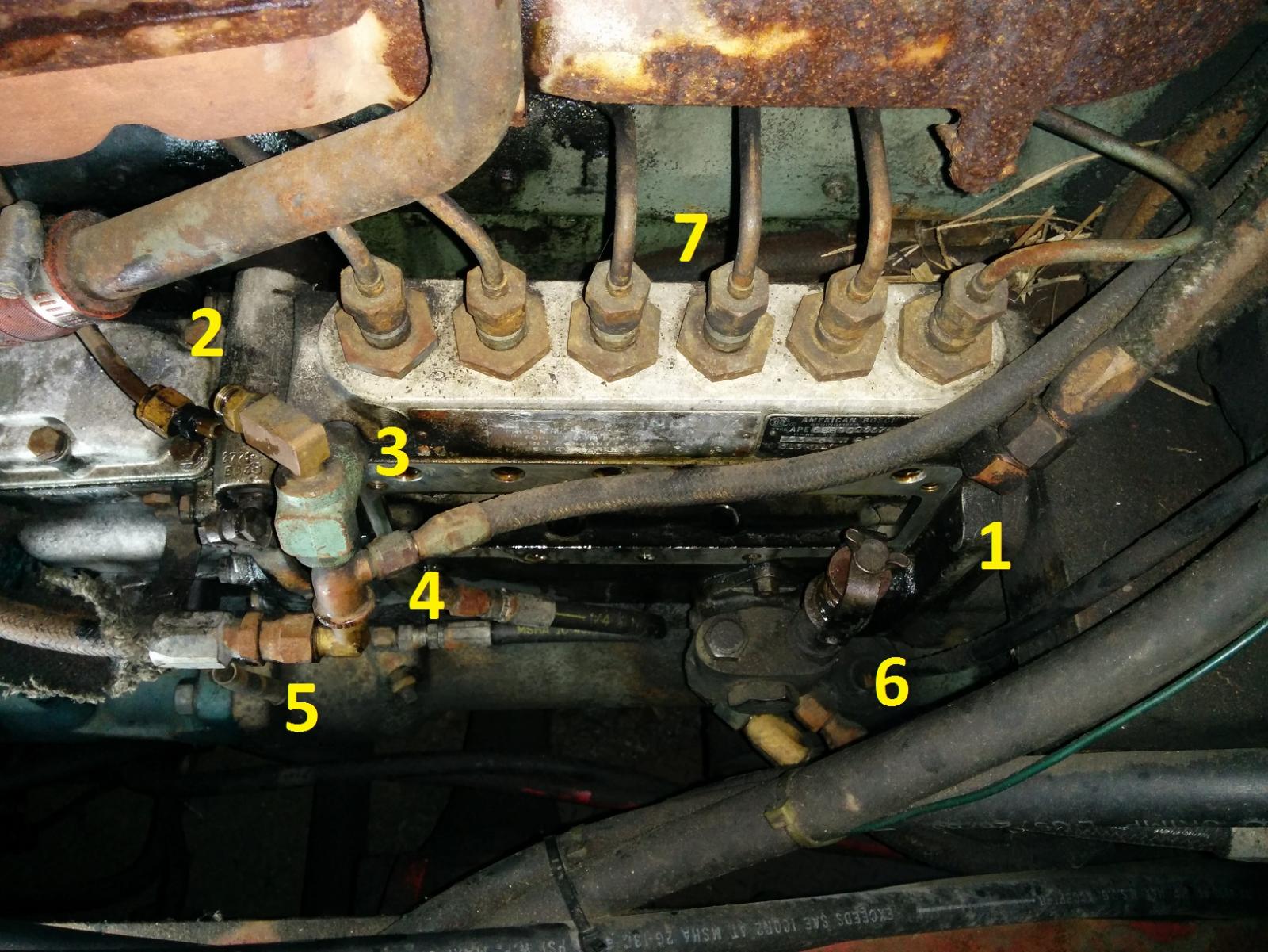

Sounds close to my problem. Though, I never touched my filters before my problem. As other has said sounds like you are loosing prime from the pump to the tank. I would unscrew the new filters and clean the seal and the face of the filter mount to ensure there is a tight seal. Any air between the tank and lift pump and you will lose prime. It is also possible that perhaps the primer handle will let some air into the lines as well, my primer handle on my 673 will bubble and leak a bit of fuel when priming. Though I would look at the filer seal first.
673 fuel questions, need me some edumacation
ThaddeusW replied to ThaddeusW's topic in Engine and Transmission
That makes sense! So used to the single filter on a gas four wheeler. -
