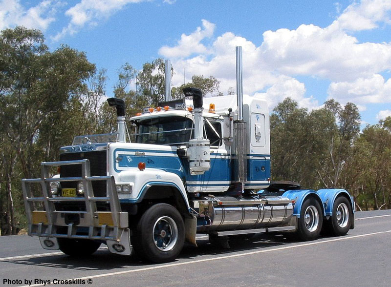

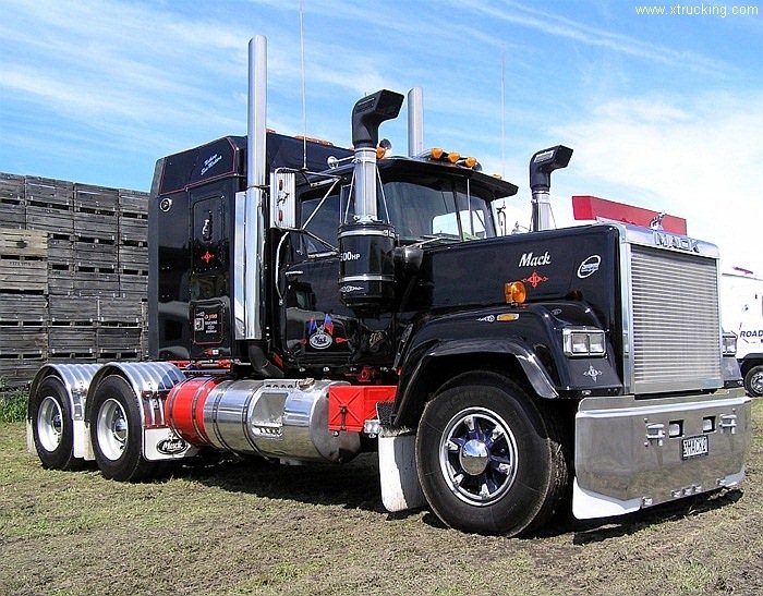

  2. Wow. At first glance I thought it WAS and Aussie Superliner! The snorkel arrangement has a tube from the top of the breather with I think three support brackets running from the outer diameter of the breather towards the top of the tube. Then a plastic or chrome metal scoop mounted at the top. There is also a second style that has some funky looking tube with no brackets. I am sure you could go to hankstruckpictures.com and look up thousands of pictures of Aussie rigs. Plenty of Superliners on there too! Some pictures to get you started: Here is one with the odd bracket-less snorkel: And another (Notice the Renault planetary hub reduction axles):

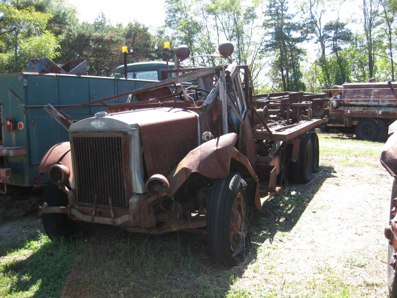

  23. Jeff, John, Thanks for the information. Lately I have been very interested in the 30's-40's Mack Iron such as the FC/K and BX models. I loved that green FKSW at Macungie 2010 and that got me interested in the older models. I like the old fashioned open wooden cab along with the "modern" Mack axles on camel back. Anyone know if a diesel engine was ever offered in them? I was reading a bit and I think a 155HP Cummins was available, not sure. Also what gas engines would these trucks have had? Thanks!
  24. Was browsing my Litiz pictures and I was wondering what this old truck used to be. Is this a Mack BX or possibly not a Mack at all. I have tried comparing this to other BX pictures and while not an exact match it looks close.
