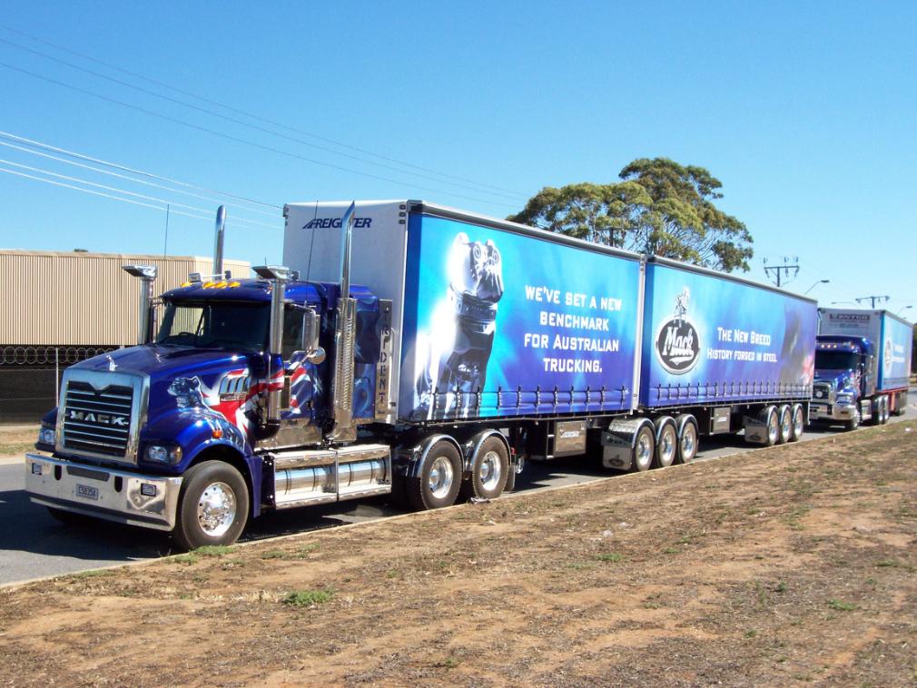

  5. They apparently are using the "Cornerstone" (Volvo) chassis in all their new models. The Granite was also added to their lineup and actually has sleeper options. They also seem to be pushing the Mack drive line more so now. The Models that were dropped I guess didn't sell enough. The Quantum was redundant in Volvo's eyes as they will just divert those customers to their FH series. Here are some pictures from the member "kenworth" on Hanks site: New Superliner: New Trident, note the Granite influence: Aussie Granite with a sleeper!
