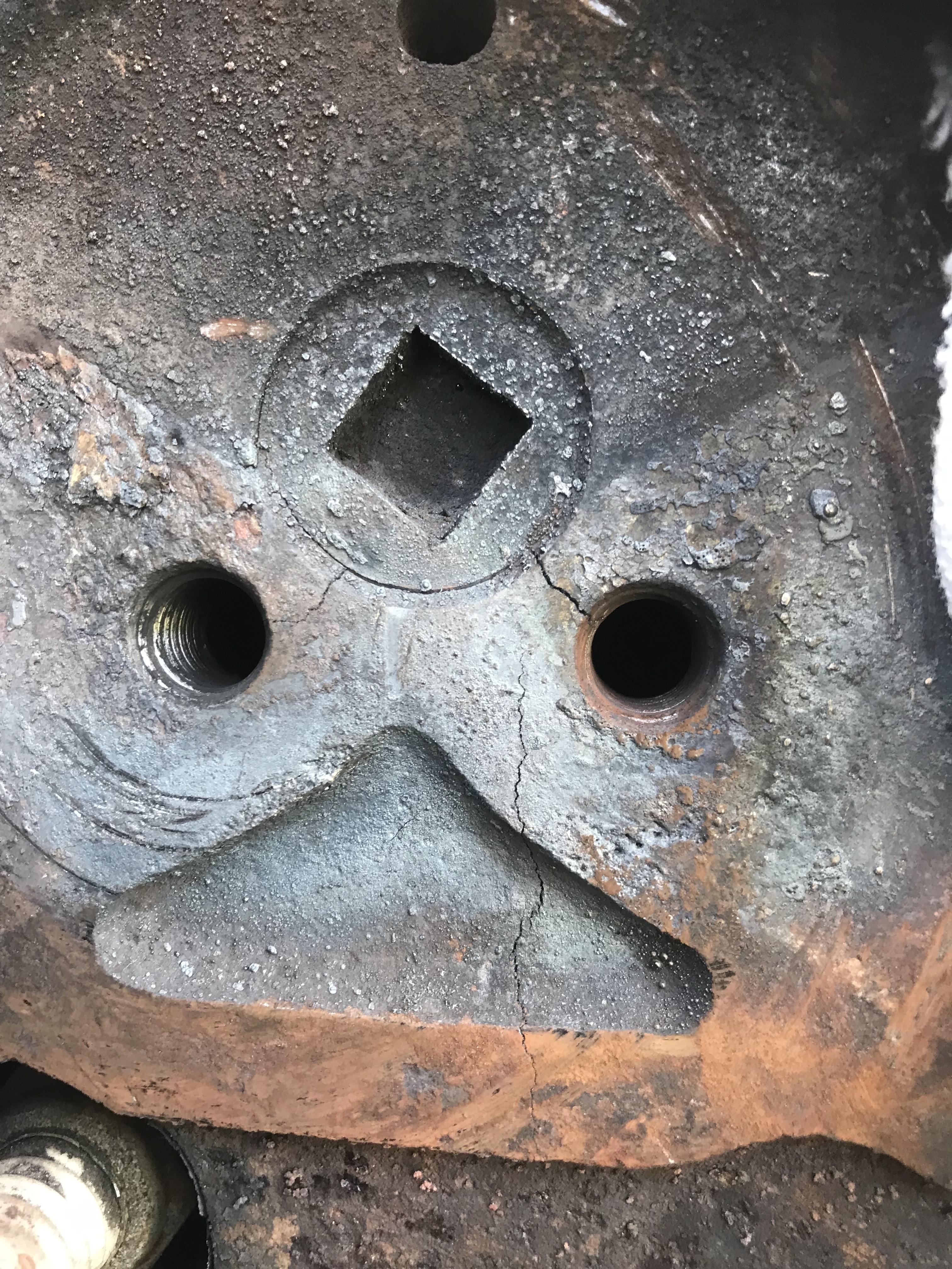

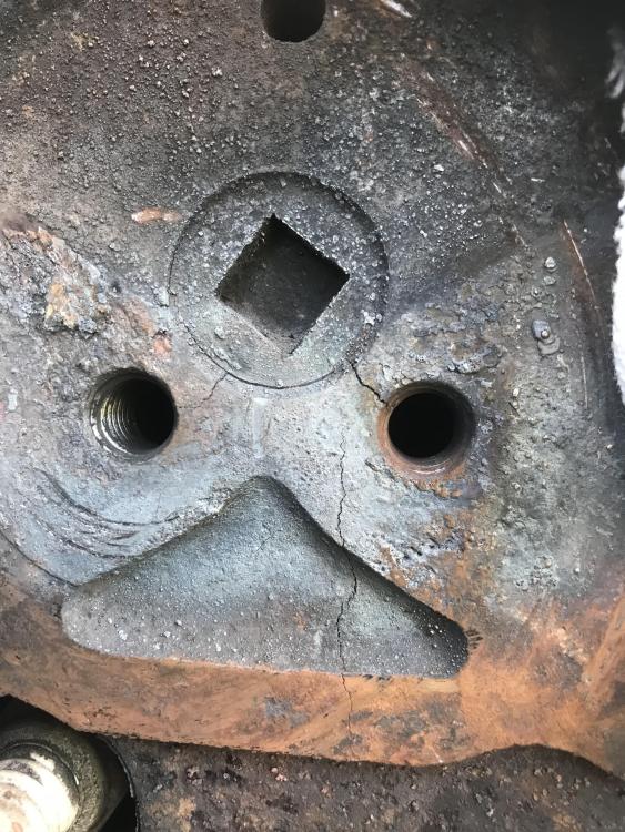

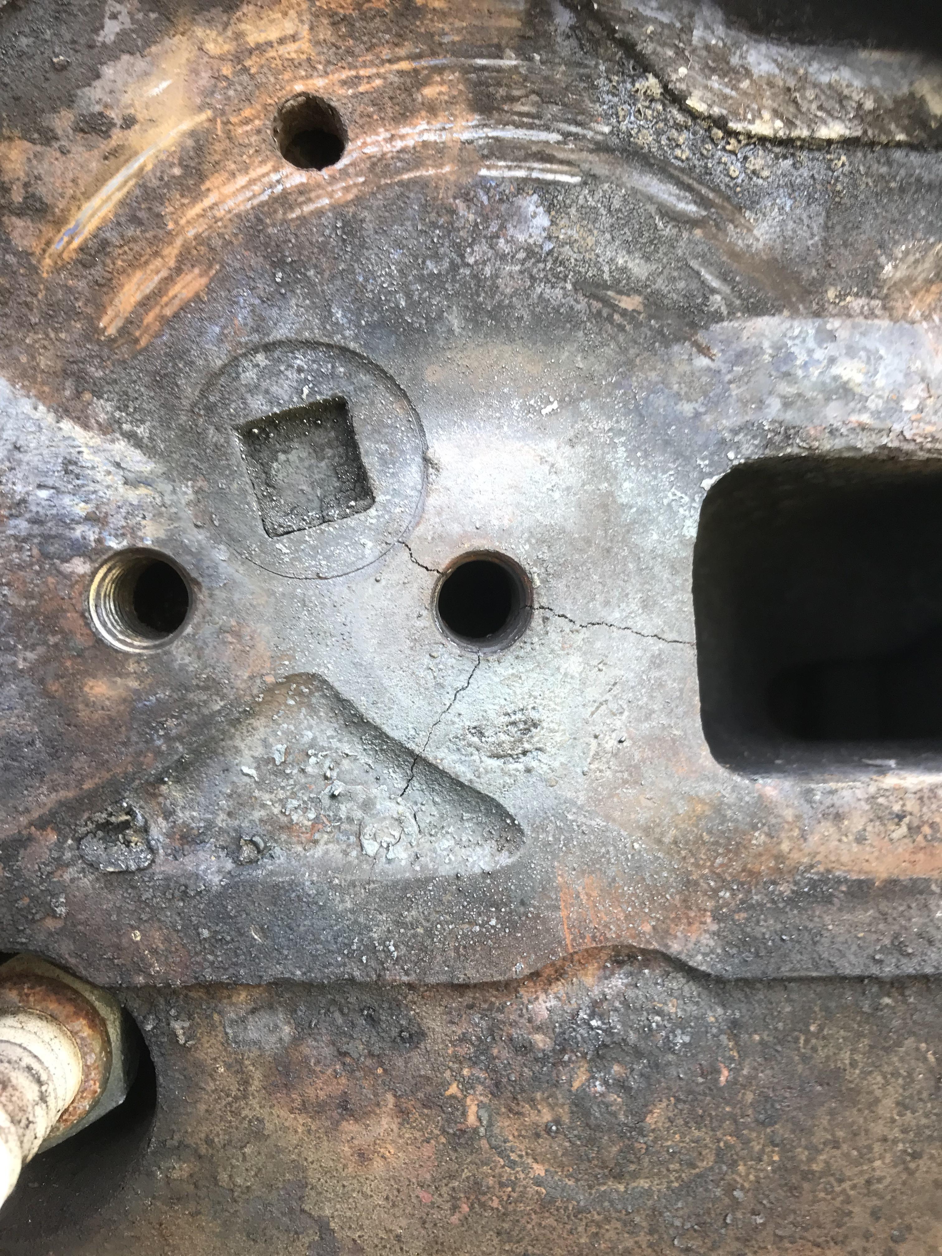

  2. Can anyone tell me if a 540 is basically the same as a 510? Will the engine bolt up the same, will the accessories mount the same ext. Any information would be greatly appreciated.
  3. It’s been confirmed, I am a dumb A$$. Today I putt studs back in the bolt holes and putt water in the engine. It immediately started leaking, as I was afraid of. Worse than that thought it was leaking inside a couple of the exhaust ports. If anyone has a pair of heads for a en510 I’m in the market.

  5. Thanks, Paul that’s what I was afraid of. Too make it worse I didn’t notice on the first head until after I did it to the second head. Well at least I learned something today.

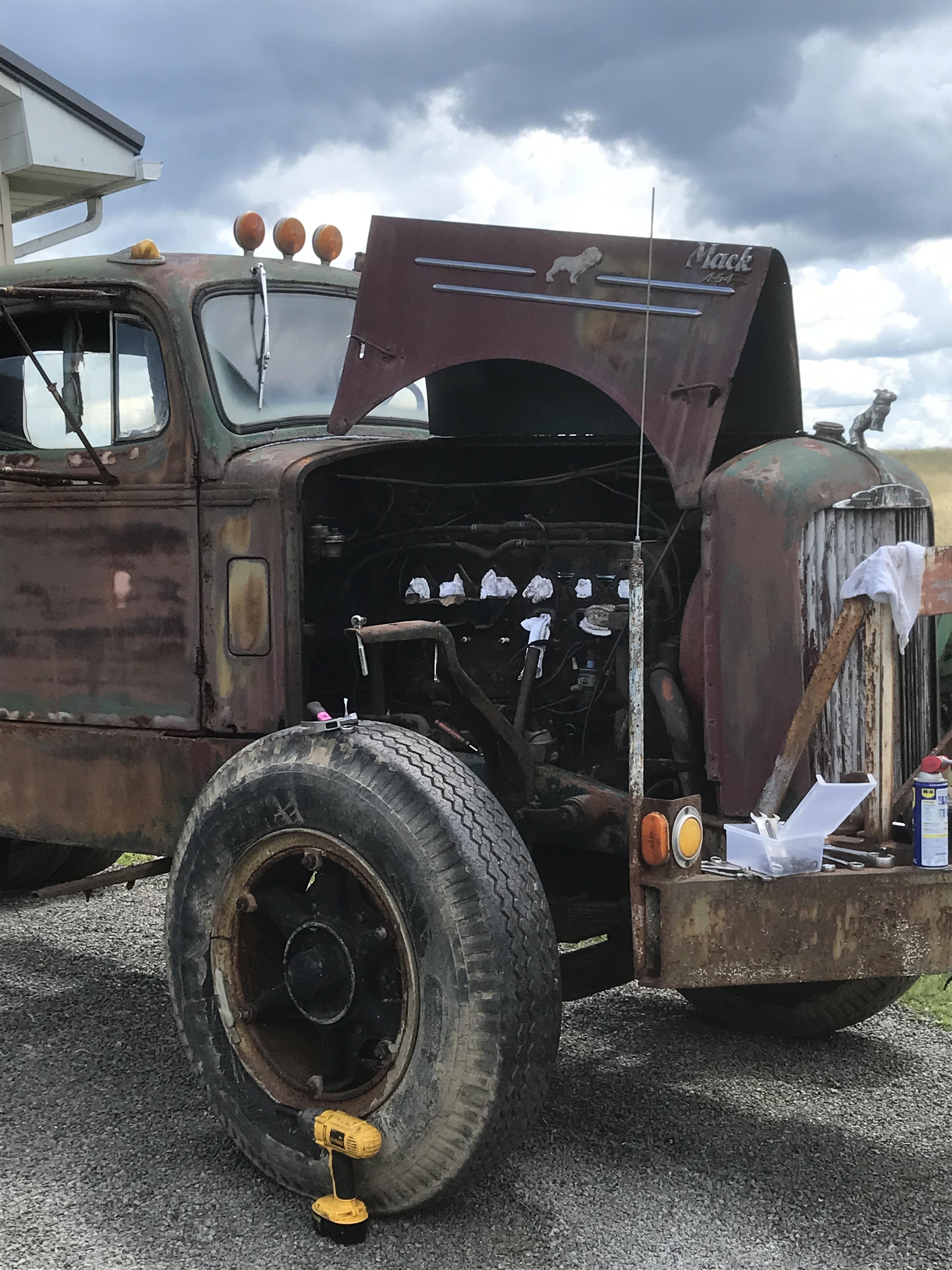

  6. I had a couple of broken exhaust studs I removed from the heads on a 510 gas engine. There was enough stud exposed that I could get a pair of vise grips on them so I got out the torch, heated the head and turned the broken stud out. All sounds good so far. However after the heads cooled down I noticed what I believe to be cracks coming from two of the bolt holes. Is it possible that the heads cracked from the heat, or where they cracked before and I didn’t notice it until I got the dirt & oil burnt off. Now where do I go from hear?

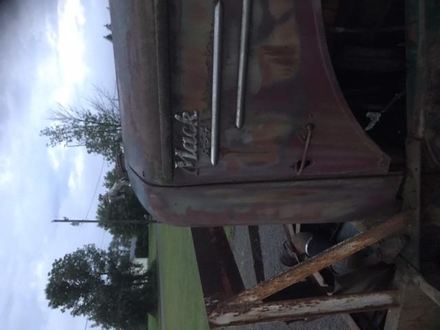

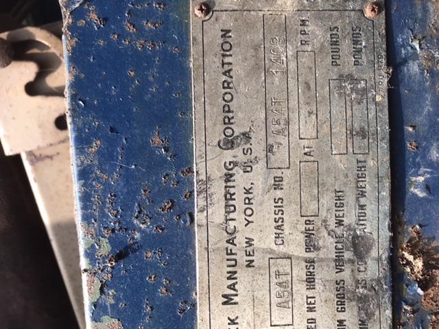

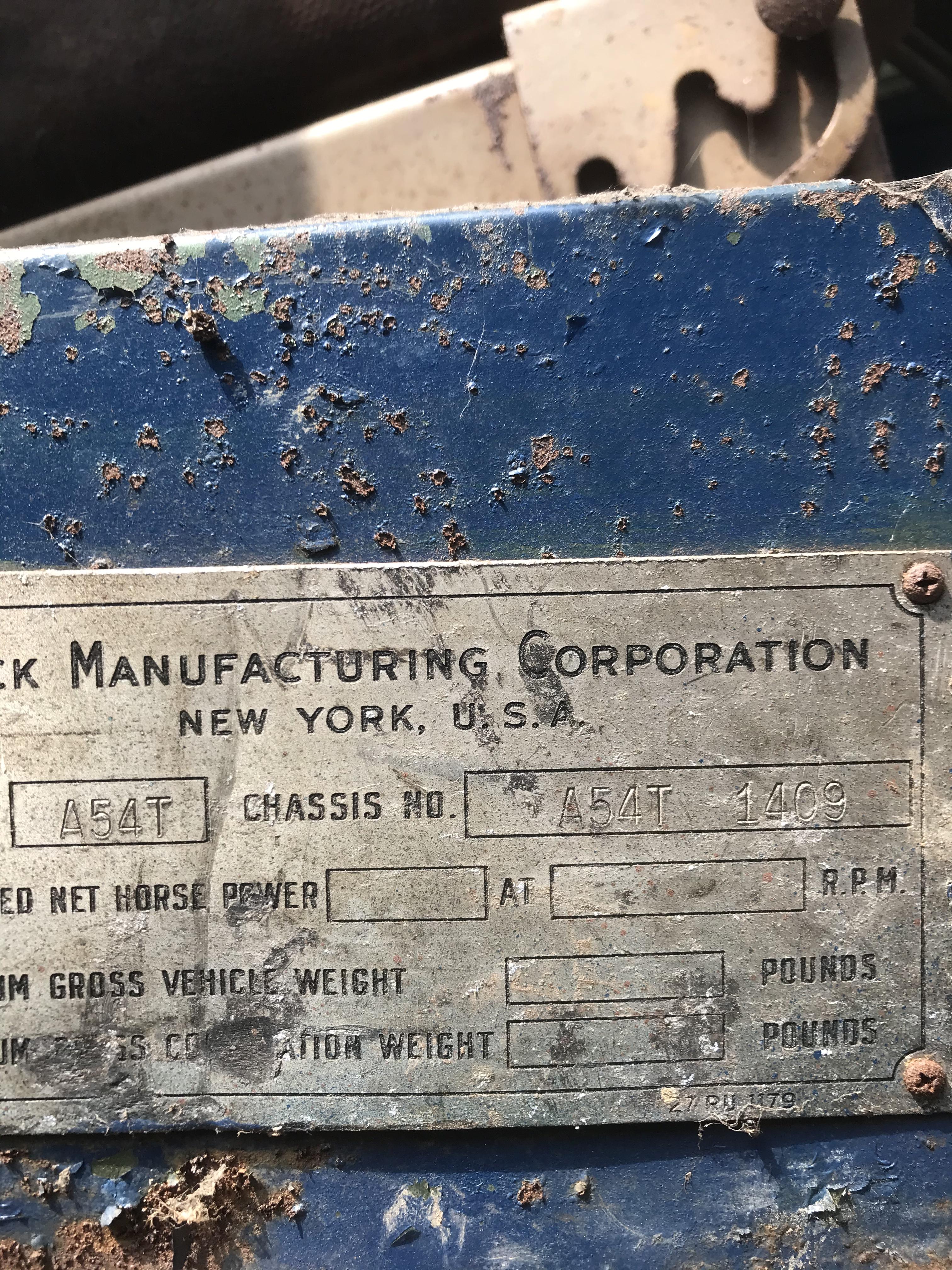

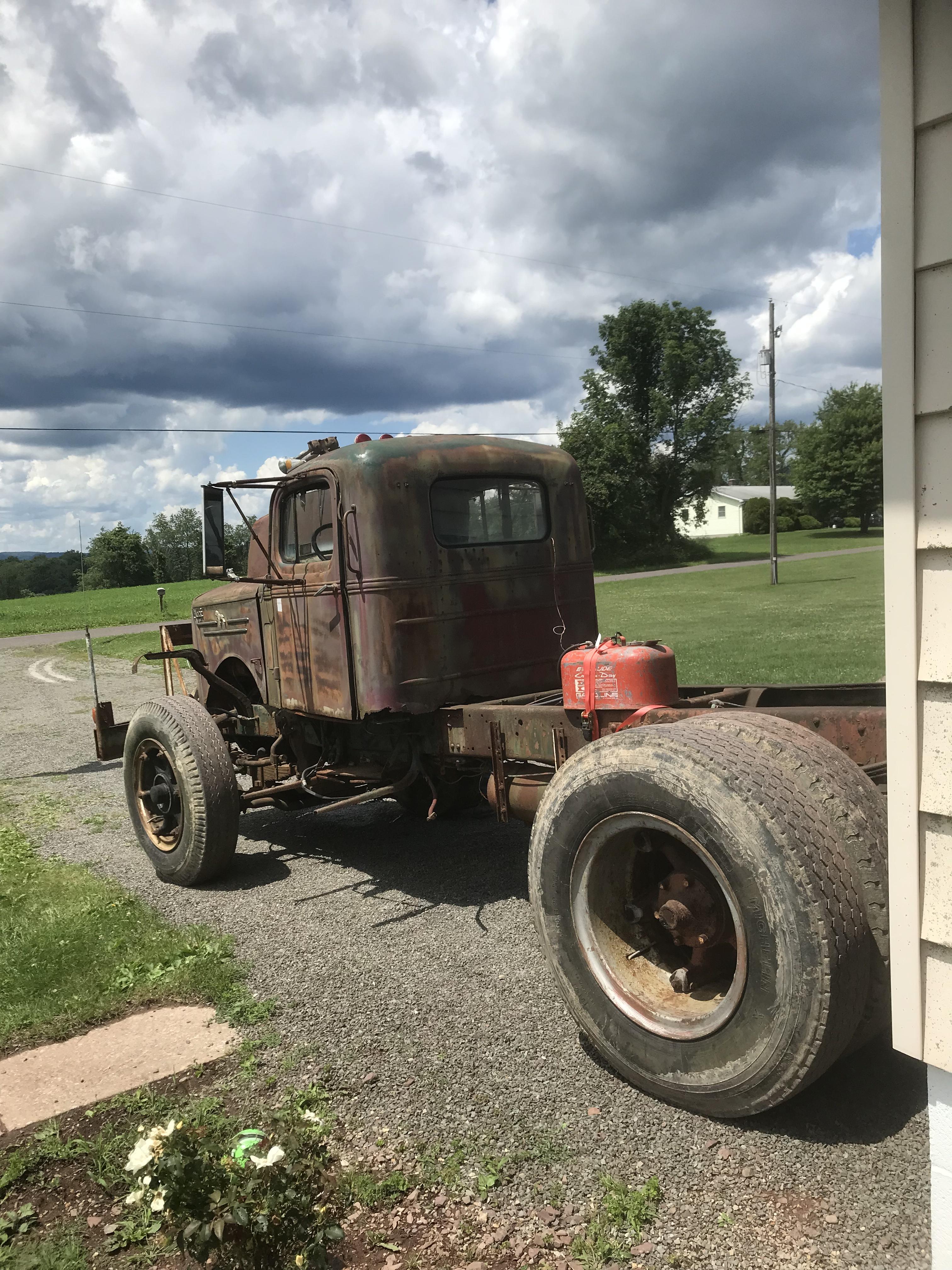

  8. Here’s a few more pictures. The hood matches the grill shell and the cab. The engine is a 510 gas with an Ellis dual carb intake. The model number is A-54T.
  9. I’ll try to take a better picture of the radiator cap tomorrow.

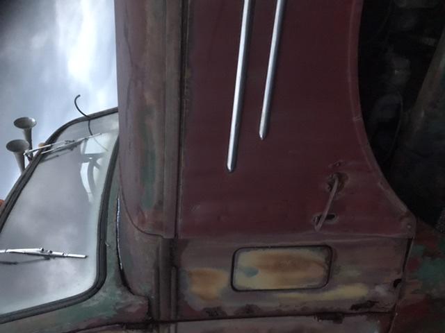

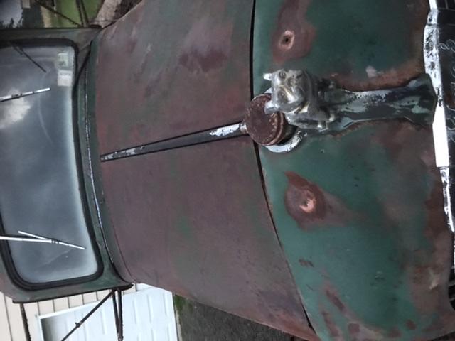

  10. I brought my A model home this weekend, and now I’m trying to figure out if it has the correct radiator/front end on it. I looked through all the A model pictures I could find, and mine is the only one I could find with the radiator cap on the outside of the hood behind the bulldog. Anyone have any idea.

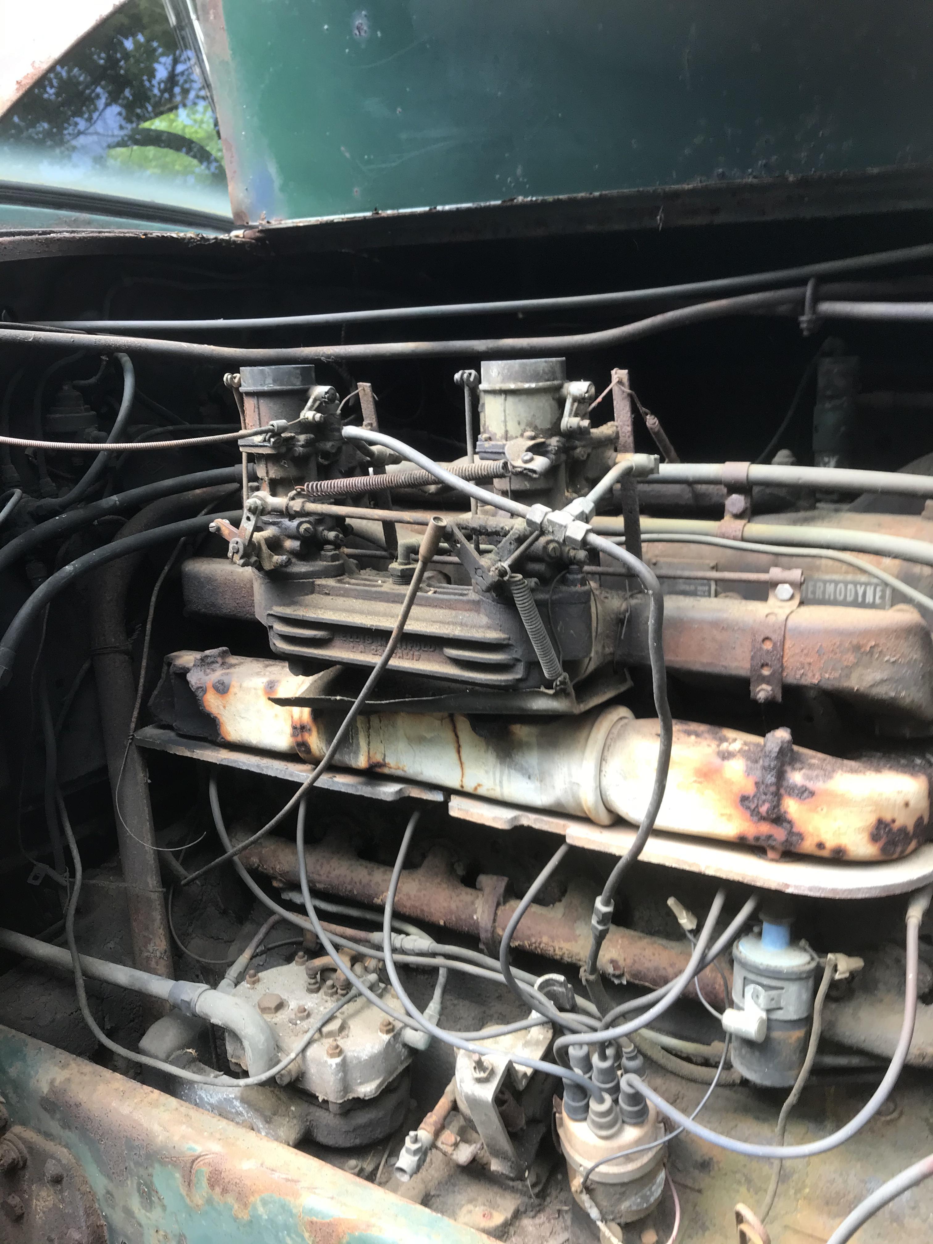

  13. I’ll be dropping a truck off tomorrow evening. Then coming back down for the day Saturday.
  14. The trip is just over 100 miles. The worst part is the ruff road through Tamaqua.
  15. After we replaced an axel seal, gave her a bath, and topped off the fuel we should be ready for the trip to Macungie on Wednesday.

  17. Thanks for the replies. I have been able to find a little info on the intake. As much as I like “original” I like functionality better, and this setup seems to be very functional. This truck set in the woods for many years. I blew out the fuel lines, filed the points, poured a little gas down the carbs, and it fired up almost instantly.
  18. It has a home made y-pipe adapted to the original air cleaner.
  19. Can anyone provide any information on the intake/carb set up on the A-54 I adopted last weekend? I believe the engine is a en 510. I think it should have an updraft carb of some kind, but it has 2 down draft Stormbergs on an Ellis intake. Any information would be appreciated.

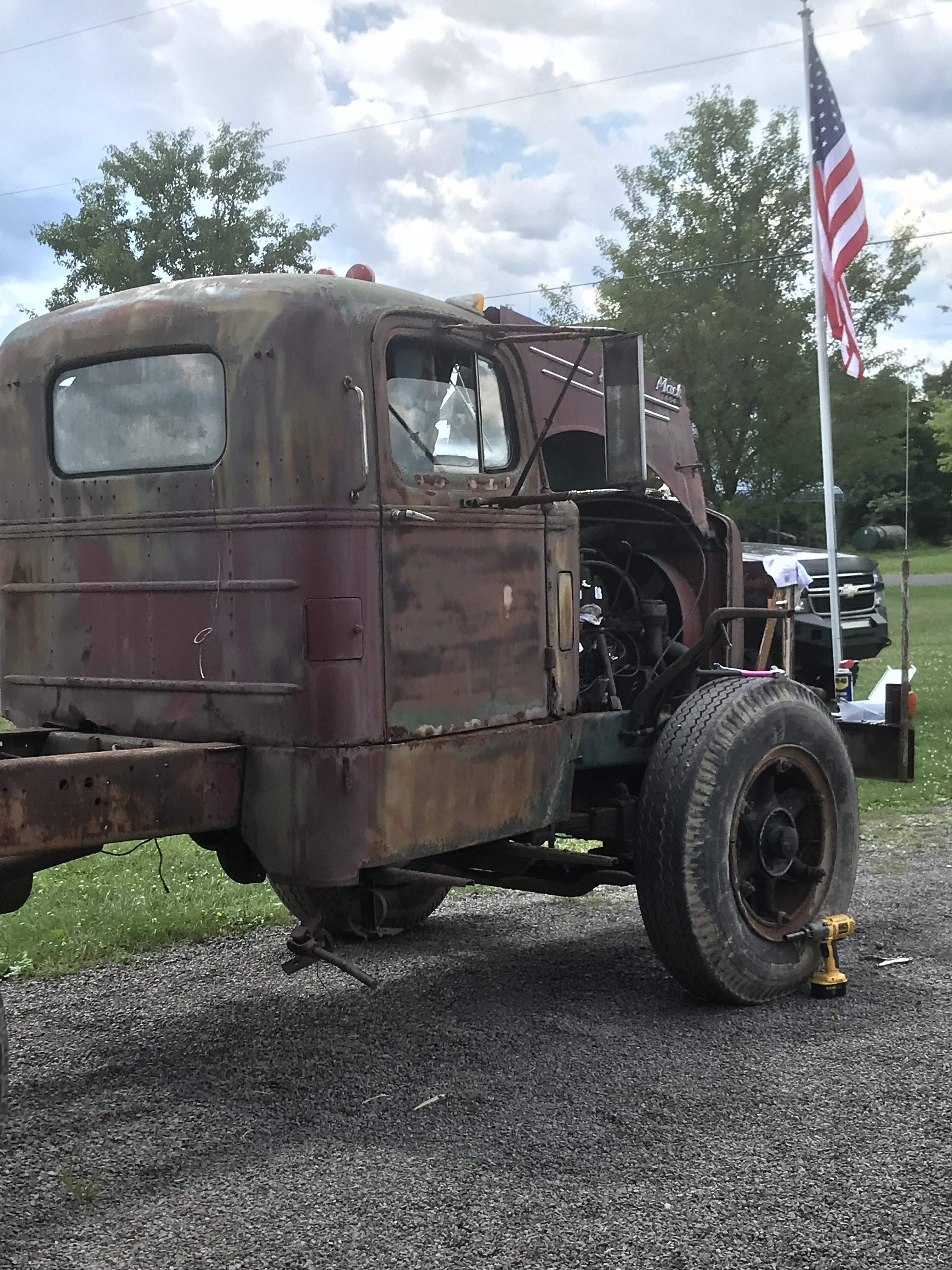

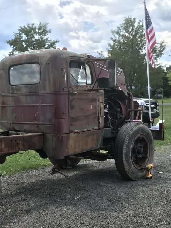

  20. I adopted an 1952 A-54 last weekend, and got it running and driving today.
