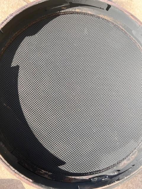

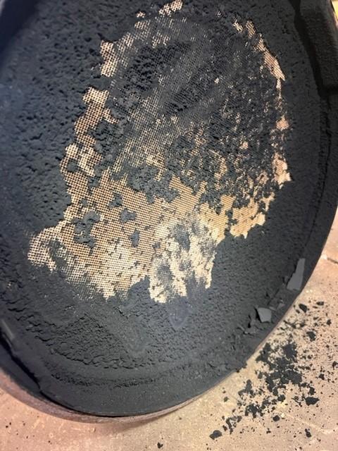

So with the DPF/DOC off there is little to no smoke unless you snap the throttle hard. we hit the regen button and then it starts pouring the smoke out. so whatever is causing it, it only happens when the truck is trying to regen. we unhooked the DRV put it in regen and it starting pouring smoke out. we plugged off the 7th injector fuel line and same thing, pouring smoke out.
what are the things that create a lot of soot? soot is unburnt or incompletely burnt fuel correct? it just seems to me like there is more soot in there than there should be. it seems like this didn't happen until i put new injectors in it. But how do i prove that it is the new injectors over fueling. they would have to be bench tested . the truck does have 549, 082 miles and 25,015 hrs. on it. i wish i could just have the dealer look at it but the boss wouldn't like that idea. ($$$)
Yes, it is a Roll-off truck. the first couple regens had normal temps(1100 or so) and completed in about 25 minutes. the last regen it was blowing out so much black smoke right away, I cancelled it. i just don't see a new filter needing to regen every day. should go awhile (days) before needing a regen, right? We had thought of the driver being the issue because the switch has the regen button that you can disable it. but another driver was in it yesterday and he wouldn't even know to disable it. each day it was only in stage one. i did find it odd that it said only like 130% and the thing was completely plugged. maybe the differential pressure sensor not working. not telling the truck to regen when it needs to? there are no codes for it but maybe it failed in range? We just have to figure it out or i will be cremated for wrecking another $1500 DPF. Thanks for the reply

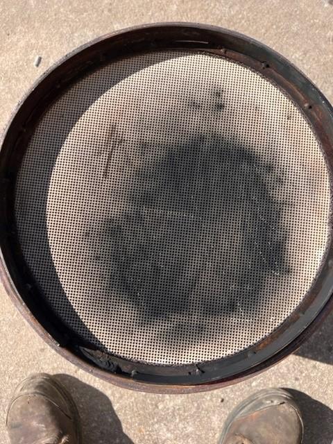

I have a 2009 MACK GU813 (US07)MP7. truck goes through injectors about every year or 2. This time, the truck had no power and running rough, same as in the past when it needed injectors. we put injectors and cups in it. reset the engine learned data. it ran 1 day and had a regen problem. Blowing black smoke out the exhaust. took the DPF and DOC off and sent them in for cleaning. DPF was cracked. installed new DPF and cleaned DOC. truck ran 3 rays needing a regen everyday. now blowing black smoke out again, but only when i put it in regen. DPF and DOC have a ton of soot on them. assuming the DPF is cracked again. several other techs in our company think its an over fueling problem. But if that were the case, wouldn't the fuel be heating up the DOC and burning everything off? like regening all the time. We can't figure out where all the soot is coming from. Injectors are the right part numbers. Truck runs great and has lots of power when not doing a regen. put it into regen and it almost seems like it is missing or running rougher than normal. with the DPF off we start it and see some black smoke out the exhaust, but not a ton. I did a cylinder balance test and it look pretty even across the 6 cylinders. there was 1 code for injector #6 mechanical system not responding after i put the new ones in. cleared it and it hasn't come back after a few days. My boss wants us to pull injectors out to see if we see anything wrong. I've seen posts about black smoke and people have said turbo or EGR. Any help would be appreciated. we are lost.
