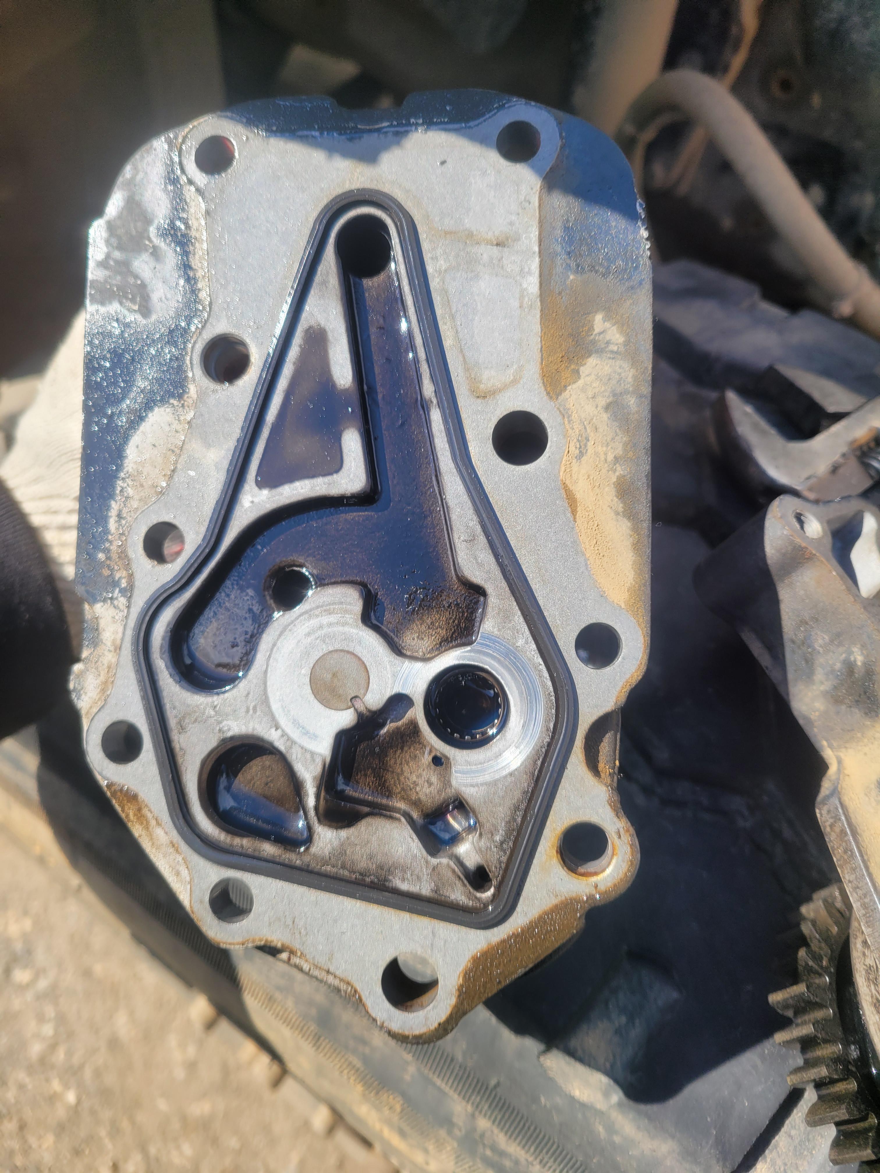

  13. I'm a bit confused now, I forgot to tell you guys that yesterday when I got the pump at the dealer one of the mechanics told me why I was charging the pump I told hin because it was leaking fuel, and he told that those are almost impossible to leak what guys think about it?

  20. No unfortunately I couldn't take a picture or video but it's was dripping and when it run out of fuel it started spraying fuel vapor
  21. Yeah now is like 670 with the core, but ended up spending just over 1k for the pump oil filters and oil, but at least I now can relax a bit this is so stressful lol, I want to thank you guys for the help now I will put the new pump oil and get back to you guys for an update, thanks. Once again guys
  22. I just did the pressure test on the suply pump and yes is leaking fuel from the shaft
  23. Or it could be the galley plug?
  24. Guys I took the suply pump off it looks like the oil has been wash off, do you guys think that's what is wrong
