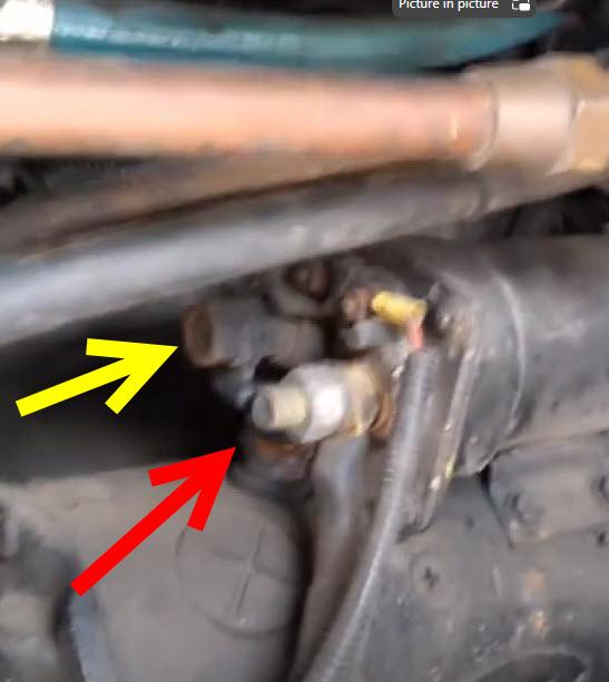

Ok Guy's, thank you for all the ideas and info. Problem solved, at least for now. This AM, 17 degrees out, I removed the strap between the left solenoid post and the starter post. Found the nut on the starter post to be a bit loose as in not tight enough. that was a good sign! Once I had the strap off I found the arcing/pitting on the underside of the strap where it goes onto the starter body post. Another good sign. Tested the solenoid and constantly got power to the left post when turning the key. Good sign. Jumped the starter between right post and start post. Starter spun good. Cleaned everything up and after several trips inside to thaw out I got it all back together. Cranks right up and engaged and cranked strong. NOW, I have to replace two little plastic pieces and springs in the fuel supply pump and we'll see if it will start.
Thanks, I am hoping that the solenoid shows as grounding from the post with he yellow and I can take the rear plate off. My friend said he uses a swivel on the engine side and it is turn a tiny bit, remove and reset and do it again. He's had it out a few times. At firs we would get a "click" when trying to start, like the solenoid engaging but not turning the starter. A little rapping on the start and it would go. the last few times though we got that arcing and I didn't see anything obvious on the outside so we gave up for the day. Going to be a cold on today so don't know how much we'll get done.
Need to get the starter (40MT starter) out on this Mack and my friend says that last time is was a major undertaking. Said the bold on the engine side was extremely hard to get on. Reason to take it out is I think we have a bad solenoid. We get an arc at the back of the solenoid when turning the key. The arcing is in the area of the red arrow. I tested for continuity to ground at the terminal by the red arrow that goes into the starter and got it, and also tested at the yellow arrow and the same which I expected since they are connected. I will remove the strap between those two terminals tomorrow to see if continuity is at the terminal on the start or on the solenoid. It seems I need to remove the starter to remove the whole solenoid. I am wondering if the plate on the rear of the solenoid that has the terminals can be removed without part flying everywhere! Thanks for any suggestion, tips or advice.
