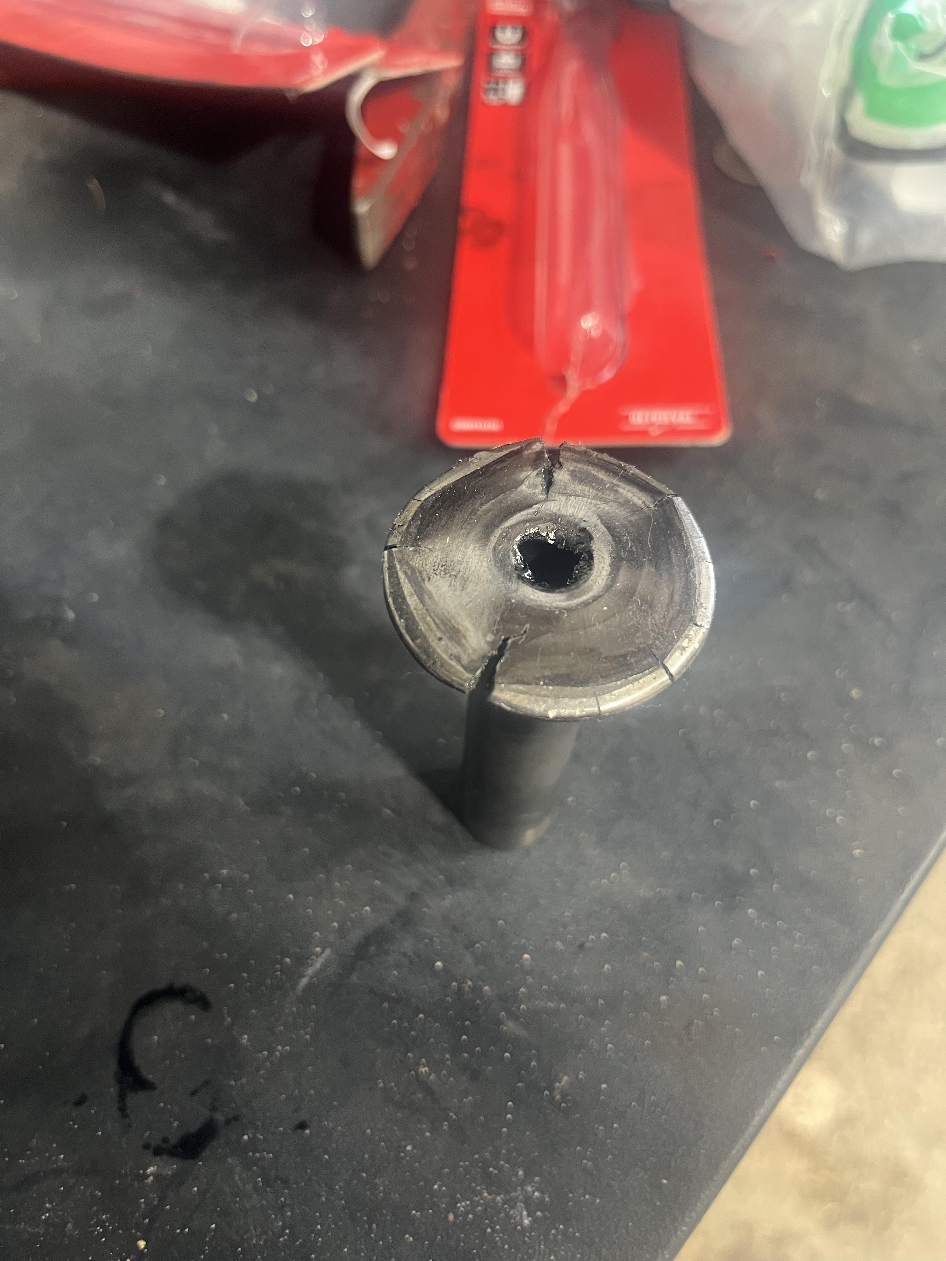

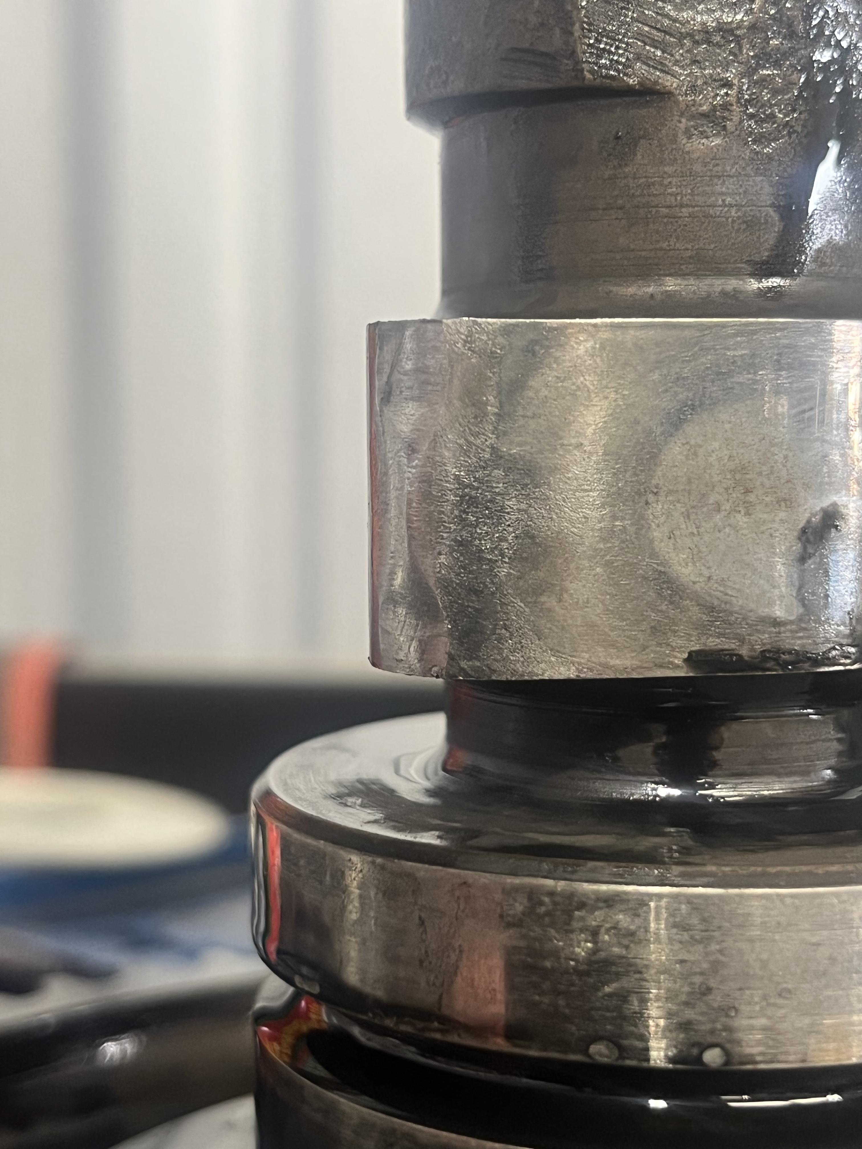

  1. Ok update, cam was repaired by local machine shop, they also re did all 11 good lifters but are unable to find a new lifter for the damaged lifter, does anyone have a lifter for a endt 676 that they would sell me, i can’t seem to find one anywhere?
  2. Update, finally had time to work on it today, intake lifter for #1 is bad, my machine shop said the cam might be savable. We we’ll see I guess, if not he said he can cut me a new one. He also said he can build me a new lifter as well. All 11 others look fine.
  3. Thanks for all the information, I will be attempting to pull cam Monday, we’ll see how it goes
  4. up-date. put injectors in and re ran overhead, truck was running good for about 2 months, driver pulled in the yard and sound had come back. Cylinder 1 exhaust rocker, the lash was way loose, bore scoped the lifter and the lifter is cracked and mushroomed, working on pulling cam and lifters for further inspection. my question is can I use a puller and pull the injection pump gear off and mark the gears so I don have the re time the injection pump? or do I have to take a part the adjustment for the for the injection pump? I know the lifters will have to be held up with magnets to pull the cam, is there any thing else holding the cam in?

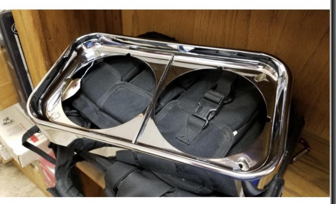

  10. I have a 78 superliner looking for the round style head light bezel, watts trucks center stopped selling them, any leads would be great, I’ve been searching for months now and can’t find anything, I just need 1, it’s the last piece to complete my superliner build
  11. I have a 79 superliner looking for the round style head light bezels, see attached photo, watts trucks center stopped selling them, any leads would be great
