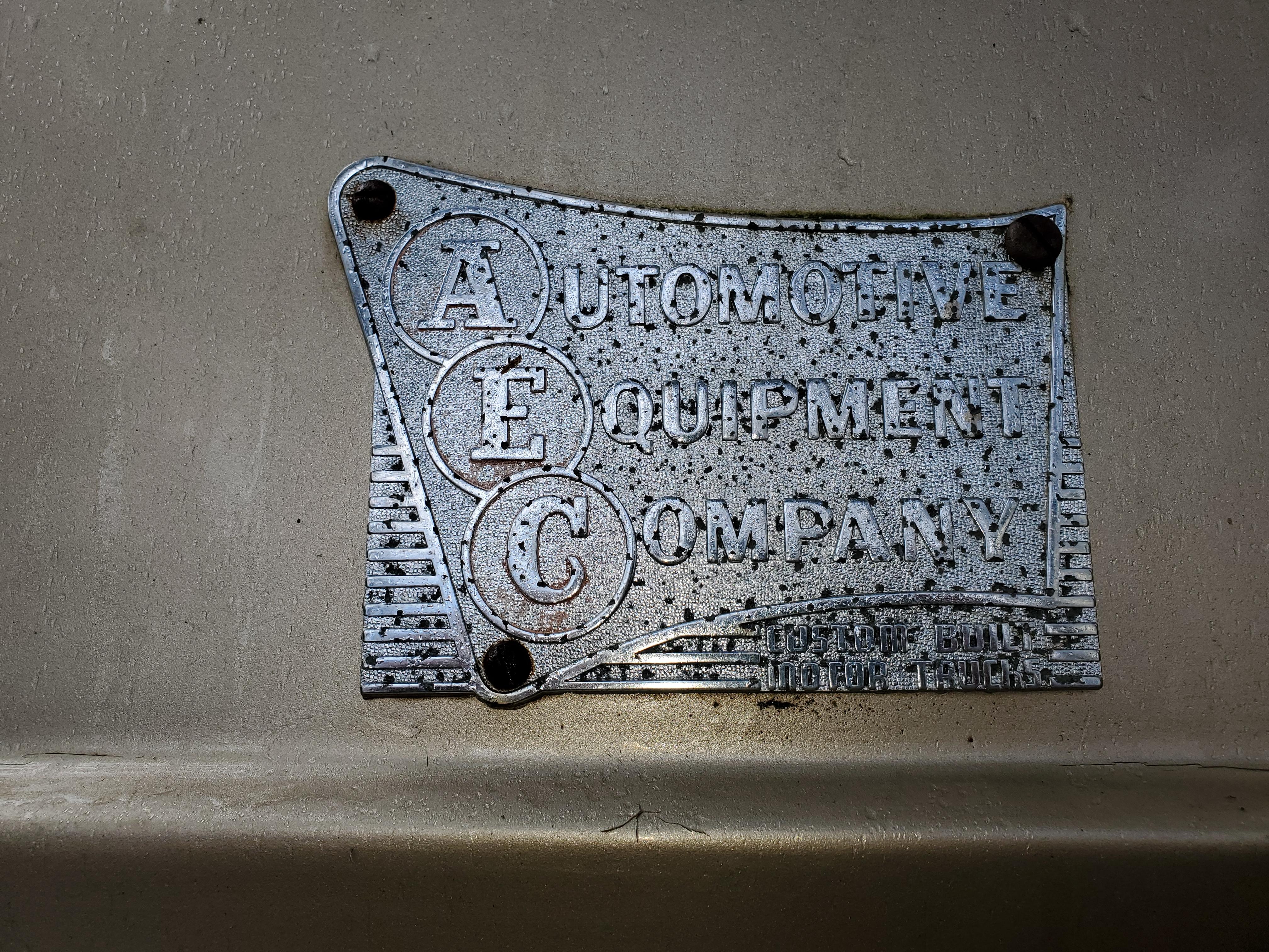

  10. Anybody know anything about this emblem? I did a quick look online and could really find anything. AEC-automotive equipment company- custom built motor trucks. This is on my '71 RL700L dumptruck.

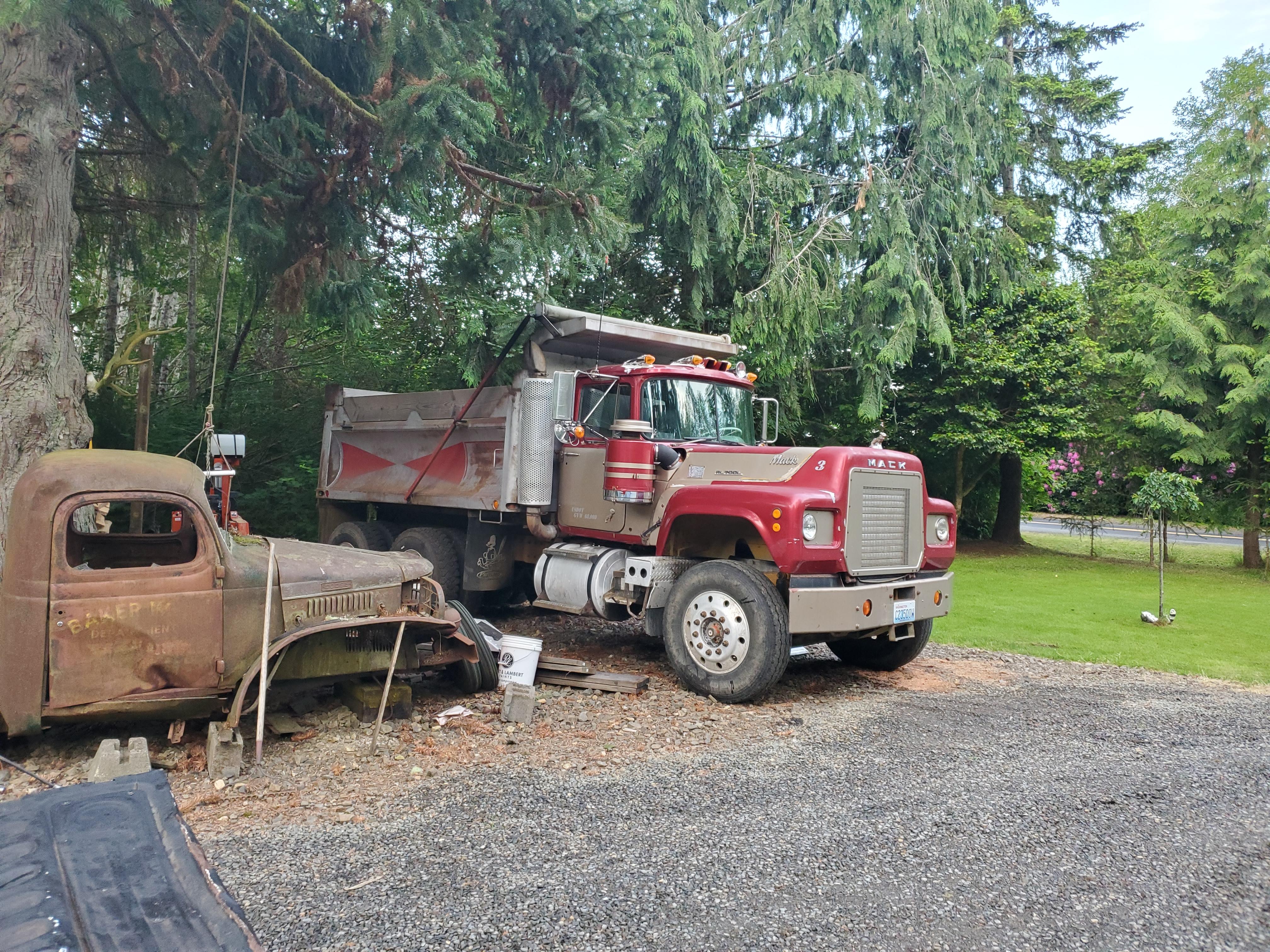

  11. Hey everyone, I kind of skipped this part when I joined last week. I am the proud owner of a '71 RL700L dump truck. It has been a great truck for having 1,000,000+ miles and being over 50 years old. Twin stick with a v8, don't know any more than that about the motor and trans. I live on the sw washington coast, which is great for the truck. So I'll be around, probably asking some dumb questions.
