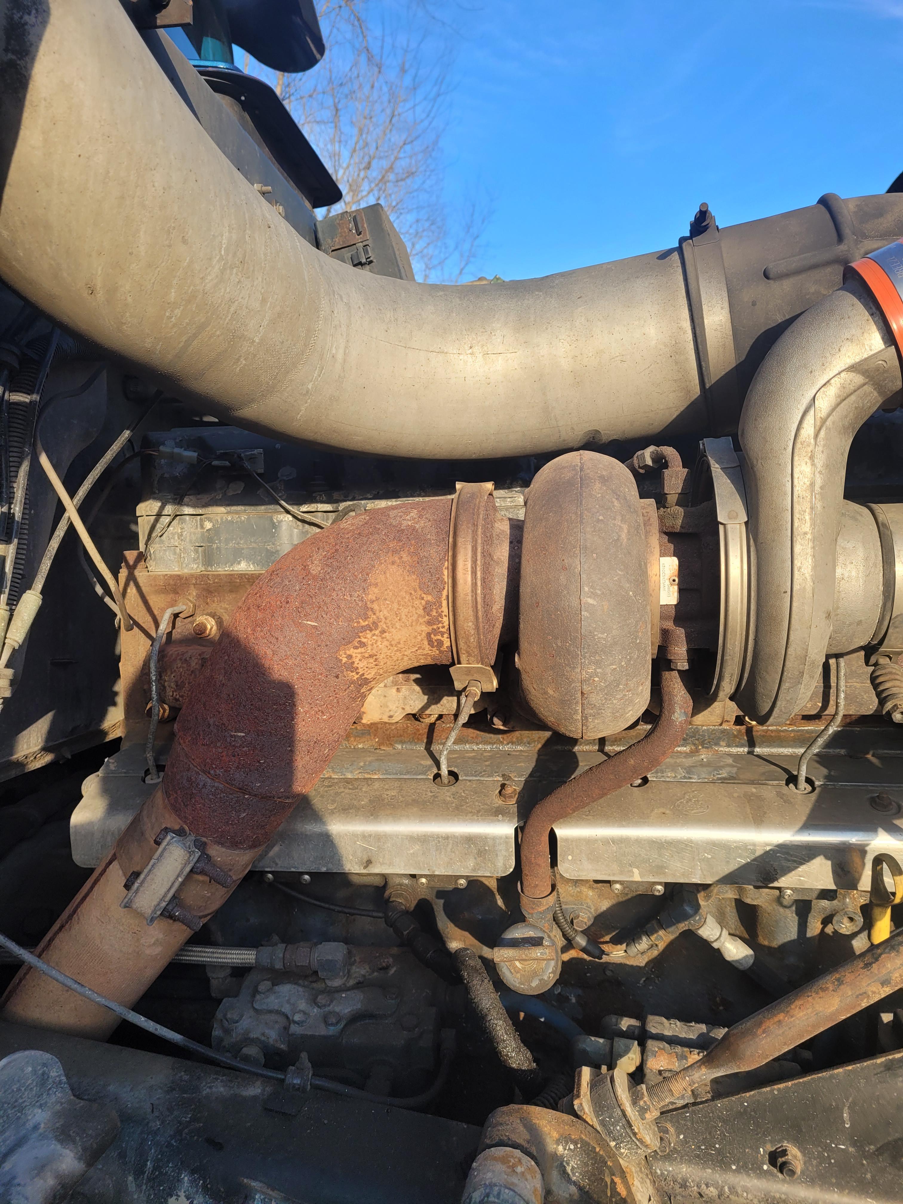

  2. So i started to look over the truck. I realized that I had a ripped boot off of turbo and boost gauge was disconnected. I replaced the boot and plugged up the gauge. It honestly feels slower now 🤣. Either way it raised a few questions. First I realized it wouldn't make much past 25lbs of boost. I heard they should be making more like 35. Is it because it's empty? I saw 30lbs once and that was after hitting a bump in the road. You could feel it pull harder but it began to back off to like 28lbs. Now I haven't serviced this truck since I brought. Is it possible that air and fuel filters are that bad that it's holding back on 10lbs off boost? What are yall thoughts?

  7. So I brought a 2000 rd 688s. It's a mut. Mack 460. Mack 18spd. Hendrickson suspension and meritor rears. I must say. It runs amazing but being a 4th or 5th owner truck I don't know much about it. I haven't had it loaded yet but seems to have plenty power. First it rolls some coal. Is it possible it has xt program? It has a borgwarner s400 ; is that stock? Some help figuring out more about this truck. It's factory built the way It's is. I ran vin.

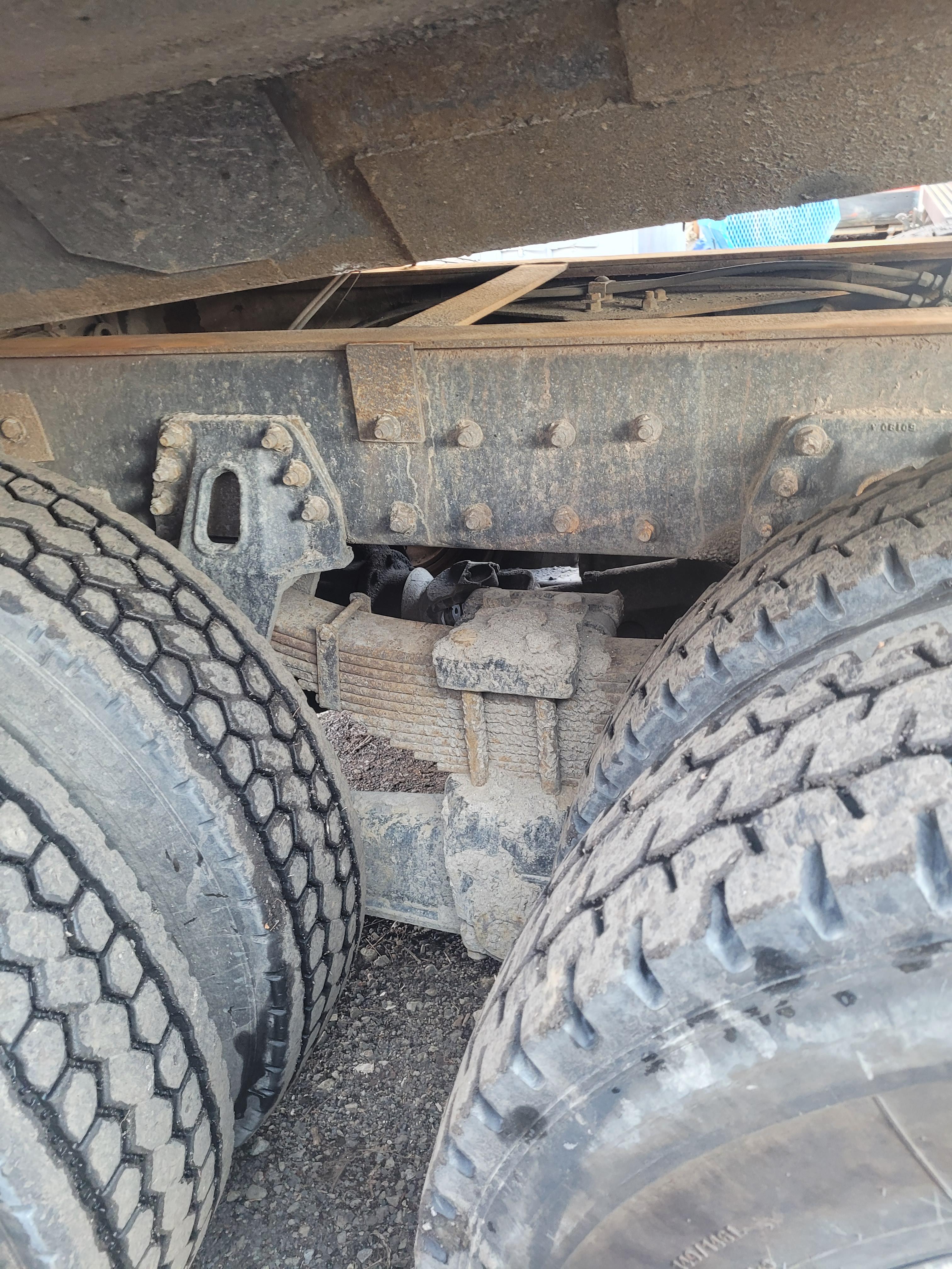

  9. So.. I have a 97 rd688s. E7 400 with 12sp. Triaxle. At this point it has 2 new rears but aluminum dump is shot. Motor has 543xxx on it and front head gasket is leaking bad. Frame rails are stuffed and waffled bad but. She does as a mack does... she still runs well. Does some leaking from gasket other than that. No complaints. Issue is.... the reality is needs motor and refurbished dump body on top of frame rails. Is it worth re railing or move on. 12spd was redone in 16. I really love the truck especially with the 4.17 rears but truck is at the point we're it's time to really invest in it or move on. What's yall thoughts
