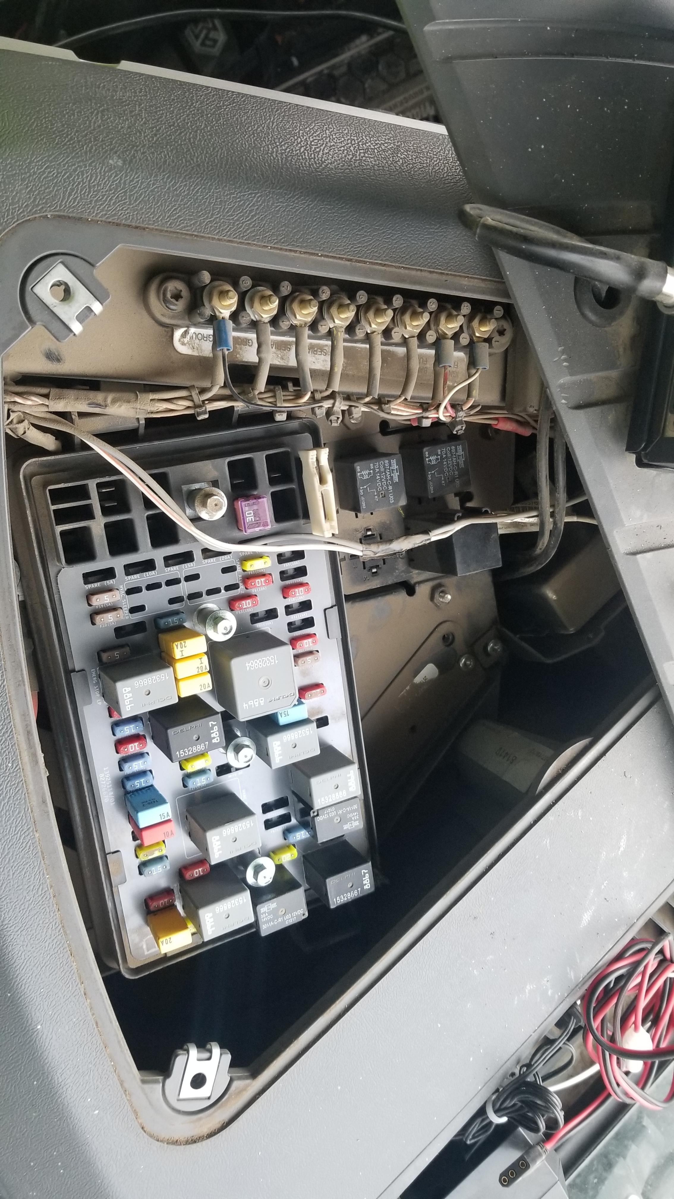

  5. need a lil help 13 cxu 613 code spn 251 fmi 12.....can somebody help me on this code ...real time clock battery is what it says on google and dont know how to find it or check it .....it all started when i blew a fuse for my cb ...tried to find fuse for the red and black lugs ..ran wire and cant find fuse for that either ...started check all fuses in fuse box on top of dash ....seen alot of blown fuses and replaced them .....then it all happened ...check engine lite came on and spit this code out ....so i need help on both ....thank you for your time and knowledge on this issue

  10. Joey mack Is this for the top fuse block that's on top of dash or the block down by your left foot Thanks
  11. I have a 2013 cxu 613 . Need help locating the the fuse in the fuse block on top of dash . I dont have a map of telling me what fuse does what . Blower stopped working today and that's the first thing I'm checking .any help would he greatly appreciated thanks for your time
