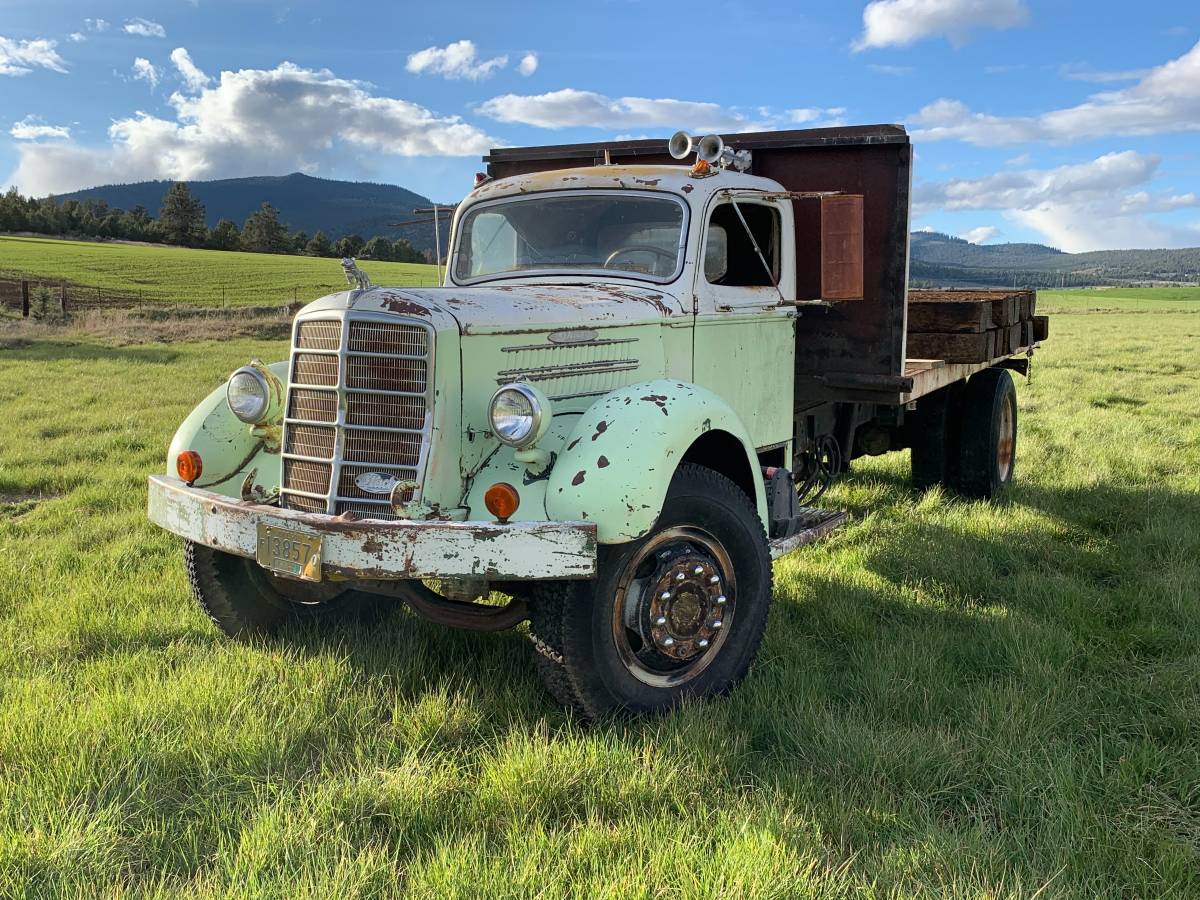

  1. Runs and drives good price IMO $3500 Not Mine https://portland.craigslist.org/grg/cto/d/klamath-falls-1950-mack-eh-obo/7231204451.html

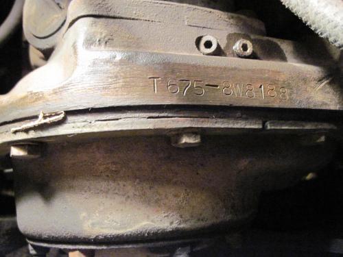

  3. The #'s that you want have been stamped ahead of the fuel pump on the top flat deck of the timing case. Tip Turbine first offered in 1972 or 1973. For example this serial number translates to a ENDT675. Early 1970's mack dropped the ENDT and such. TB indicated a 675 with Dynatard. Find your number and we can i.d. it. If you can not find it on the timing case the look at the rear behind the head area on the slim chance it was originally in a COE

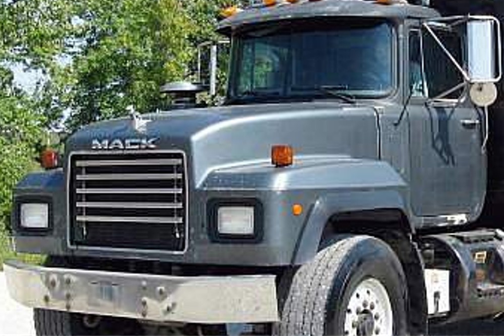

  20. Thats the last generation with the soft curved hood and square lights. 1990 and newer.
