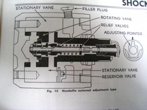

They are a vane type rotary shock. They require special tools and a fixture so you do not damage the housing, shaft or shoot the high tension spring through any body. The biggest problems are they were originally filled with either Glycerin or Mineral oil. both jell after years. Remove fill plug and drain what you can, light heating will allow the oils to flow some. Fill with Hydraulic Jack oil work the lever back and forth and drain the oil. Do that a few times and refill with the filler plug in the same position as when it is mounted. Fill to bottom of hole NOT ABOVE IT. THe Rotary unit needs that air space for expansion. Over fill it and the seals will blow and it will leak oil badly. Regular oils (Engine and Fork oils) react with the Glycerin and Mineral oils and wlll actually curdle them like FETA Cheese. The shocks are than basicly destroyed. Paul

Internally on the Delco-Lovejoy they only go together one way or not at all. The arm is incorrect. Some are on with a pinch bolt, some are splined with a nut and can be reindexed and some are welded. The welded ones you can carefully grind the weld, reindex and reweld. The other option is to center the arm and lengthen the shock link. On the Macks they only move about 25mm (1 inch) each way never full travel. Looked through my Shock and Shock Link Catalogs sheets. Your MACK used Hydraulic Houdaille Lever Shocks in the time period. These are the same less the shock link. Click pic

Similar to them along with the DuBonnet and British Armstrong lever shocks. The Delco-Lovejoys use an different less "strong spring" and use a simpler valve system. Once you clean and make them functional and follow the maintenance schedule (3500 miles) you will have not problems. The Delco-Lovejoys on my 1941 Chevy are 74 years old. A flush and new wipe seals and the are like new for another 70 years. The difference that nobody sees between tube and lever shocks was two fold. 1) The cost to make Lever Action Shocks was triple with the castings and machine work, than the cost to make Tube shocks. Auto makers increase their profit margin with cheaper to make part. 2) Preform the maintenance on lever shocks they last for ever but people and mechanics rarely or never did. Tubes are a money maker, they wear out and need to be replaces often. Make money for the shock maker, mechanic and parts store/dealer.
