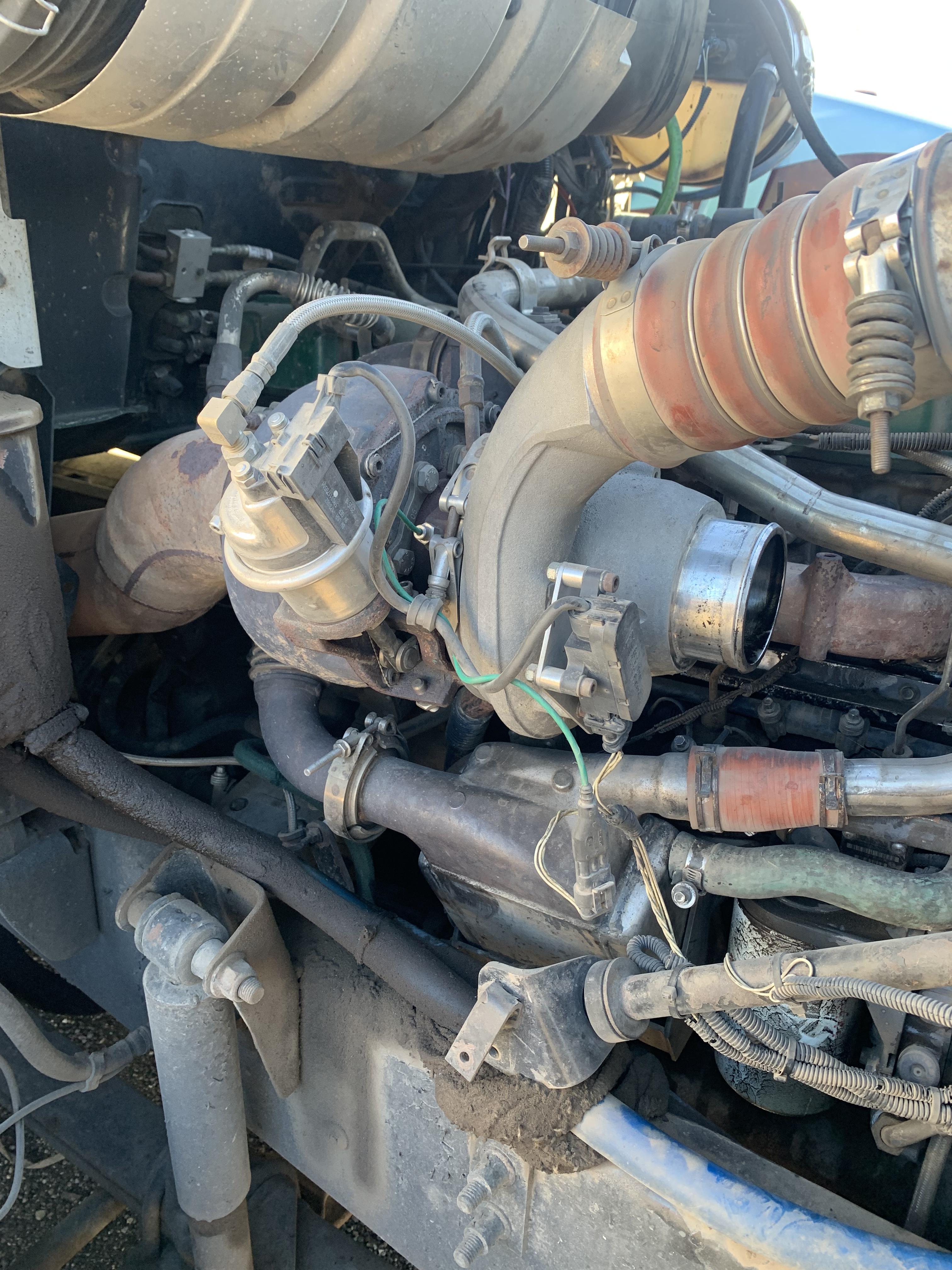

  3. I have found a fairly used whole Turbo for my ASET-C. When I replace my current turbo; should I replace the oil feed lines as well? Could the oil feed lines be clogged up with carbon and/or soot that could have caused my turbo to also fry up?? (Keep in mind I STILL have low Oil Pressure to the Engine!!) Or can I keep the oil feed lines and clean them out? Also, when I replace the current turbo does the new ‘fairly used’ turbo need to be recalibrated to the ASET-C?? I am also keeping in mind to inspect the charge air cooler and clean out any metals or clutterness. Anything else I should look out for?
  4. @Joey Mack yes there is a little oil in there as well as In that gasket tube that connects to the turbo has some leak in that tube I noticed. I’m sorry what does C.A.C. Mean?? If it is leaking what would be the next step? I’m wondering if something fell in or around the air filter and the turbo blades are up whatever it could have been.

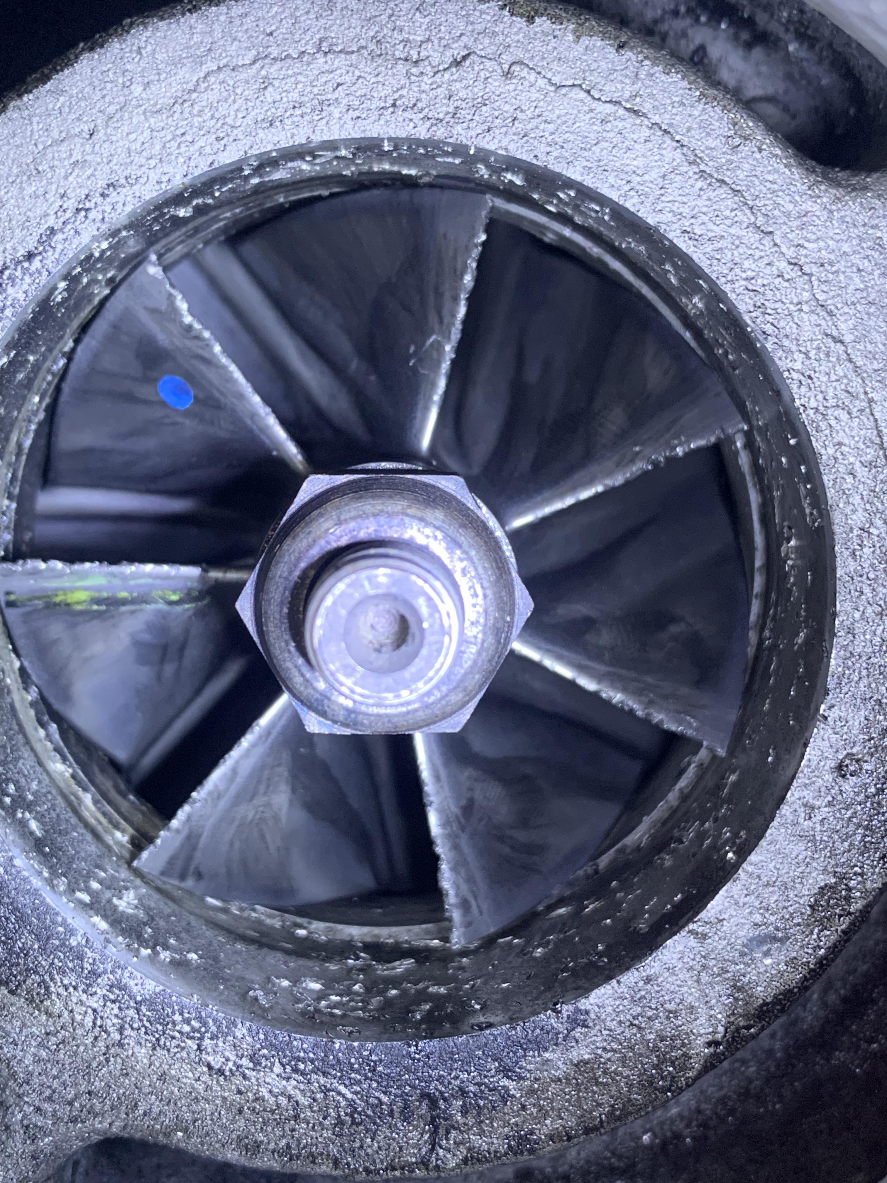

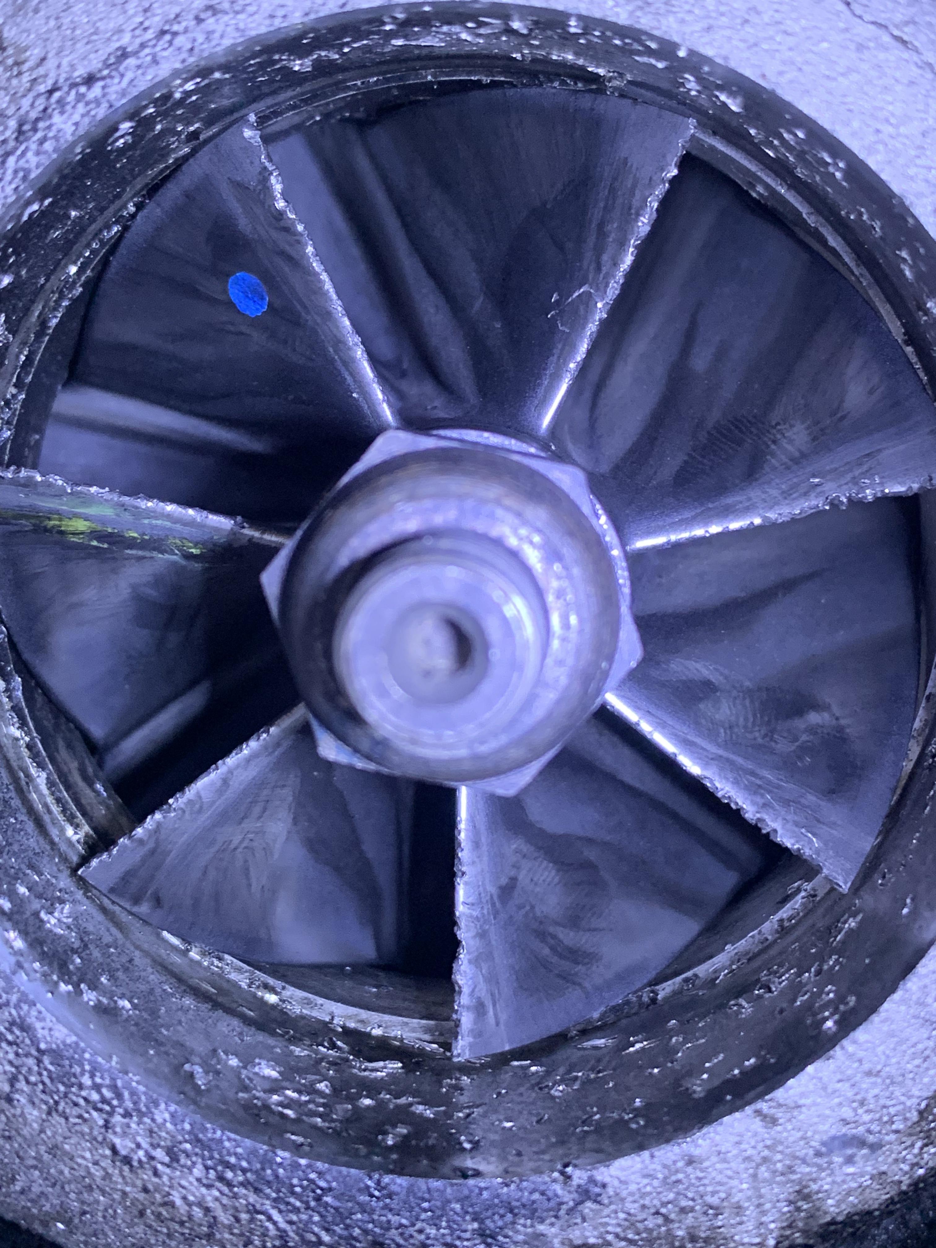

  5. Engine Mack 2007 ASET-C 380/410 Combustion air temperature 2-8 flash code combustion air humidity 2-9 flash code Those are the new codes I’ve been getting; hearing this scream as I’m accelerating louder than the turbo. I need help troubleshooting. Also, How do the Turbo blades look to you guys??

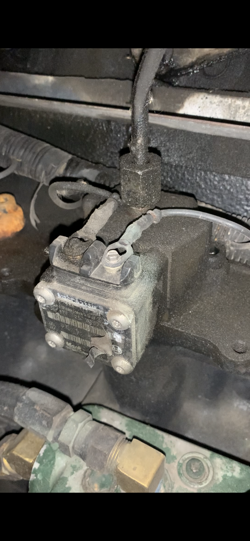

  14. #5 EUP. This is what “wet” or “leaky” is what I was talking about on that
  15. Hello all, I am having a new issue now. I will start off by saying that 2 days ago I was in a hurry getting out of the truck I parked and turned the engine off while still in (remember automatic) Drive. 2 days later I am having issues with my tranny, codes displaying 72 & 51 along with the red blink service specifically on the transmission shift box in the cab. I am also having a lightning flash bolt code of 7-3 (speed control switch) and 8-5 (#5 EUP) EUP#5 when I do my pre trip I do notice is the only one that looks “wet” or “leaky” all the other EUP’s are dry. I’ve replaced all 6 EUPS when I did the overhaul to this truck back in September so I’m not sure why EUP#5 looks leaky and is showing up for code??? any help will be liked and greatly appreciate, thanks 😌
