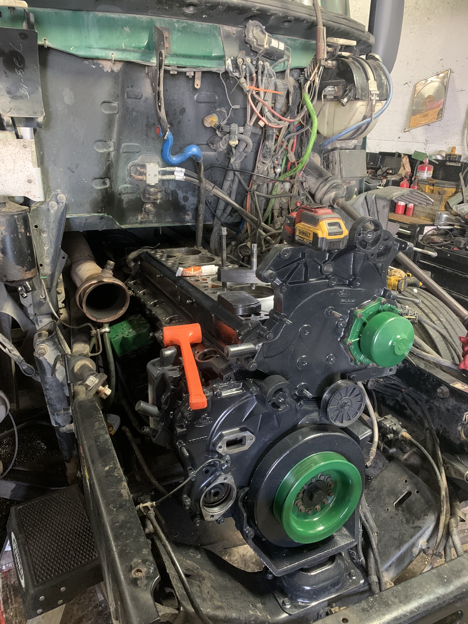

Engine Repainting
Shortdawg67 replied to skydawg's topic in Antique and Classic Mack Trucks General Discussion
