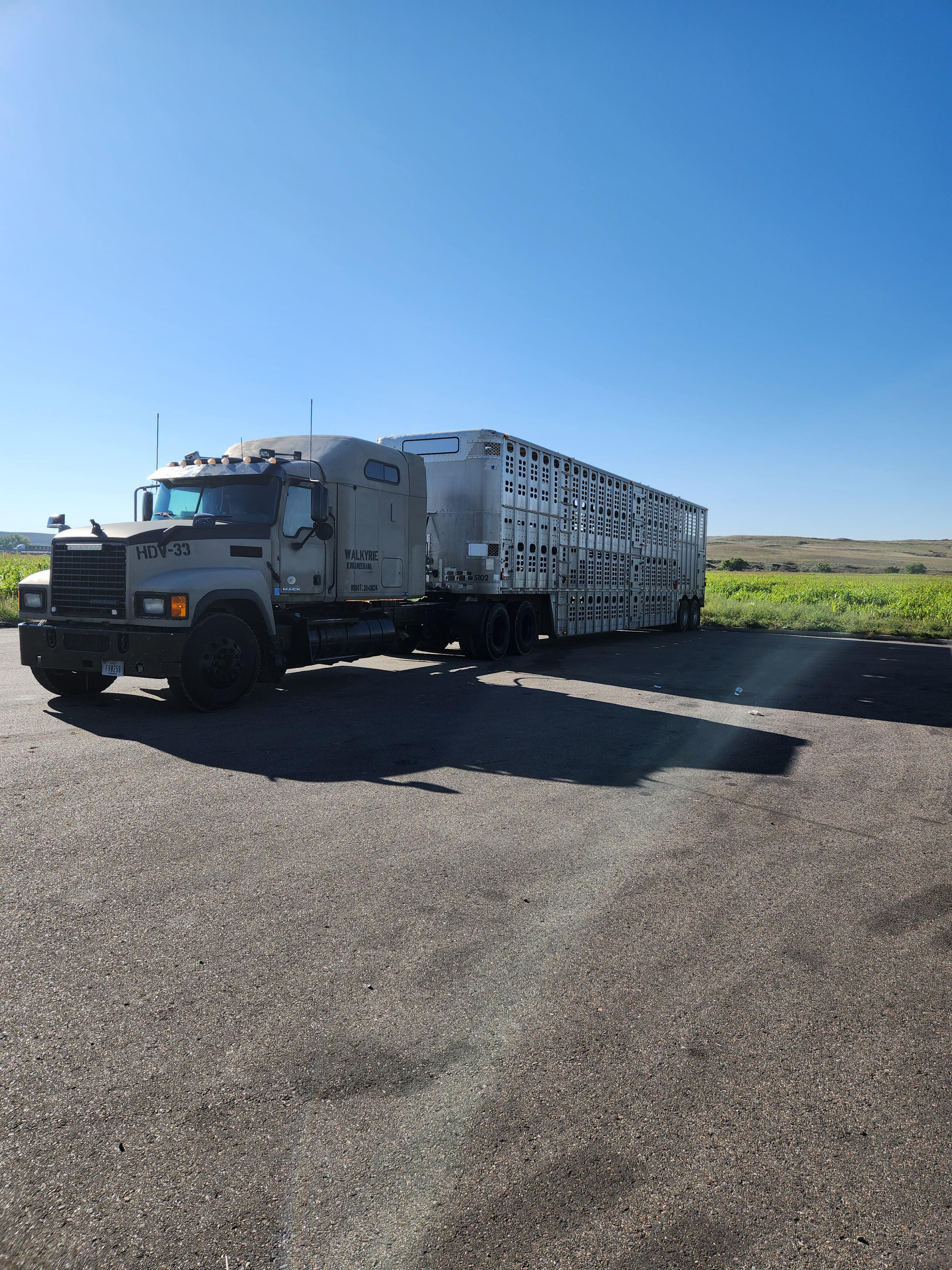

  • My Truck
    2013 CHU-613 MP8-505 325"WB
