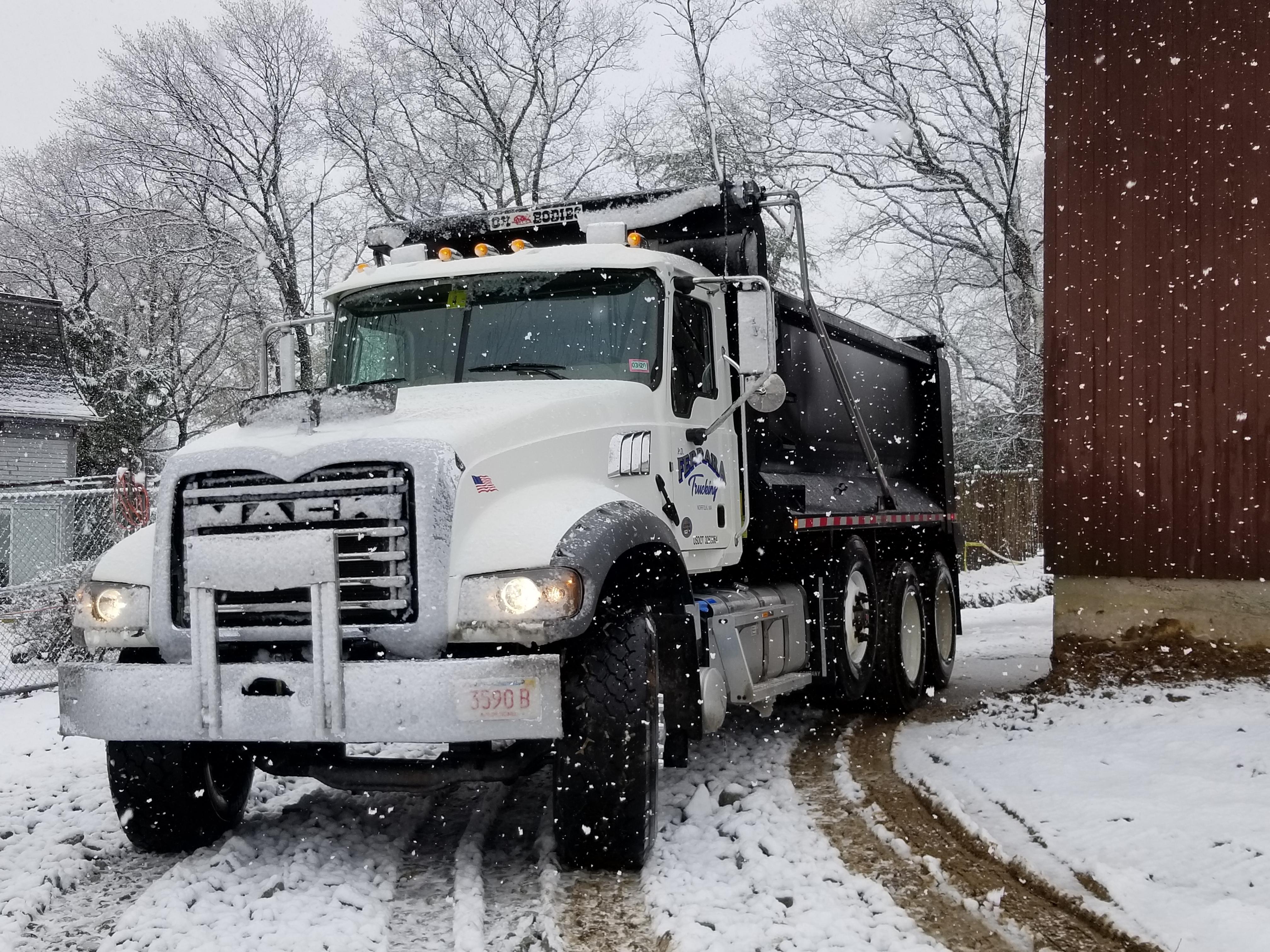

  4. Hello, I am reaching out again for some help. I appreciate the responses I have got in the past. I have a 2018 Granite with the MP-8 engine. I am getting fault code SPN-1639 for the Fan Speed. The fan does lock up after the engine gets up to temperature, before it is at full temperature the fan works fine. What sensor is controlling the fan speed and where is it located? Any help will be appreciated!
