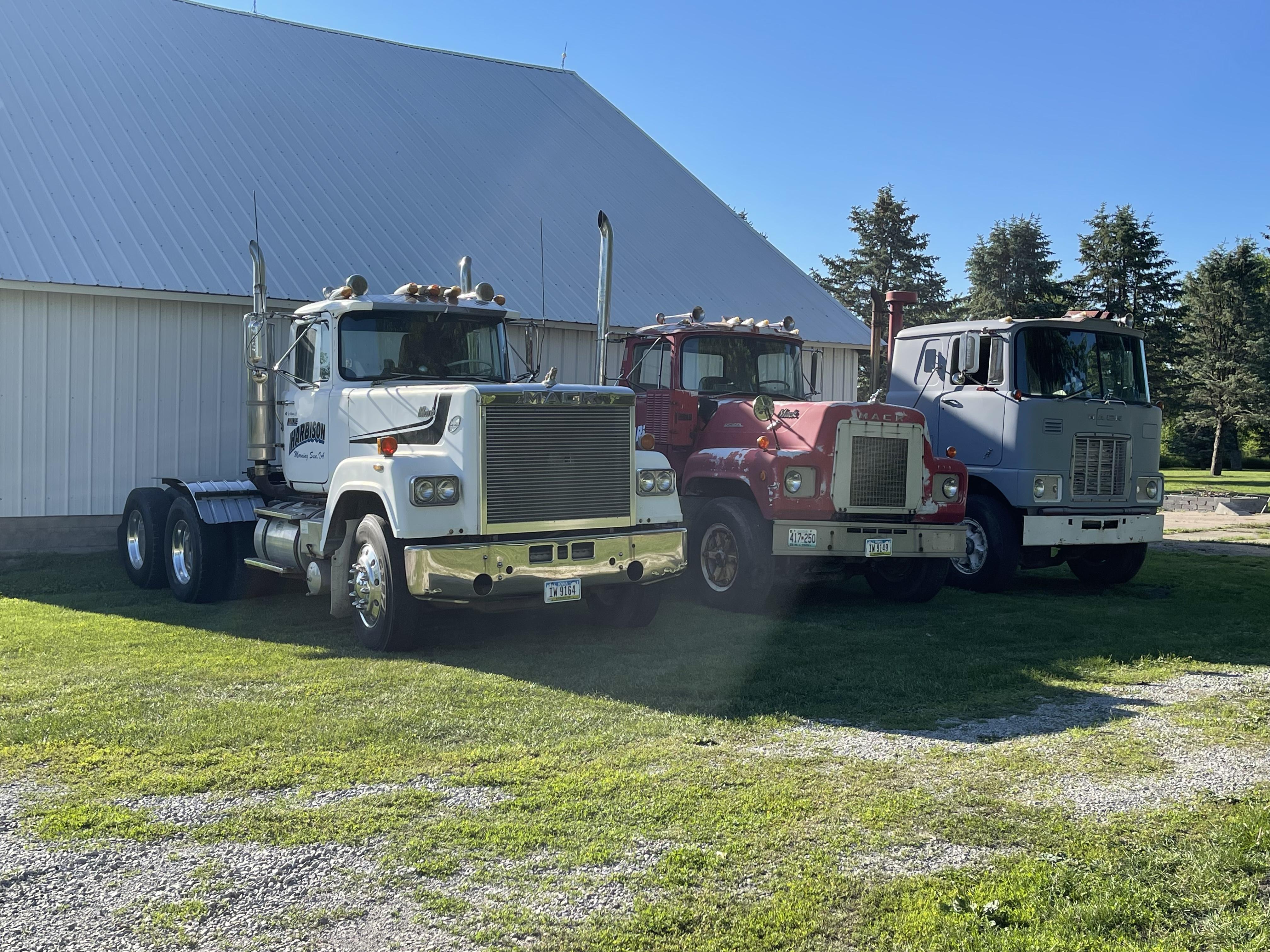

24

  14. Just joined the forum and was pleased to come across this thread. It’s amazing how many people knew Mike. He was truly one of a kind and is greatly missed. Before he passed, we spent a lot of time talking about his trucks and he was determined that both of my sons and myself would each get one of his trucks to work on and take to shows. Somehow he convinced my wife that she should consider herself blessed to have Mack’s in her yard. Now we are the proud caretakers for a 1970 F Model, a 1975 R Model, and a 1979 Superliner. Each of these trucks were featured in his daily Facebook posts. Slowly but surely these trucks will be restored how Mike wanted them.
