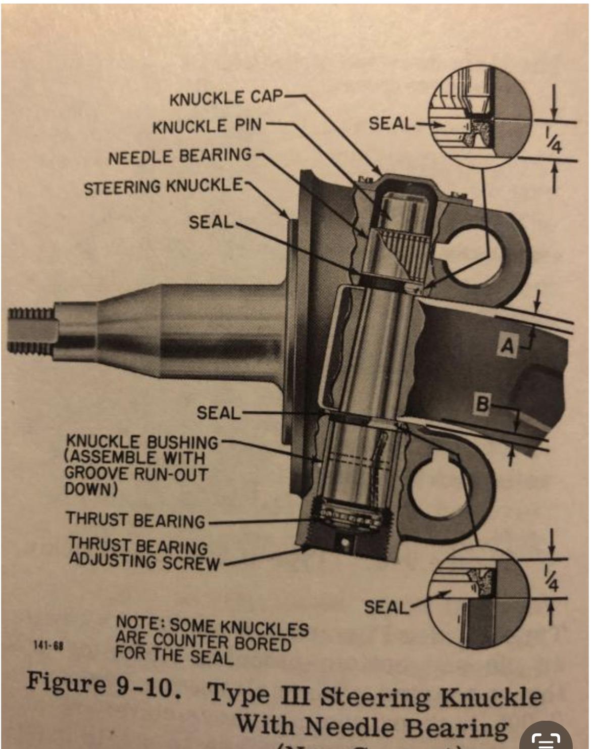

  14. Anyone know the Mack part number for the kingpin kit for the Type III steering knuckle. It has the needle bearing on the top of the kingpin. I assume for the FA505 front axle. When did Mack switch from a bushing to an upper needle bearing on this kingpin? What application of axle was this used on I know the B used it but did the R model. What vintage of axle?
  15. I have the Type III steering knuckle without needle bearing.
  16. My kingpin is in tough shape, it needs replaced, so no buffing it

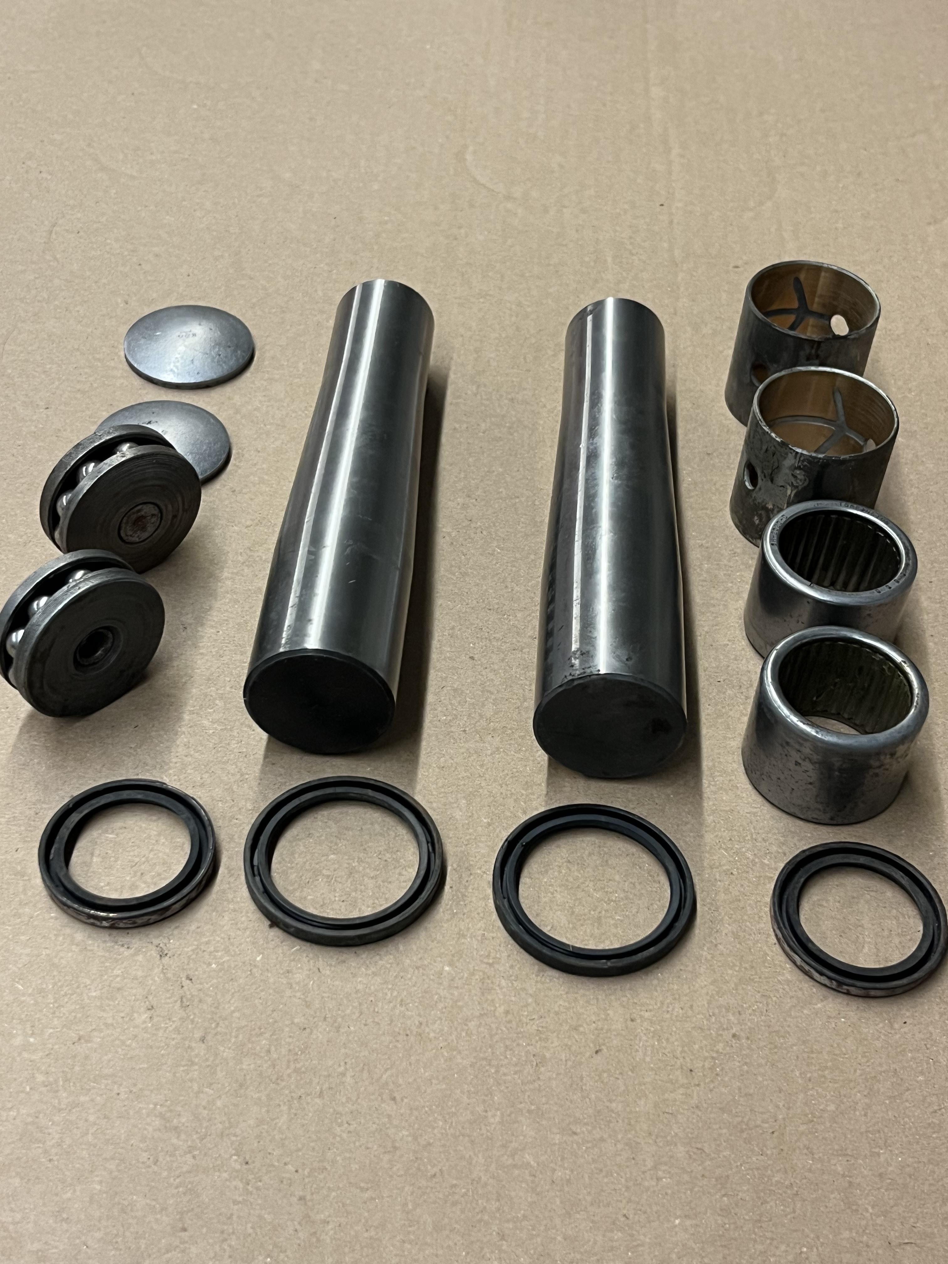

  17. Anyone rebuilt a windshield wiper control switch on a B-model. I assume there’s rubber o-rings internally
