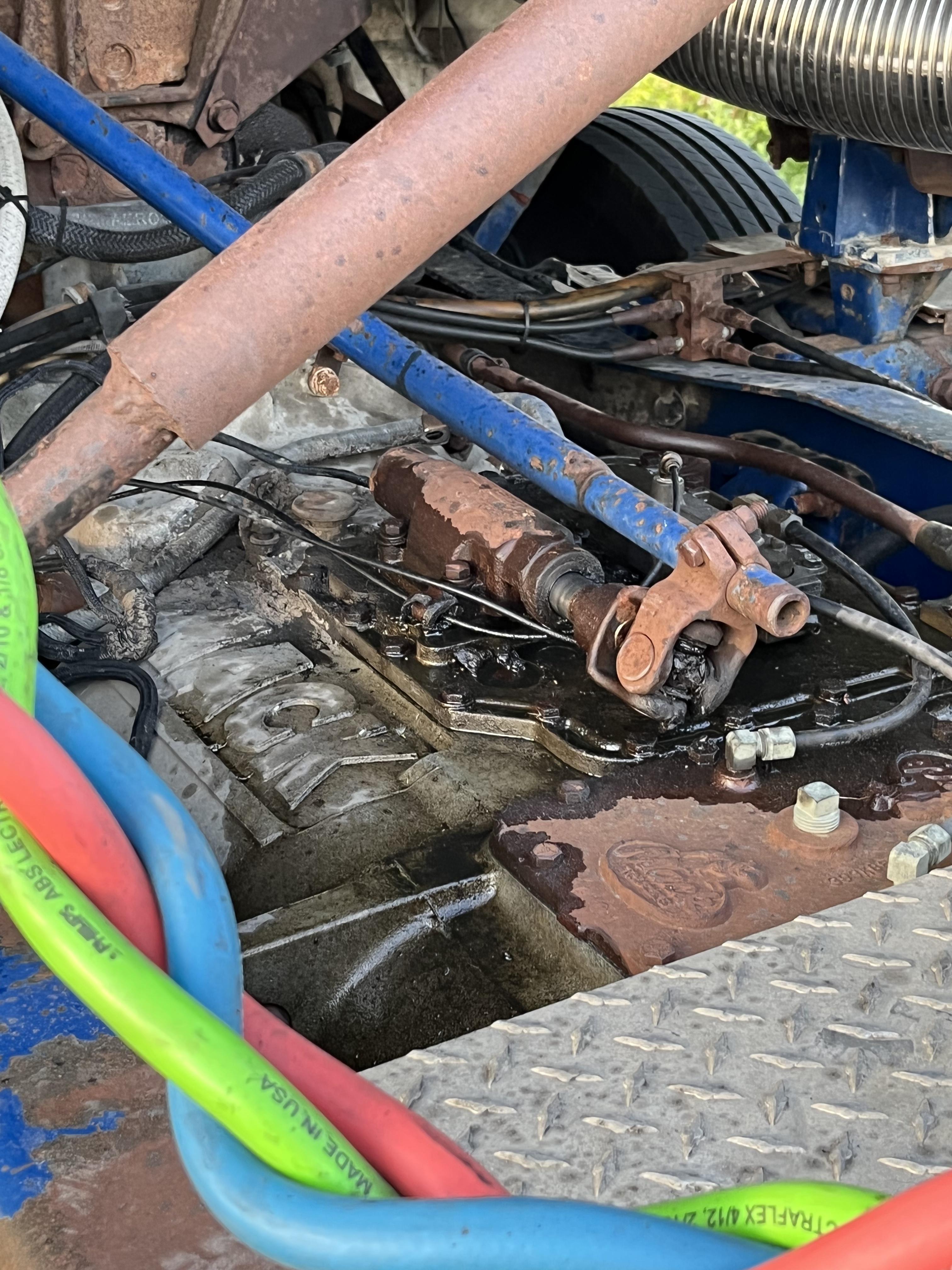

  13. Been driving this MH 613 E6 350 a couple weeks now and maybe I didn’t notice at first but lately after it warms up, or when it idles a while after driving, or after correcting itself then the air dryer purging causes engine to start a kind of rise/cycling down up sound that shows a slight drop in oil pressure than directly back up. fuel pump governor? Or maybe air dryer related? anybody encounter this or have any thoughts? They’d be appreciated. Y’all dudes been behind these Mack’s so long you’re a great resource for narrowing things down rather than a random shop
