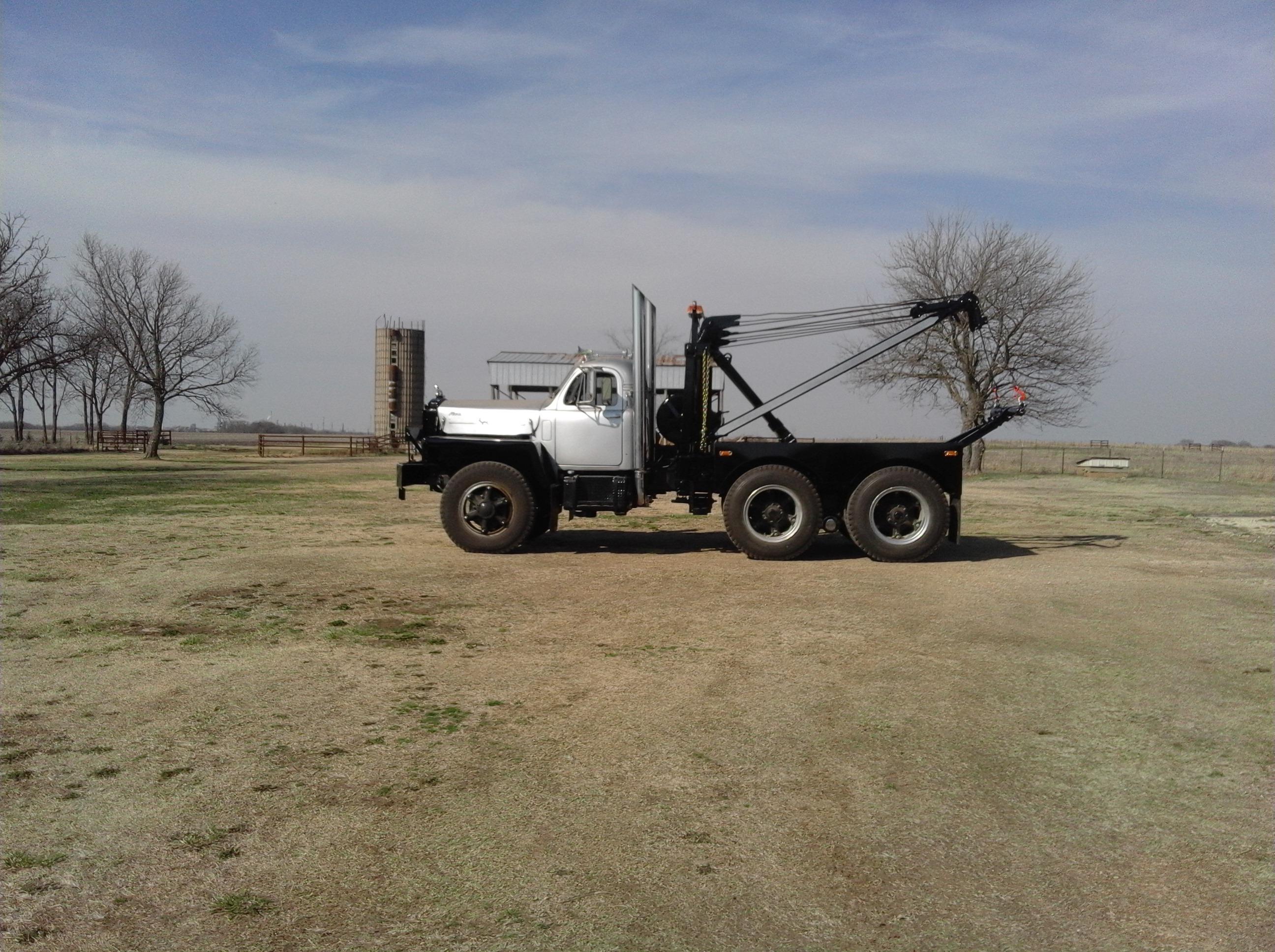

I have a B81-SX with what I believe to be a 237 Maxidyne. The engine number is 239GB5354. The dipstick in the engine is obviously for some other engine, because it reads way Overfull when I add 32 qts oil. Any suggestions about where I might find the correct dispstick? If this is truly a 237 Maxidyne, I believe they came with 2 different sizes of oil pans. Thanks

Rob: Further details: 1. Tire size 1100-24 2. Pic of shifting legend. It reads "14-speed quadraplex transmission with main direct in 4th speed" 3. Found what must be the Q, so it reads TRQ 7220 4. Pic of transmission: Thanks for your help. I grew up in Detroit, and watched with fascination the building of the Interstate system. Particularly intrigued by the "Michigans" which were hauling rock and gravel. Mostly Autocars then. My Dad worked at Detroit Diesel, and so did I for awhile. He was a salesman for Detroit Diesel, and they were experimenting (this was the '50's) with repowering a variety of trucks with Jimmy's. He would drive home the latest project they were working on. Still love the sound of a high-revving Jimmy 2-cycle.
It's raining out here, as usual. Can't mow, and nothing else to do, so tomorrow I'll go out and 1. check tire size 2. take a pic of shifting legend, which I believe I transplanted from old cab before repaint. (Got rid of that putrid green color they put in the interior of these trucks originally.) 3. look again for the elusive 'Q'. It's dark as the inside of a cow under there. 4. take a pic of the whole tranny i really appreciate the advice and help. I'm particularly interested in whether this tranny is original. Don't know a whole lot about this truck, other than the fact that I got it with a bum engine, no bed, and had to reconstruct it from scratch. I will say, after all the work I've put into this truck, that Macks are not disposable commodities--at least the B models, which is all I know. Everything on this truck was well built, and, if broken, is very fixable. I can't say that about most of the stuff I deal with anymore. Best Regards, Day Radebaugh
