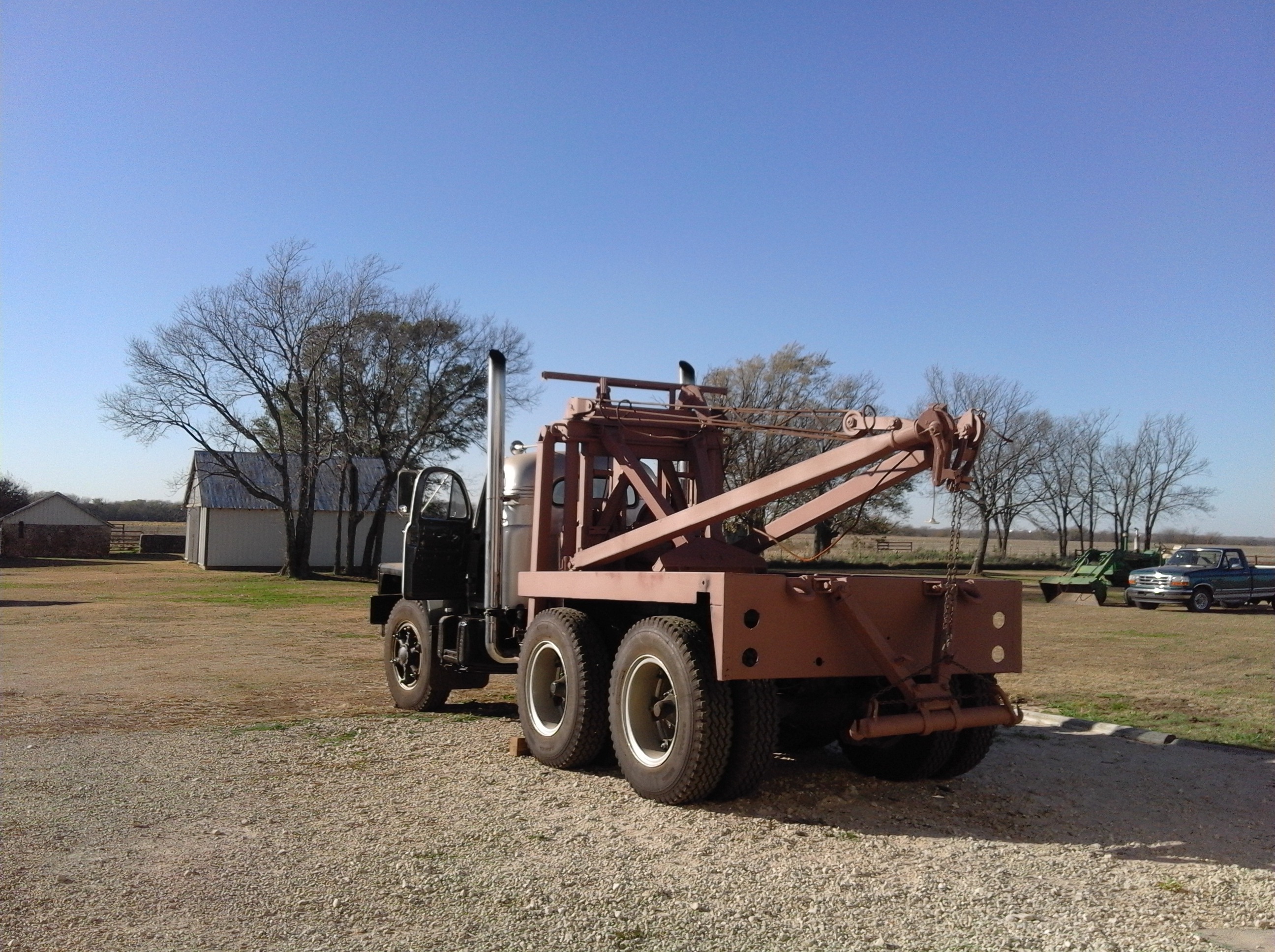

This is getting interesting. I'll get those numbers off the rear diff housing tomorrow. 8.27:1 rings a bell from long ago. This truck must have done the real heavy lifting. I was a much younger man when I spent a summer mounting and drilling the holes in the new 3rd frame member from the inside out with a 1/2" Makita drill. I certainly know the cribbing routine; I had the Holmes 750 all cribbed up as I restored that monster, see below. I live in oil field territory in Kansas, and the local oil field guy brought his big old tandem out to lift the bed onto the truck. On the left of the picture, I'm getting the Mack positioned to drive under the bed after the crane on the tandem hooks up and lifts it up. That was exciting. Here's another of the finished truck. Only thing left to do is hook up the 750 to the Mack PTO. Here's the inside: Truck had been sitting for 2 yrs. unused. Went out Friday and, after charging the batteries, she fired right off. Had to give it just a little snort of ether, but after that she primed up and got going. Thanks much.

Truck pictured is a B81SX that I repowered w/237. Has a quad box. Just getting it back on the road after couple of years storage. She's low-geared; have forgotten the final ratio, but the best she'll do is about 45 mph, 5th gear HI range. Question: Can I drive this thing using just using 5-speed main box, with compound in LO or Direct safely, that is, without putting too much torque on the tranny-clutch during shifts, or should I split? Thanks Day Radebaugh

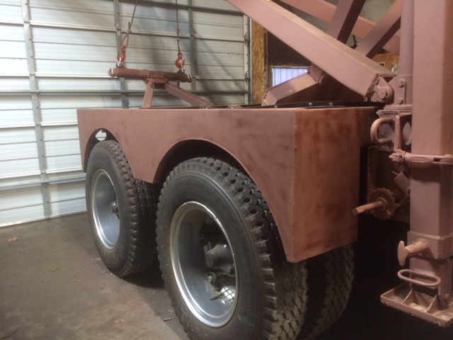

Hopped in my B81SX with a quad the other day. Temp was about 20 deg. F. Main box shifted fine, but back box (4 speed) would not shift, at least easily, for about 5 miles. Would it be safe to put synthetic in this transmission? If so, what weight? Any brand recommendations? Would I need to flush out the old fluid before switching to synthetic? As you can see, am in the process of installing a Holmes 750 on the unit. Will be hooking up a PTO to the transmission, so now is the time to change the fluid, if possible. Also in the process of installing fenders on the wrecker bed, as below. Thanks for your help. Day Radebaugh
