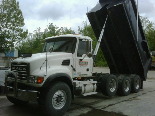

you got that right.... i hate to "rig" on stuff, espically if its new, or close to new. I know to move the drives back further, but its still just a bummer that you have such a gap between the cab and dump body. Everyone in our area uses a 16' body. So i dont know about that problem. On macks website, they are proud of their 'back of cab clearance." I think its a shame what they have done behind the cab.... Would people agree with me in saying that 70% of macks business is with some other "bodybuilder" adding on their frame? -

that would work. but we want the shortest total length possible. Would that affect the total length? Or just move the tandems further back? It gets tight in some of the places we go. But we did talk about that solution.... thanks for the idea though. Some of the International 7600 we work with have the rear wheels almost right at the tailgate. the only overhang is the dump apron. Has any other people with other bodies (garbage,concrete) had problems with this? -

thats our problem with weight right now. Our Cv's are tri-axles, but we cant get much weight on the front axle because the dump bed (16') sits so far back past the rear tandems. If a truck gets loaded too far in the rear it feels like your doing a wheelie down the highway, plus its a crappy ride, and a crappier truck to handle. This problem could be the nail in the coffin for our Mack truck run..... Kenworth has their gameface on with the t800. -

We are looking at ordering a few new trucks this winter, and we have been talking to our dealer about the gap between the cab and the dump body (ox bodies) that is caused by the exhaust sticking too far back. Is there a fix to this problem? I know Internation, Volvo and Kenworth with dump bodies are right next to the cab (3-4" between) Our CV713's have like a 10-12" gap..... Can mack not do any better? they could move the exhaust more twards the side of the cab and do better. Or be like International and mount the muffler under the cab and run the pipe up the truck... thanks for your help.

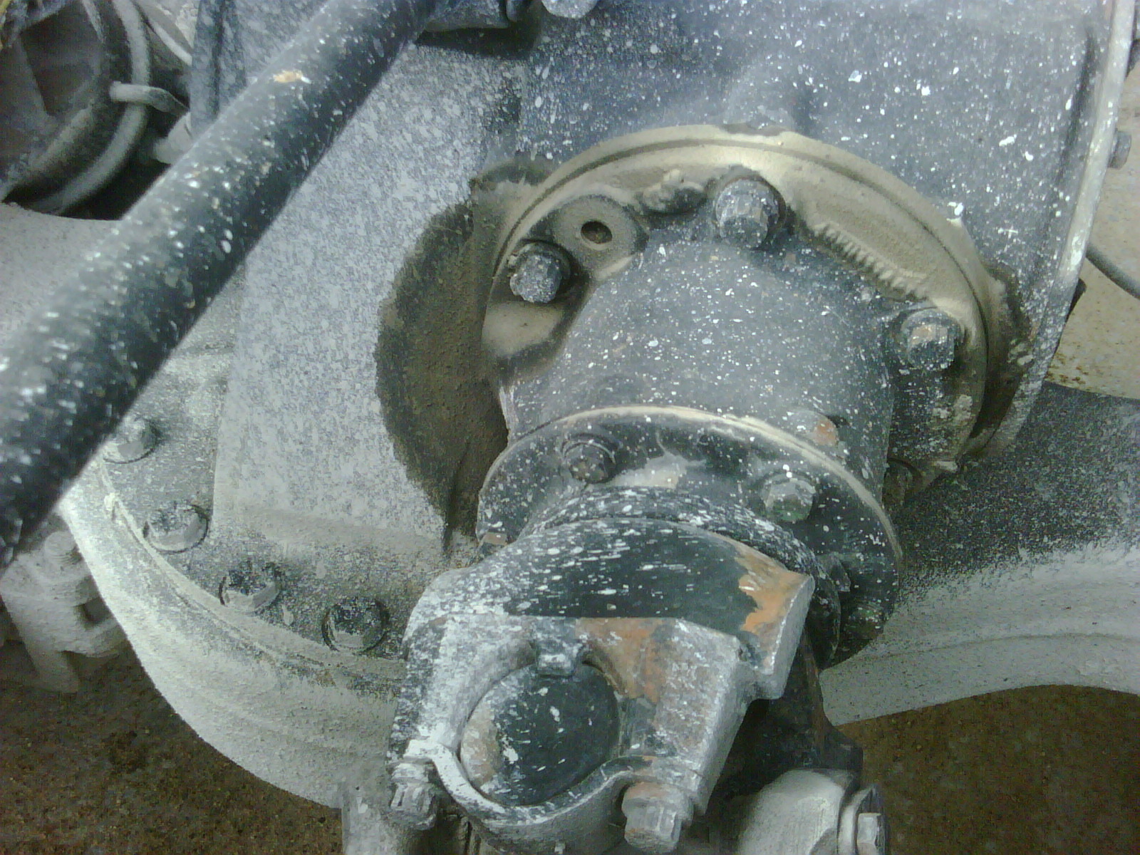

here is a picture of my problem...... i think this is the rear tandem....... I think this will clear up where it is leaking.
the truck has a torque rod on the rear tandem....... but not on the front tandem. Its not leaking where the top part mounts to the bottom housing, but where the drive shaft comes into the tandem its self. there are bolts that are odd looking. Like you have to use a 16 point wrench to tighten them up. But they are tight, I have already checked...... Ill see if I can get a picture tomorrow. If i had these two leaks fixed, then i would have a "leak free" truck! I just fixed a shepherd steering gear that the seal was leaking opposite the sector shaft. Well, I take that back, the 4 stage dump hoist is leaking, but from what i heard, you could put new seals in it, and the next day it would leak????
have a 2006 cv713 with a s440 rear ends. Pardon me for my lack of technical terms, but there is diff. oil leaking around both of the tandems where the drive shaft comes into the top carrier. The front tandem had the power divider, then after that is where it is leaking. Its not a bad leak on the front tandem, but the bottom seems to get worse all the time. Well, anyways, my dealer says there are no seals or gaskets to put there???? Its just metal to metal? Is that correct, and if its not, how hard is it to replace the seals to get them to stop leaking.
