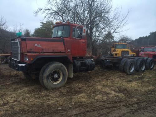

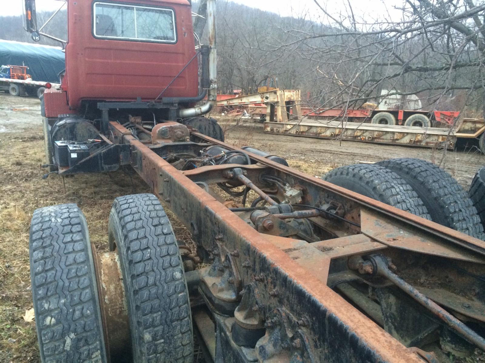

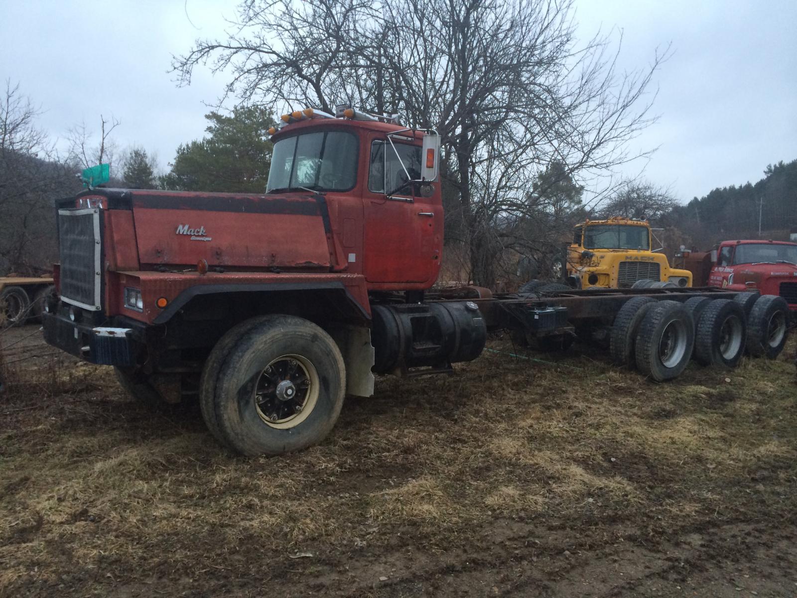

  6. Mack 5 speed, Spicer 4 speed. Factory. Has power tower. 20 front, maybe heavier. 44 rears on Hendrickson rubber block suspension. Double frame, about 15 feet from cab to center of tandem. Have paperwork on major engine work not long before parked. $25K
