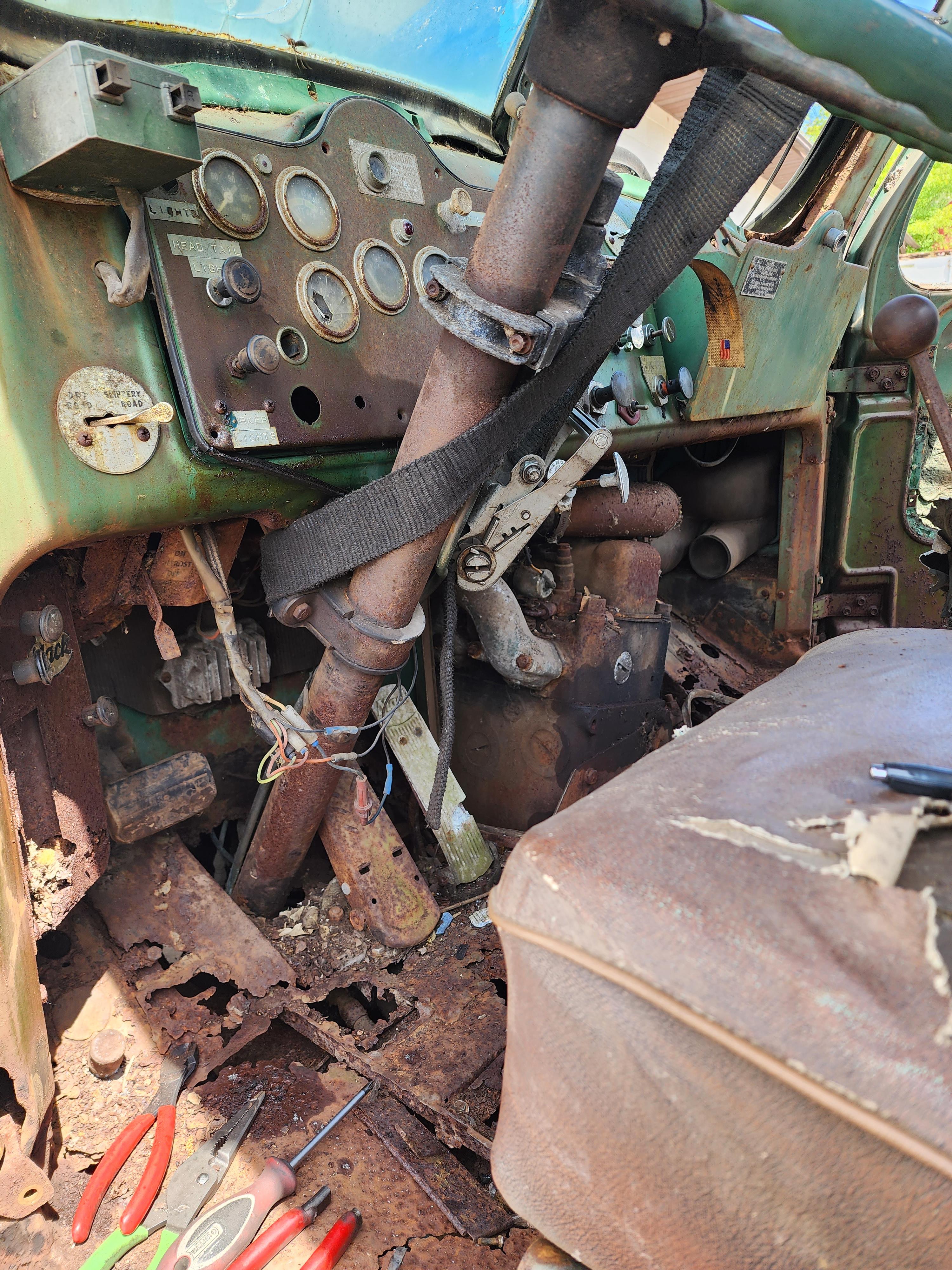

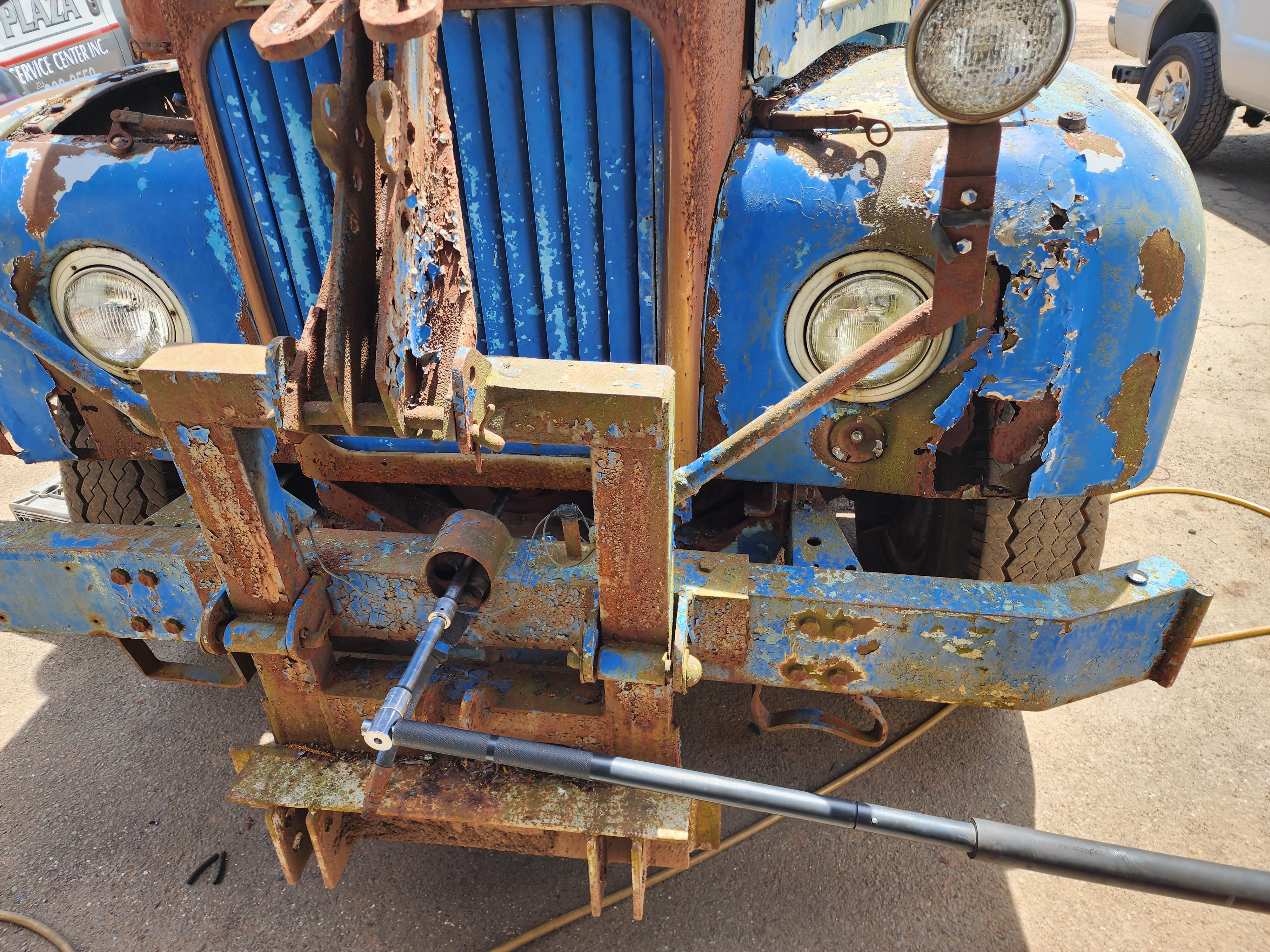

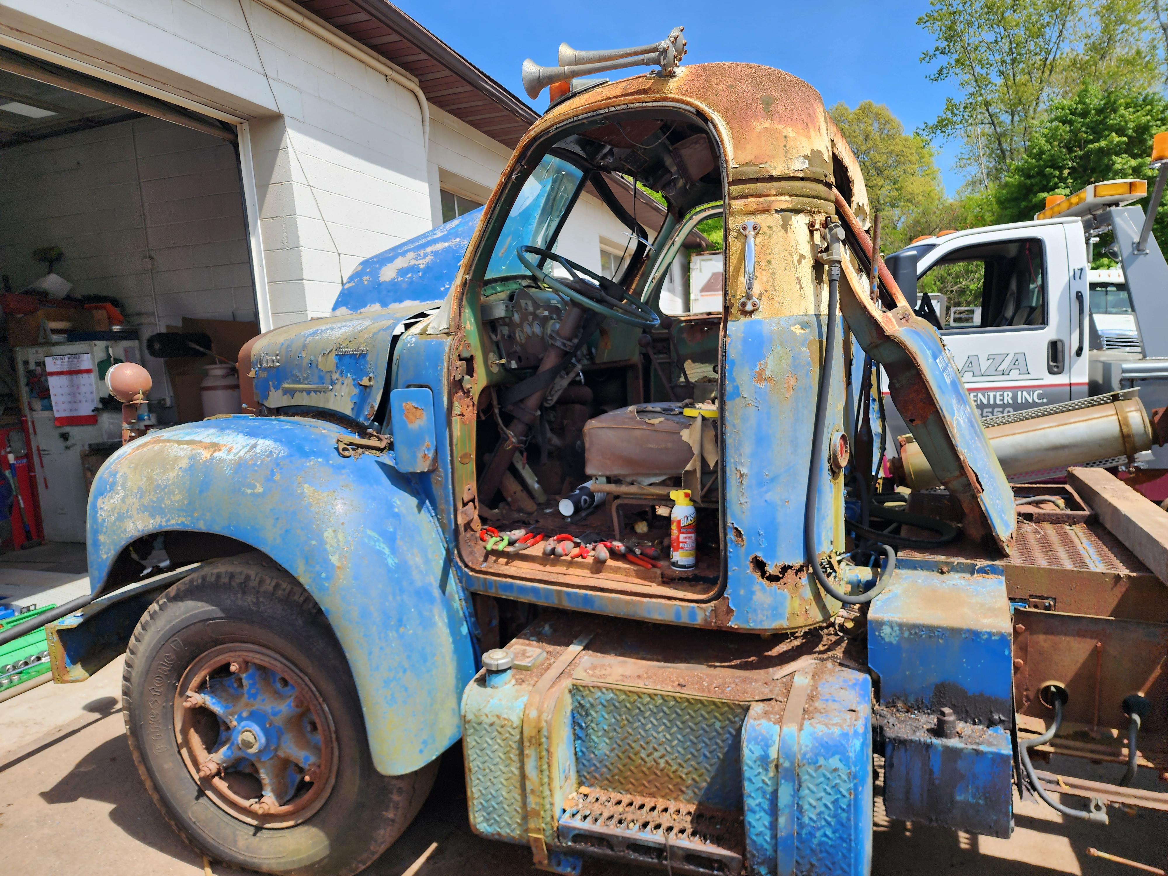

  3. So this past weekend was slow going, I had more interuptions than needed; but that's life. Got the parts truck pulled up to where the shop air would reach and started the process of stripping. Things that should have fought me did not, and simple things became massive projects. Got both doors gutted and found that the bottom quarter on each had already been re-skinned. Its always neat to see how body work was done back in I assume the 70's, simple sheet riveted in and mudded up. If anyone wants the door shells let me know, I feel they are more work than it's worth. Spent way too much time getting the transmission freed up, and I was able to press the clutch....once and now it is frozen released. Then spent about an hour freeing up the engine and now it turns over easy with a 6ft cheater bar on the crank. Threw some juice to the starter and the bendix comes out but the starter motor does nothing. It is a 24v starter. Anybody have a part numver for a rebuild kit? Or better yet a 12v conversion kit? I took less pictures than planned, and no video as there was no starting the beast with a bum starter.

  5. I appreciate your support! I felt the group deserved an explanation as to why a new member just vanished for nearly a month. Also, I'm well aware (unfortunately) that as soon as I discard what I thought was trash...I'm going to need it. Though any input beyond what I'm thinking is appreciated. Here's my list: Mirror brackets, cab clearance lights, air wiper motors, steering column, entire dash assembly, doghouse, driver and passenger seat frames, window regulators, any good glass I find, good (or reasonably serviceable weather stripping, front axle, front hubs, maybe the engine/trans, prop shaft, hood, radiator, Kysor radiator shutters, radiator facia, air horns, emblems, Passenger side door, fuel tanks? (unknown condition, missing cap on one side) battery box top, 5th wheel, maybe the crossmember that supports the back of the cab, oil bath air cleaner and all requisite pipes/boots, front bumper, asbestos exhaust manifold shields, steering gear. Things that are totally shot: cab, driver side door, frame (double frame rust jacking apart), fenders (massive rust holes and bent), transmission [duplex]? (Refuses to come out of gear even with a 200-pound gorilla reefing on it), tires, rims (scarry rusted), exhaust stack (other truck came factory with under side exhaust).

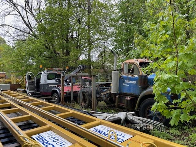

  6. Yarnall, I would love to keep both trucks, however space is limited at the truck shop and my neighbors are uptight about derelict vehicles bringing down their property value. I've already had the PD at my house investigating an "illegal auto-repair facility" (the joys of living in a Connecticut shoreline town). Hence the entire reason on this thread, the red truck needs to be mobile so I can hide it on my property out of view of the road and nosey neighbors. The blue truck is REALLY rough. I'll take more pictures over the weekend. When I went to go tow it, I attempted to move the shift sticks and the clutch pedal, and they are rusted solid. I can probably stow a lot of the running gear in the old woodworking shop in my back yard, but the frame, cab, and all but the driver side door glass is trash and far beyond their expiration date.

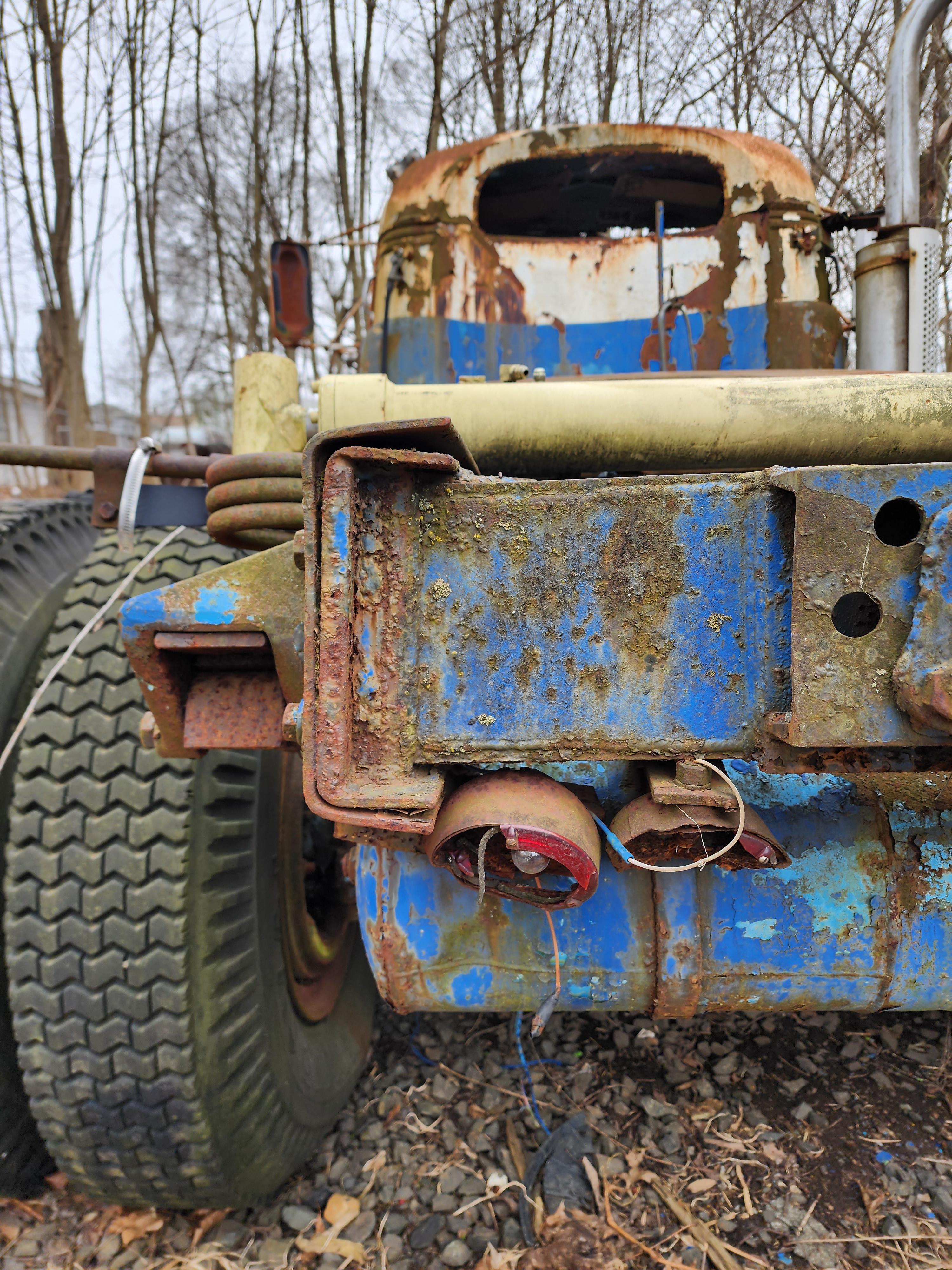

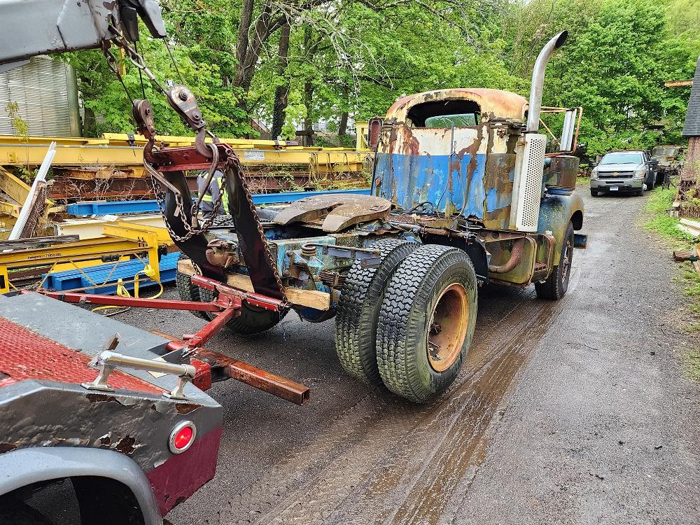

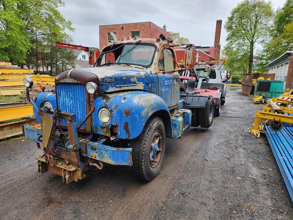

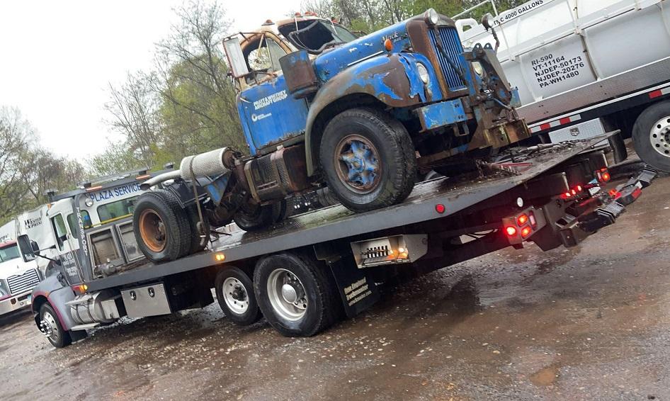

  7. Hello All! Sorry for some radio silence, I was away on some military orders and had no access to the internet for quite a bit. Anyhow, I came back last Friday and had to take care of normal household task first, and then I was able to take some time (in the rain) on Saturday and get the old blue parts truck out of its grave and back to the shop. Here are some pictures for your enjoyment 😃 This weekend I will begin stripping the truck for anything and everything that I deem still useful/salvageable. If there are any suggestions of what to save I would love to hear them. Also there has been a few individuals that have PMed me looking for parts; if I can spare them I will help out wherever I can.

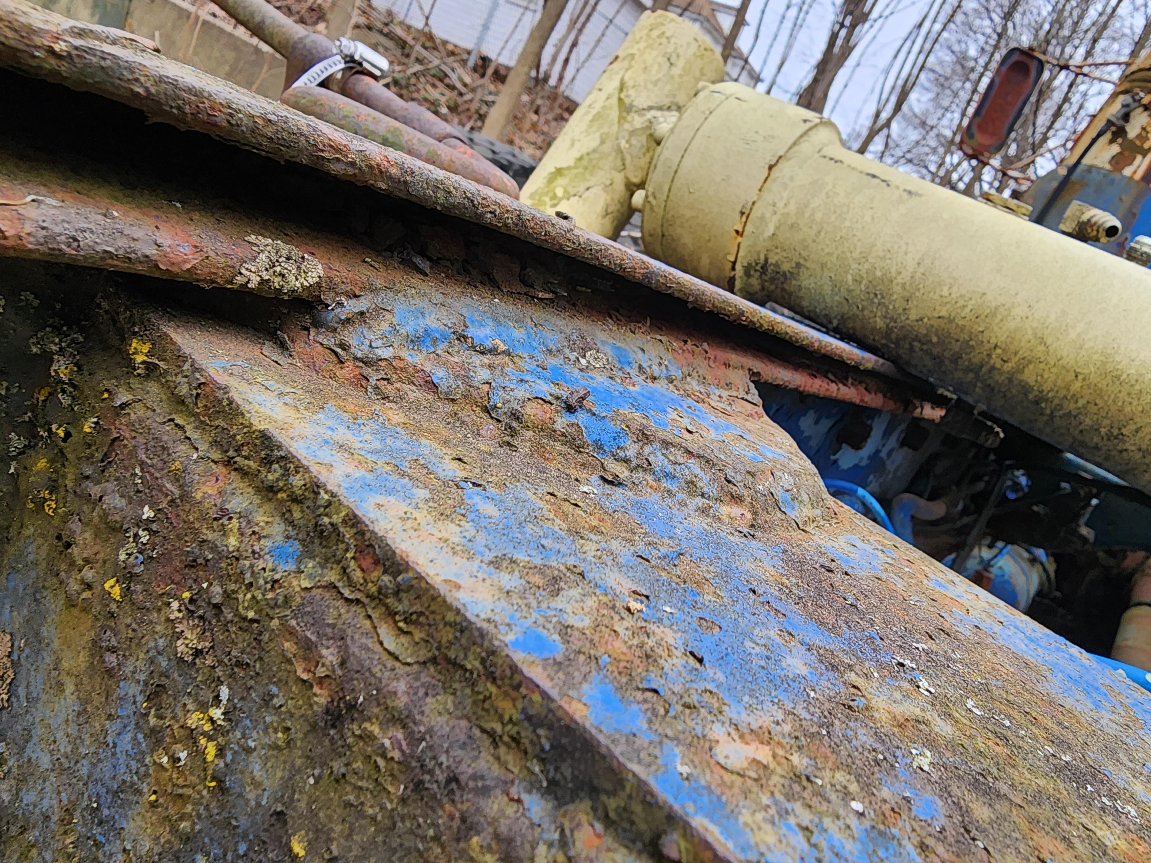

  9. It probably would run, but the frame is ahot beyond fixing. I'm going to be stripping it for parts/ engine/trans, small parts.

  12. I literally used most of the can of PB at the end of the day to spray down all of the fittings that connect to the injectors, they looked like they were going to be a fight. Most things so far have come apart pretty quickly and easily. Monday I'll be ordering up the main supply line that feeds the air starter from the air start tank.
  13. I appreciate it, I have to work out a time where I can use the small 25ton wrecker to tow the Red Mack, the Blue 'pratt' truck will need to be put on a landoll trailer. We're already working to clean up a spot in the back lot to park the trucks.

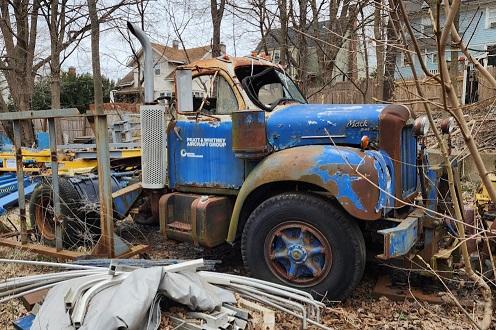

  15. If you think this truck is untouched, you should see the sister truck I picked up as a donor. Another B67, and old Pratt & Whitney truck (posted on FB "Scrap Macks" group. It still has the asbestos heat shields above the exhaust manifold, and all of the air plumbing is intact and neat, too bad the double frame is rust jacked and the cab is completely rusted away.
