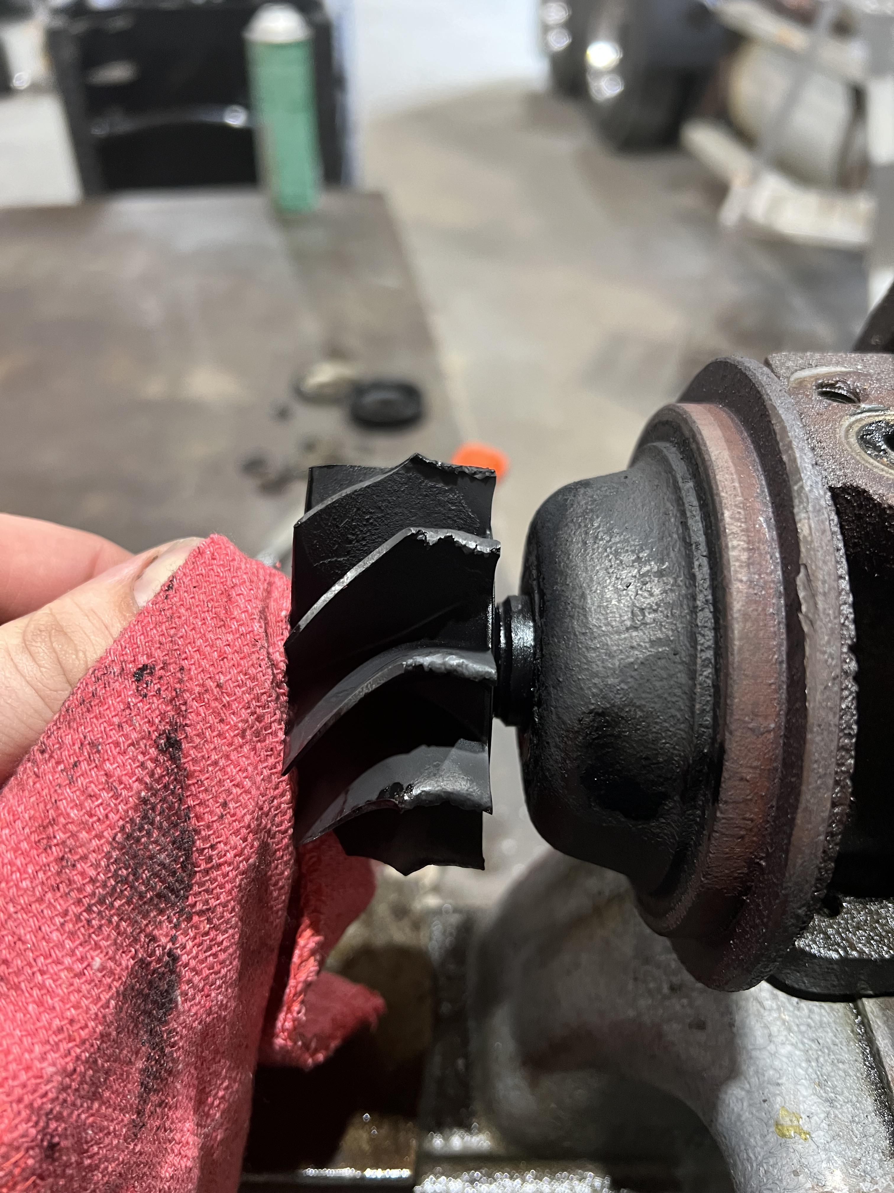

What a difference a new turbo makes. Got 25psi boost just driving not hooked to anything. Going to tweak the pump a little and try and get a little more out of it.
I feel like an idiot for it catching it earlier. And I also thought it should be smoking more. Guess it was getting just enough air to keep smoke down. Now I have to try and get the pump set back to where it was when I started. Will give a full report all is done. Thanks for all the help.
Well curiosity got the best of me this morning. I decided to take one more look at the turbo before I send the pump off. I removed it this time and really wanted to get a better look at the exhaust side. At first glance everything looked fine. But as I was on a phone call I was fidgeting spinning the compressor side when I noticed it had a drag for a split second then it released and spun freely. Kept on messing with it and it kept doing the same thing. I put some shop air to the exhaust side and it didn’t spin as free as it should. Would come to a stop as if it had a break applied to it. Then I removed the exhaust housing and found the carnage. New turbo should be here later this week.

I pulled the housing off. It moved freely with shop air but I just felt like something was still wrong so I pulled it all the way down. There’s actually two cuts in it. I think I can find one at my dads. I’ll let y’all know how it goes once I get it sorted.
