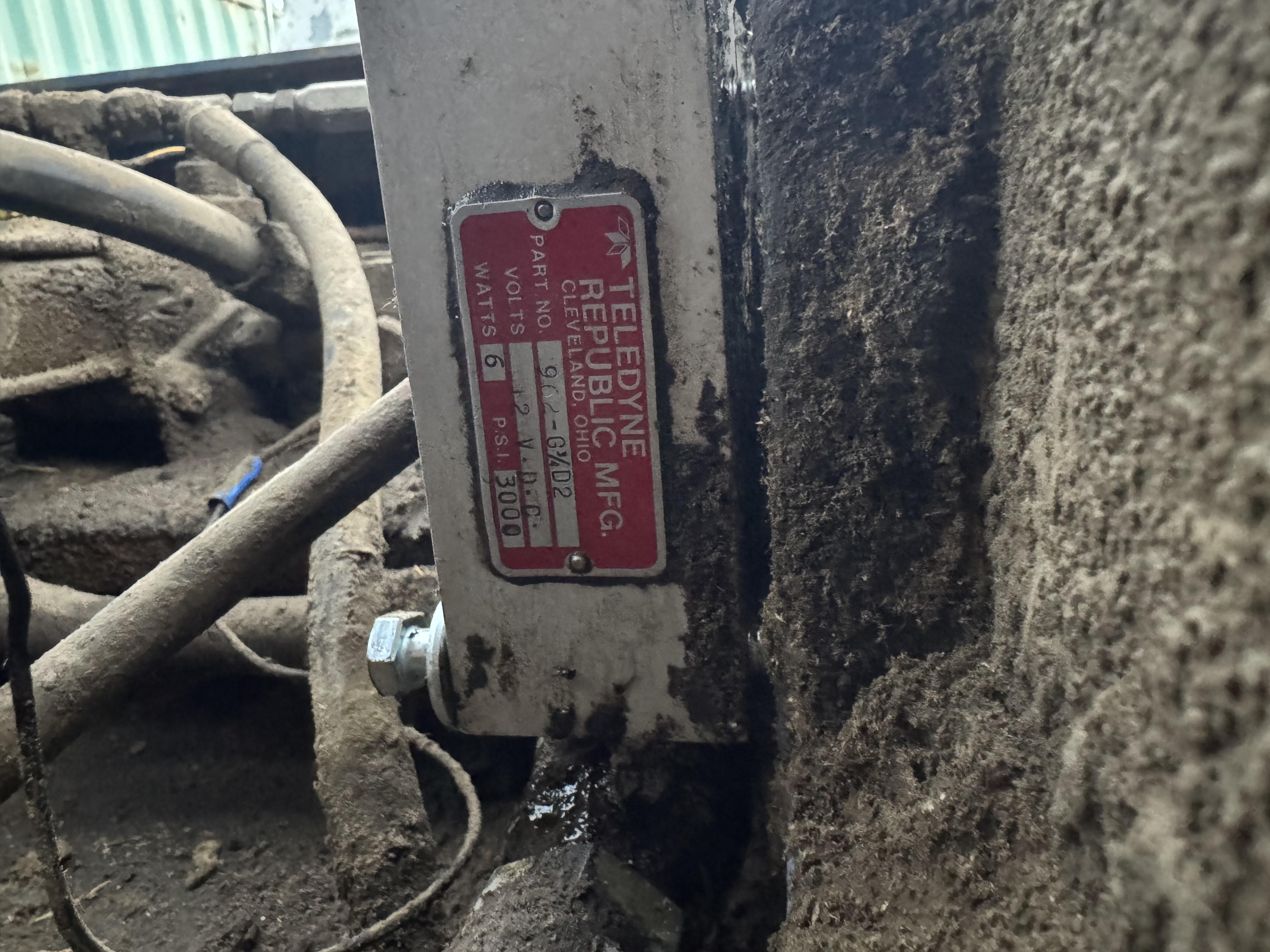

  1. Yes, this is on the rotating railway dump truck. No, this valve does not control the rotation, it controls the up/down motion of the bed. I don't have a knowledgeable enough local shop that can source this. I am very rural and my options are limited due to driving distances. If at all possible, I need to do this myself. I do have something to safely hold the bed while I work on the valve. I just need a replacement valve since the original maker is out of business.

  4. We have the bed supported in the up position. Safety first. The valve has been out already to see if we could fix it. No go. Yep, I have not been able to find a part that would fit but I am not a mechanic and do not know where to go except internet search. That has gotten me close but not quite there. I was hoping someone on here would have a good place to start. I am calling different companies but so far nothing that would fit.
  5. The bed on my dump truck went up, but will not go down. We found the problem but I don't know where to get a replacement. We tried to fix this one but it is done. Attached is a picture of the valve. It has two wires going inside an opening. The two wires move slightly when the valve is actuated. The valve does not actuate far enough to let the bed come down. The item is a Teledyne Republic Part Number: 962-G34D2, 12 volt, 6 watt, 3000 psi electric directional control valve. I found one company that makes one like it but only has it in 110 volts or 24 volts. Any help is appreciated. Thanks.

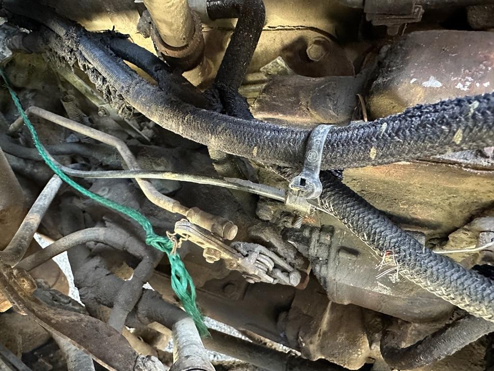

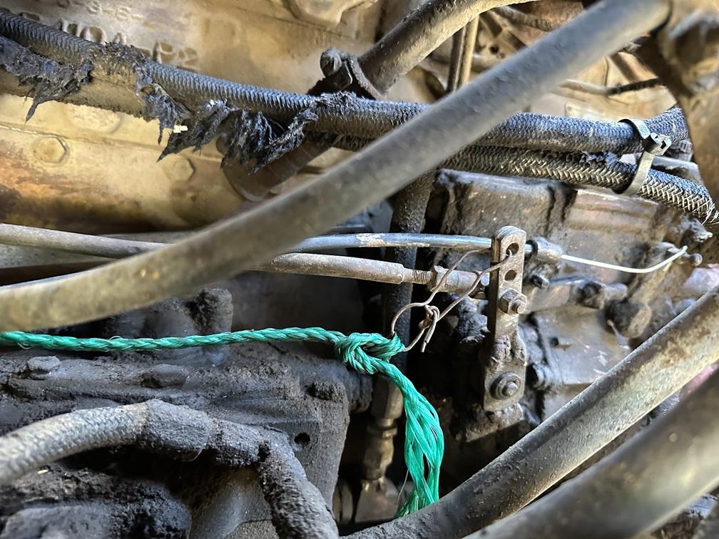

  7. I imagine the PO used the rope going through the engine cover as a way to set the basic start up idle where he wanted it. I don't see any other on demand use for it as you can't let loose of the rope and hope it goes back to the starting point since it is pinched as it comes into the cab. I ordered a replacement idle/throttle cable. All the other linkage is there I just may need to clean it up and lube it.
  8. The hand throttle is missing. I found the cable sheath under the dash and followed it to the linkage under the cab. The throttle handle, dash mount and cable are all missing. At least I know what it is now. Thank you.

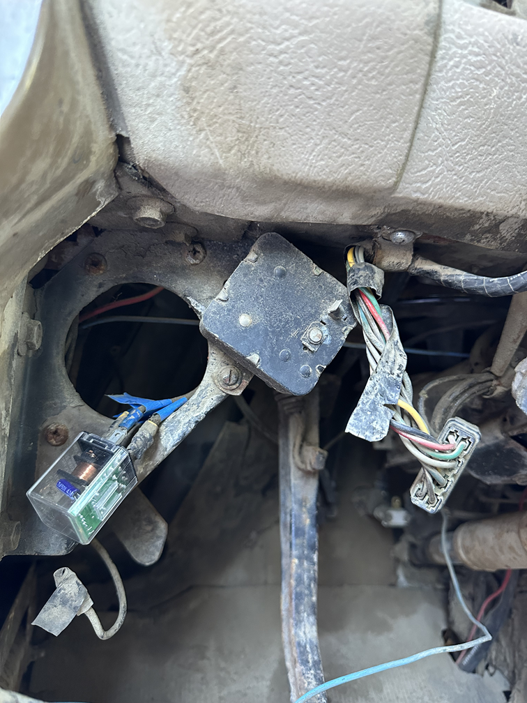

  10. Here is what i think is the buzzer box. One of the spades is busted off and there are no wires close to it that have spade connectors. Another shrug.
  11. This on the passenger side of the engine down on the lower end and back of the engine. The rope goes into the cab. I assume to pull on. Anyone know what this is and why anyone would put a rope on it?

  14. I unplugged that switch you saw on the left of my pic. When I did, the low pressure light turned off. I plugged it back in it came back on. I then unplugged the white square looking switch on the right of my picture and the low pressure light came on. I did notice the square switch on the right has 70psi written on it. The switch on the left has no markings at all and looks to be original. Rusty and beat up really. Now that I know where the buzzer is, I am going to see if that has something to do with the buzzer. I am getting closer. Thanks everyone.
