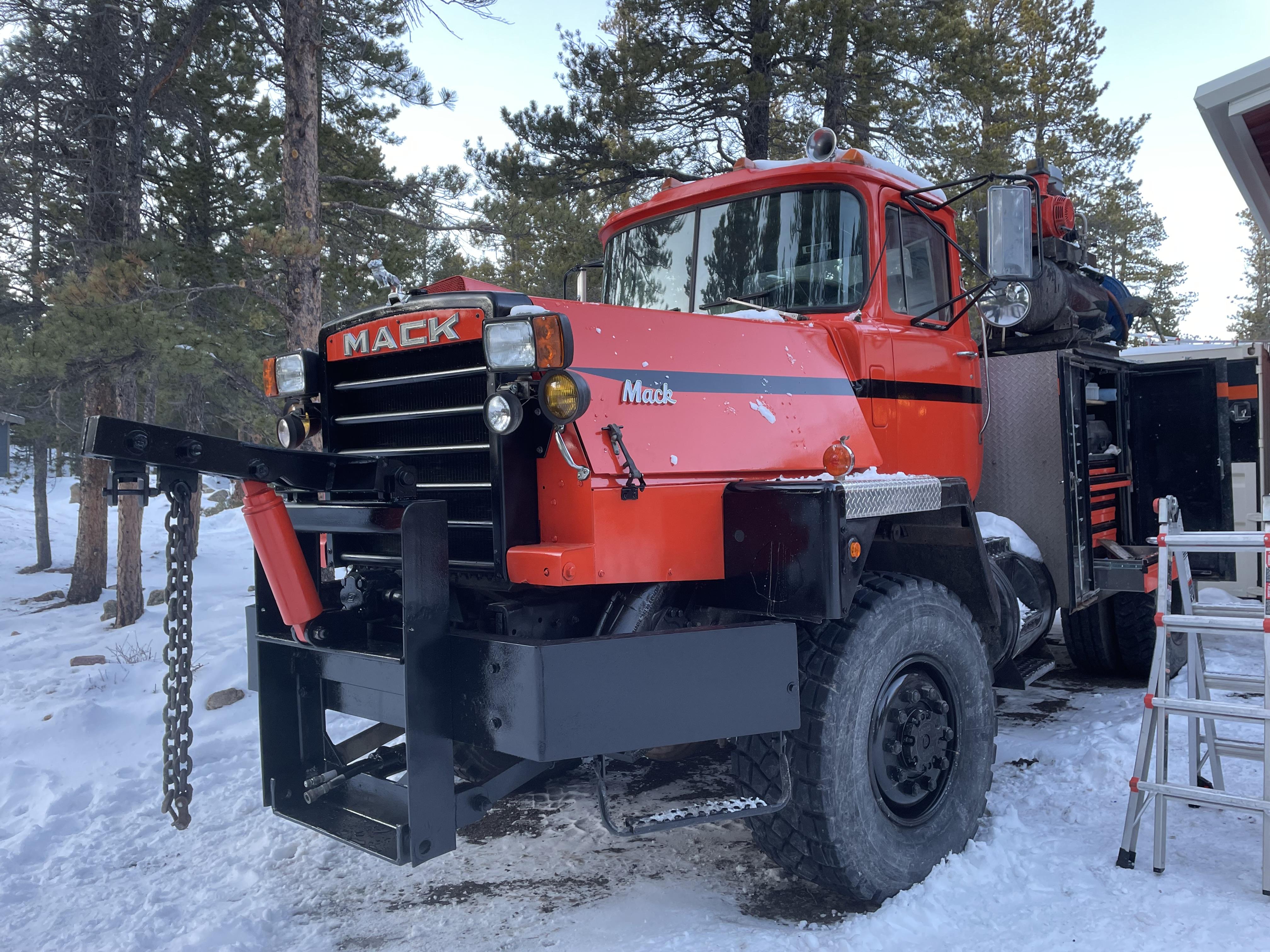

  7. Hi everyone, thanks for all the info in the forum. So I decided to go through and paint my 1986 RM6864X over the winter, but when i got into the rear axle to fix a seal, there was evidence of a bearing failure, and the previous owner tried to put it back together without replacing the hub. The hub bearing is cracked, and the seal face on the axle housing was pretty damaged. All I can find out about this axle is that its a 6.14 meritor according to old notes on my parts manual No tags anywhere giving the model. Getting a new hub is near impossible, but I would love to figure out if there’s a replacement that fits Pilot wheels instead of Budd. All the part numbers in my book are obsolete. I guess the main thing is retaining the axle with a speedi-sleeve (anybody use one?) and finding the hub. The local dealer can get the bearings and seal. The front of the spindle is about 3 1/16” in diameter. Any idea about what’s out there that fits these axles? Or perhaps the axle model? Or contact the Mack museum? Thank you! Tristan

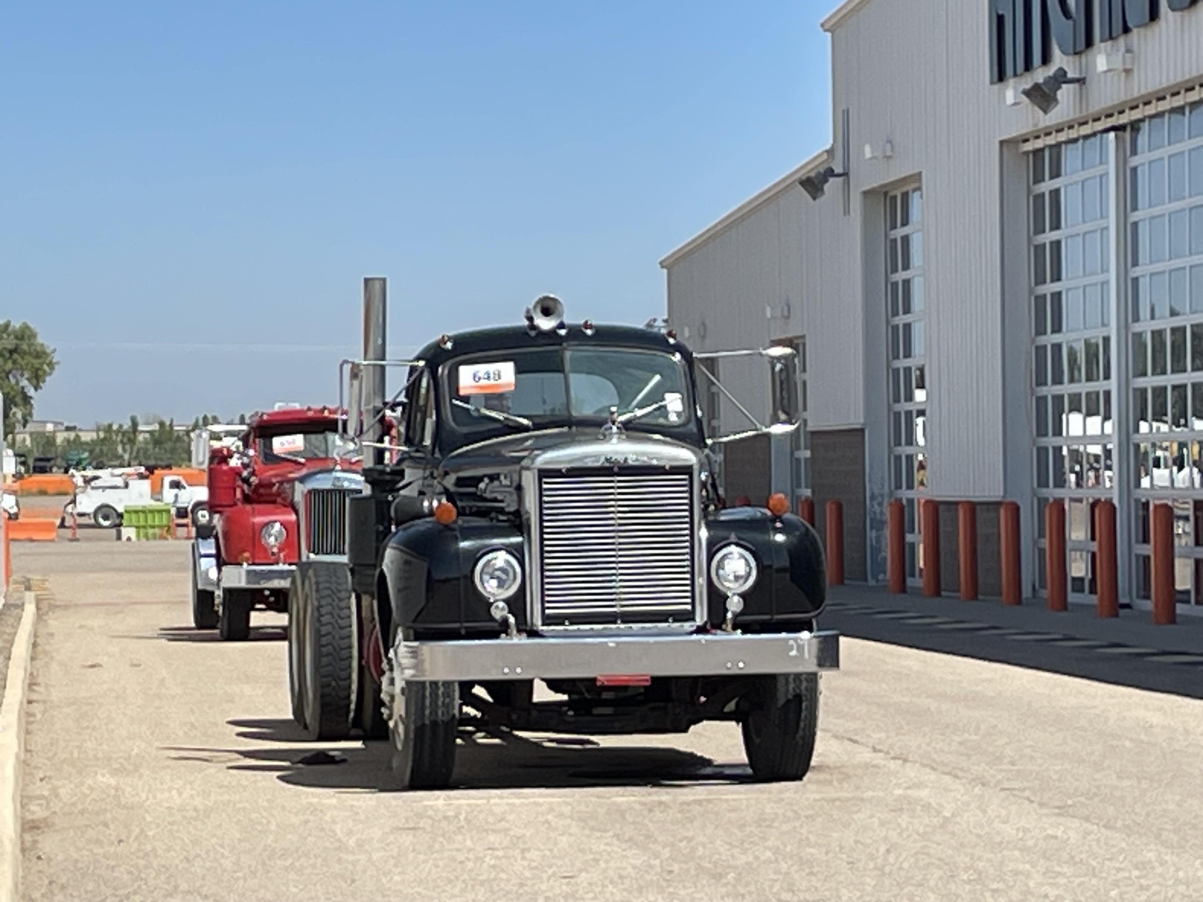

  10. A saw these two Mack’s parked at the Ritchie bros yard, I assume they are going up on the early October auction. Which i think is the Rocky Mountain event. I am not affiliated, I saw them dropping something off. -Tristan
