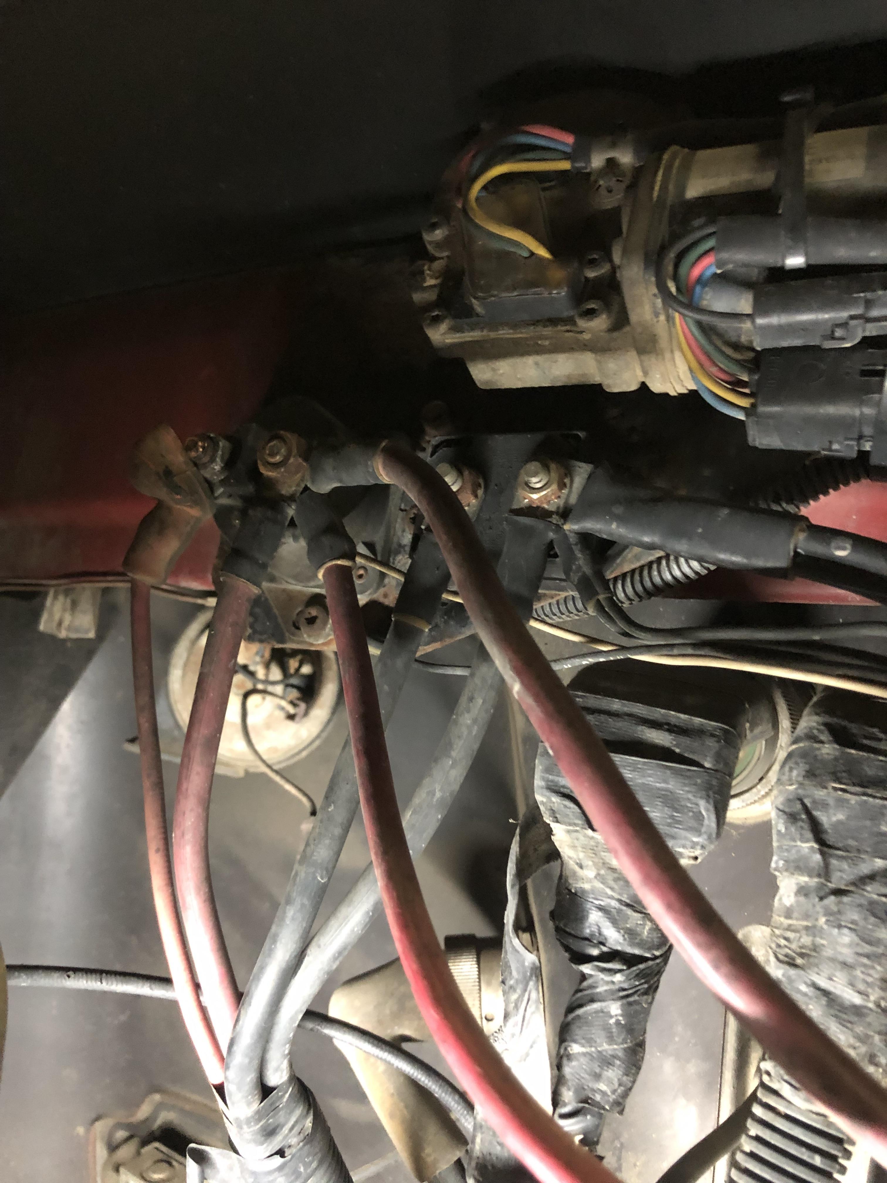

  7. Well guys I found an old used solenoid and ground breaker in the barn and swapped em out and she still quits and does the same thing so I don’t know

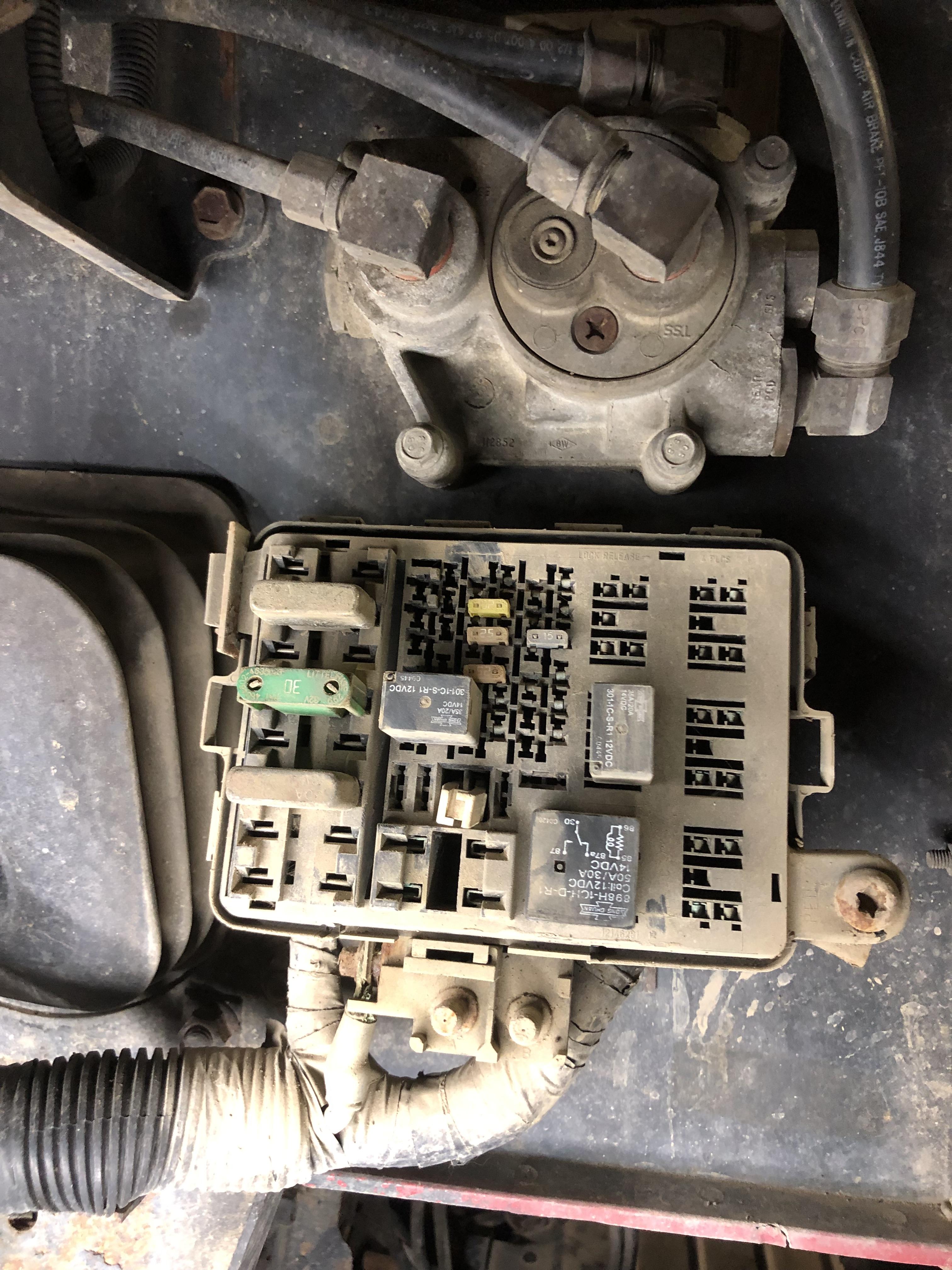

  8. I wasn’t looking unfortunately because my boss was in the truck. I had the switch panel under the ash tray and cup holder pulled today and didn’t see any relays in there but I will look again tomorrow. I did discover another fuse panel under the hood I didn’t know about though. The solenoid on the firewall has three wires running off of one side. One goes down to the starter solenoid I think, one goes into the cab, and the other goes to the fuse panel under the hood

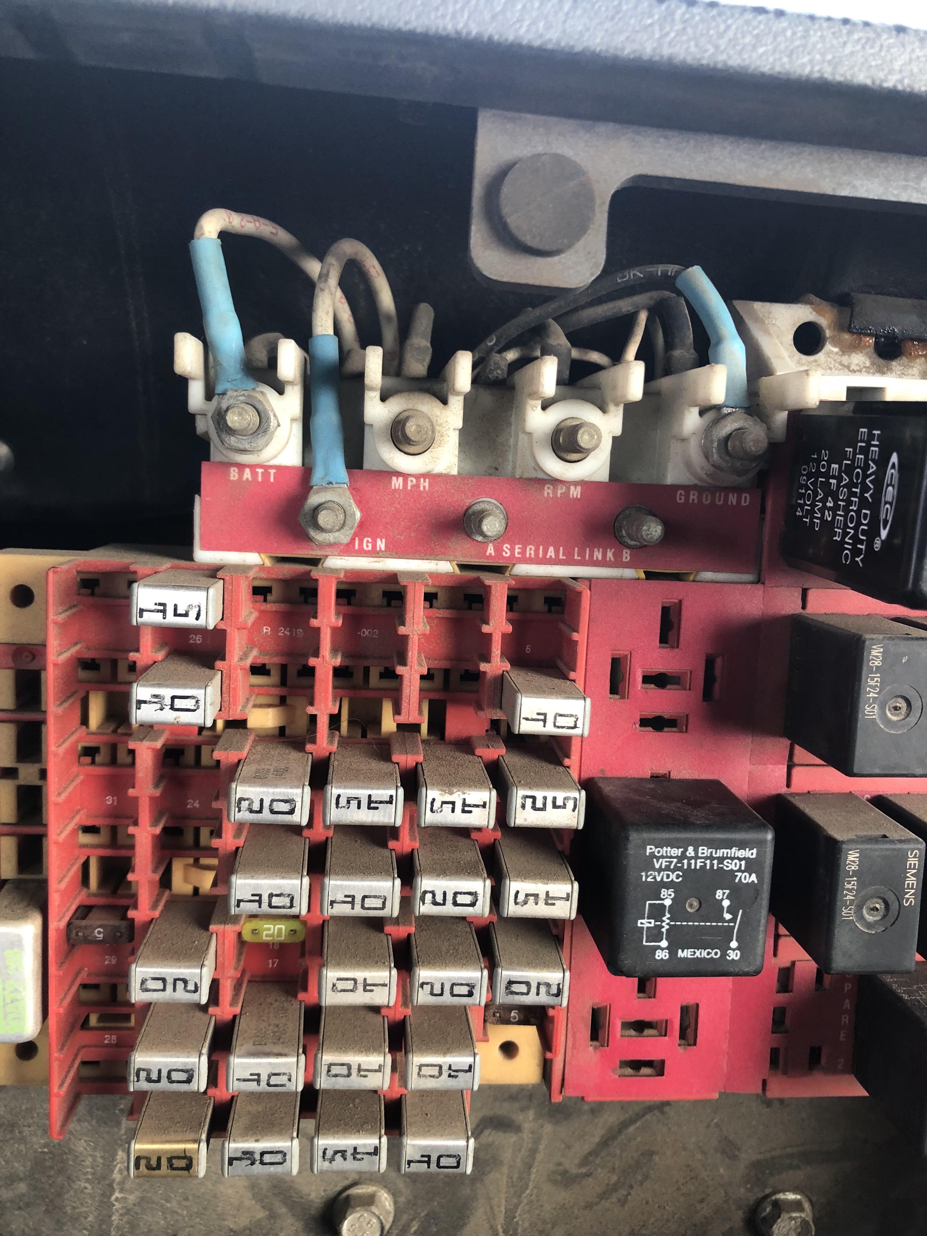

  11. Yes everything in the cab goes dead. Even the cig lighter when the key is on I only know that because it killed my power probe when the key way on. Even the lights on the truck and trailer weren’t functioning. I did check the battery cables and everything was kosher there as far as I could tell. I was able to put power to the battery wire pictured going to the fuse panel and the heater blower powered up and the truck would crank and fire up, but die seconds later. Idk if it was a fluke or what but my boss showed up and was able to keep the truck running by shutting the heater off and we got it back to the yard. The acc relay you’re talking about, is it behind the gauge cluster?
