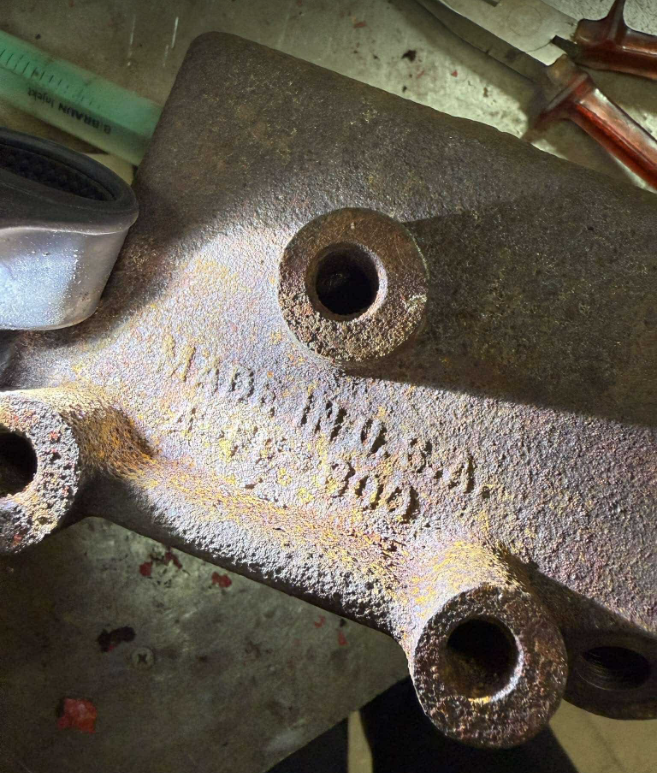

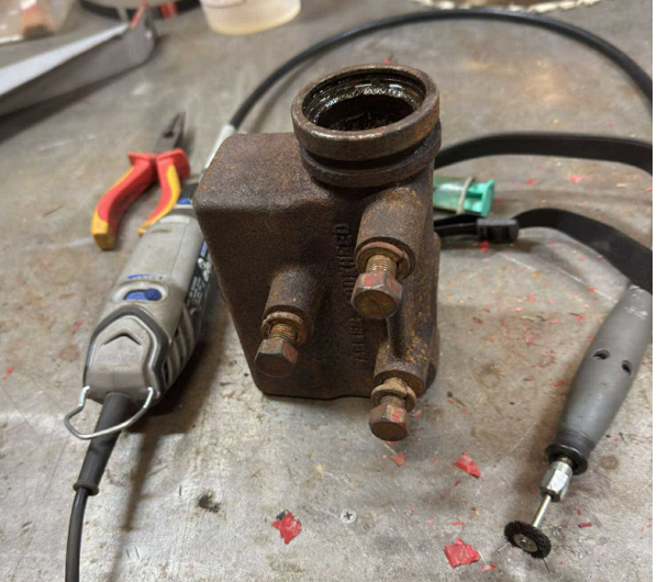

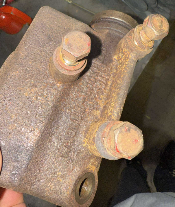

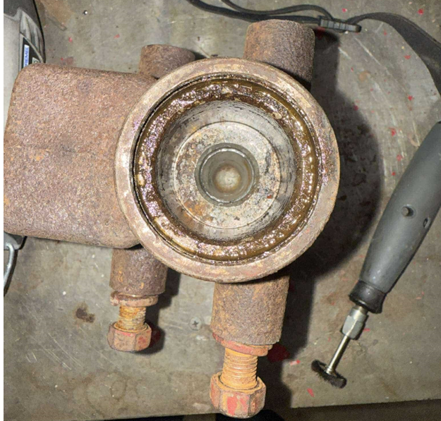

  1. Alright so after inspection here is what I found: I believe one one side it says "Wagner Lockheed (9A?)" and on the other side "Made in U.S.A (AFE 800?). This is all I found on this part, and for you here is what inside parts look like. Surprisingly the gum seals are in marvelous shape: Now it's time for hydrovac. Here are the letters/numbers i could find on this: And inside of the hydrovac: And that is all for now. I believe I found video explaining what this whole system does on YouTube called: Hydrovac Brake System uploaded by Daniel Lautenschlager.
  2. No worries, I didn’t thread the bolt directly into the piston. Since the piston is in decent shape, I wanted to avoid causing any additional damage. I only needed to twist it slightly to loosen the rust so I could push it out with grease. The only visible letters/numbers are "Wagner Lockheed." I’ll double-check for any other markings tomorrow after cleaning off the external dirt for a closer inspection.

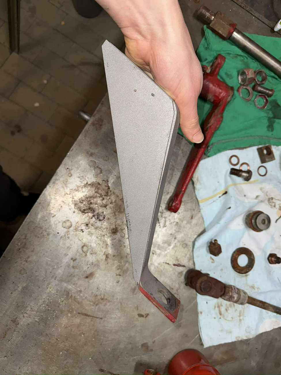

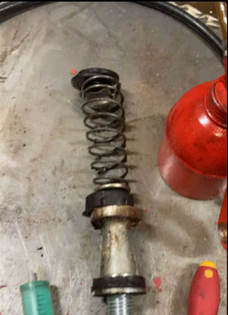

  3. Well, today I managed to take out those two components to check if they are still usable. I must admit, you were right: There are traces of oil inside, so they are indeed hydraulic with vacuum assist. However, there’s a piston (shaped like a cone) inside, which had gotten completely stuck for ages: Since I’m Polish, this was no match for my 23-year-old hands, and voilà (don’t ask how I managed to do it...): Here’s how the piston looks and a glimpse of the engineering inside: So, yeah, it’s time to use a sandblaster for the external parts. I’ve already blasted one piece, so here’s a sneak peek of how beautiful it looks under all that rust: Have a nice rest of the day!
  4. It’s been a while since my last update, so I want to start by thanking everyone who took the time to share their thoughts and advice regarding my issues. I hope this discussion has been engaging for you and I wish to repay you (sooner than later) with final presentation of restoration. Special thanks to brighter minds than me (@mowerman ; @70mackMB; @cruiseliner64; @steve s.; @tjc transport and @Joseph Cummings) for pointing out the 1st part which is RPM governor. Huge thanks for that! Now, onto the second part, which turned out to be far trickier than I anticipated. I spent two hours searching for a component that looked like an air compressor for the brakes, only to discover(after 2 mental breakdowns and three coffee brakes) that there is none… Turns out, the brakes are vacuum-operated. I believe that’s the case here (correct me if I’m wrong), and I came across a related post that supported this conclusion. For my defence, the part in the photo (highlighted in blue) appears to be a vacuum cylinder connected to the rear tires. For this revelation, I owe thanks to @Geoff Weeks, you nailed it. I hope this post will save someone in the future from the same two-hour rabbit hole I went down. Once again, I appreciate everyone’s help and can’t wait to share with you future progress! (P.S since I want everyone to be listened so: @steve s. This old baby came to us From Germany( probably someone bought it earlier and left it to rot in peace… that’s a no-no) and I’m located right in the middle of the Poland; @yarnall well this Mack was listed to be built in 1953 but you might be right… the chassis number is 1057)
