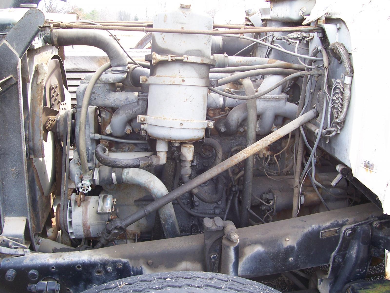

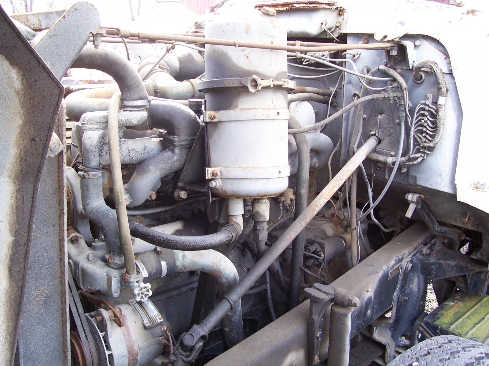

  4. Here are a couple of pictures of the oil connections on my END711. I hope it helps. Jeff

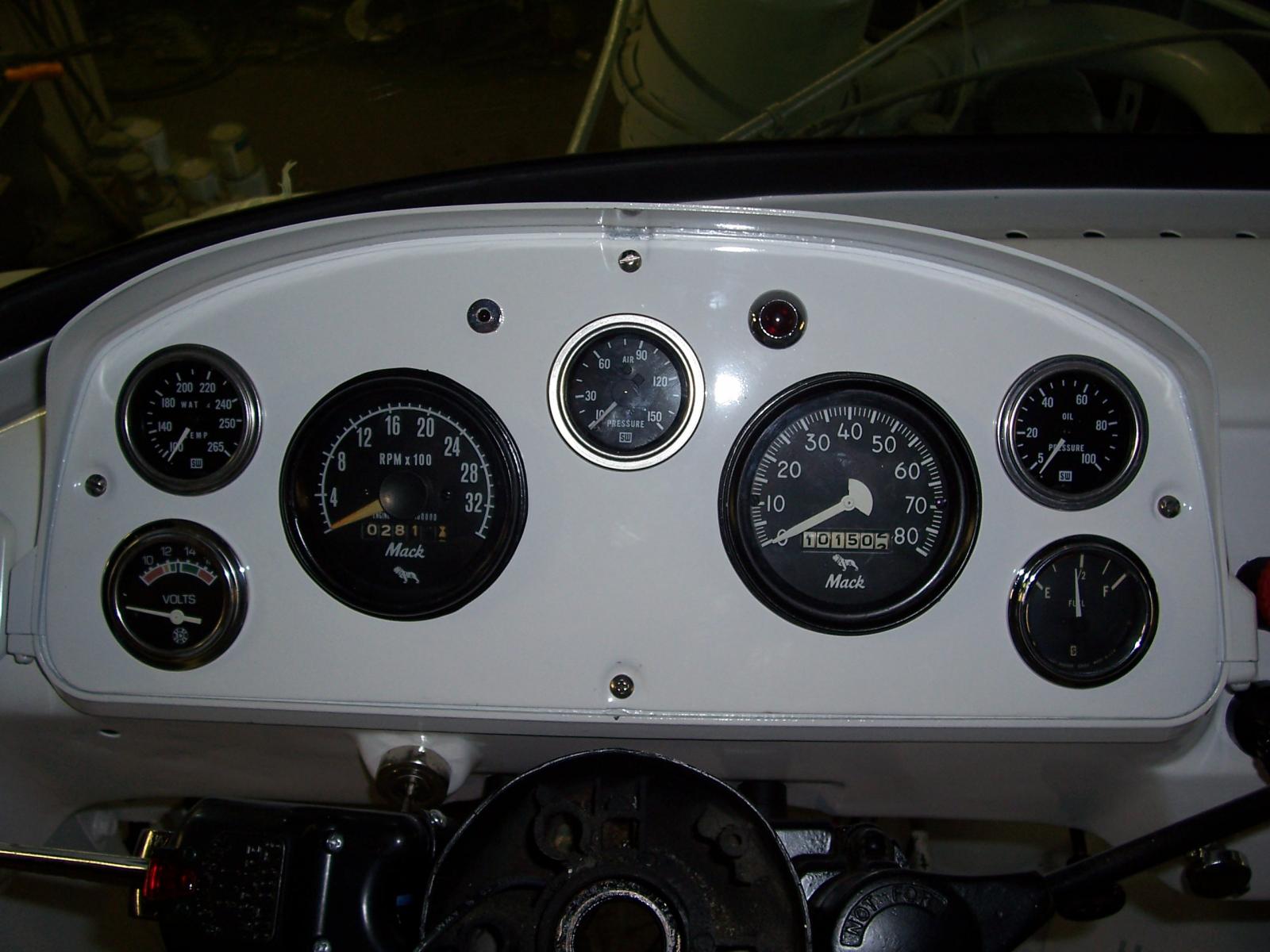

  6. Here is a picture of my dash. all original except for the air gauge. Jeff

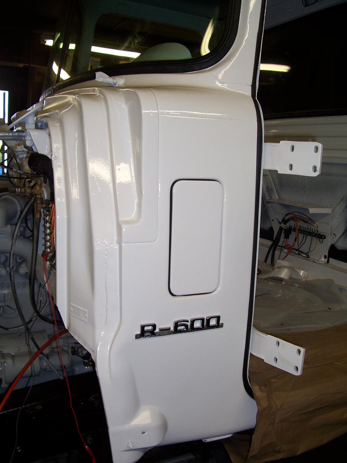

  11. Vinny, I had my R600 emblem done by http://www.customchromeplating.com/ Jon Wright does show quality work at a reasonable price. Attached is a picture of my emblem. Good luck your truck looks great. Jeff

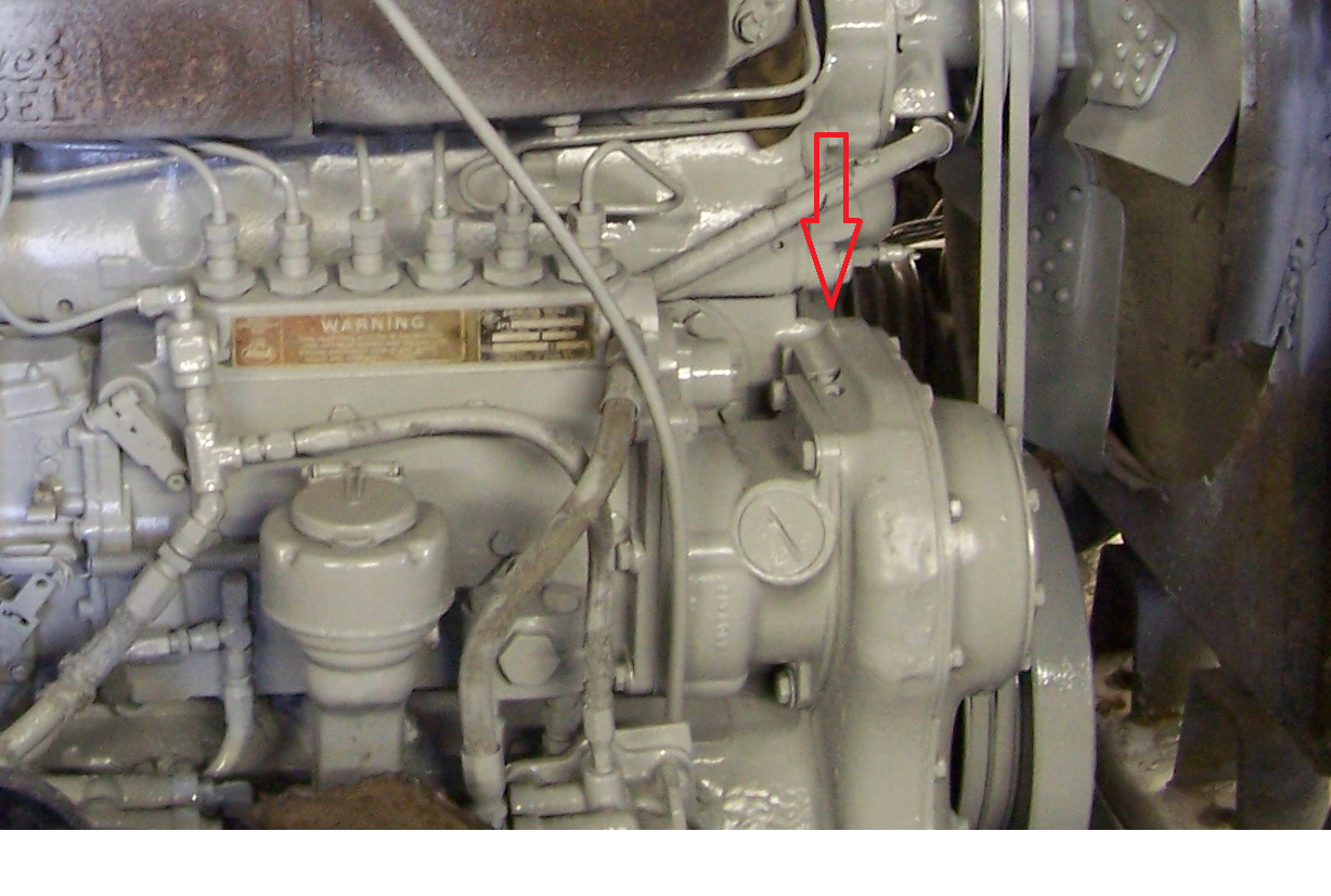

  12. On my 711 the serial number is stamped in the casting in front of the injection pump. See the attached picture.

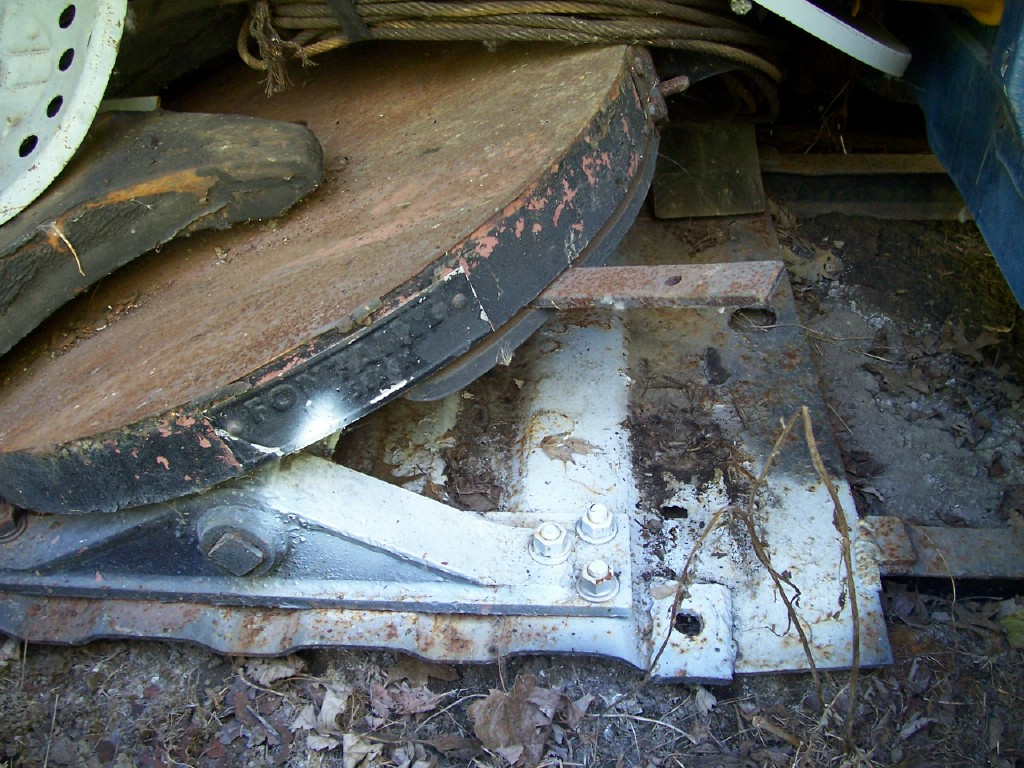

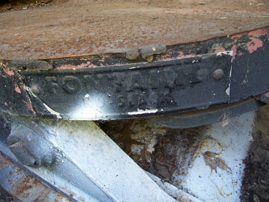

  14. I have a Fontaine No slack fifth wheel on mounting plate,asking $250 Also have R model headliner, Asking $35 Located in Grafton,Ohio Thank you, Jeff

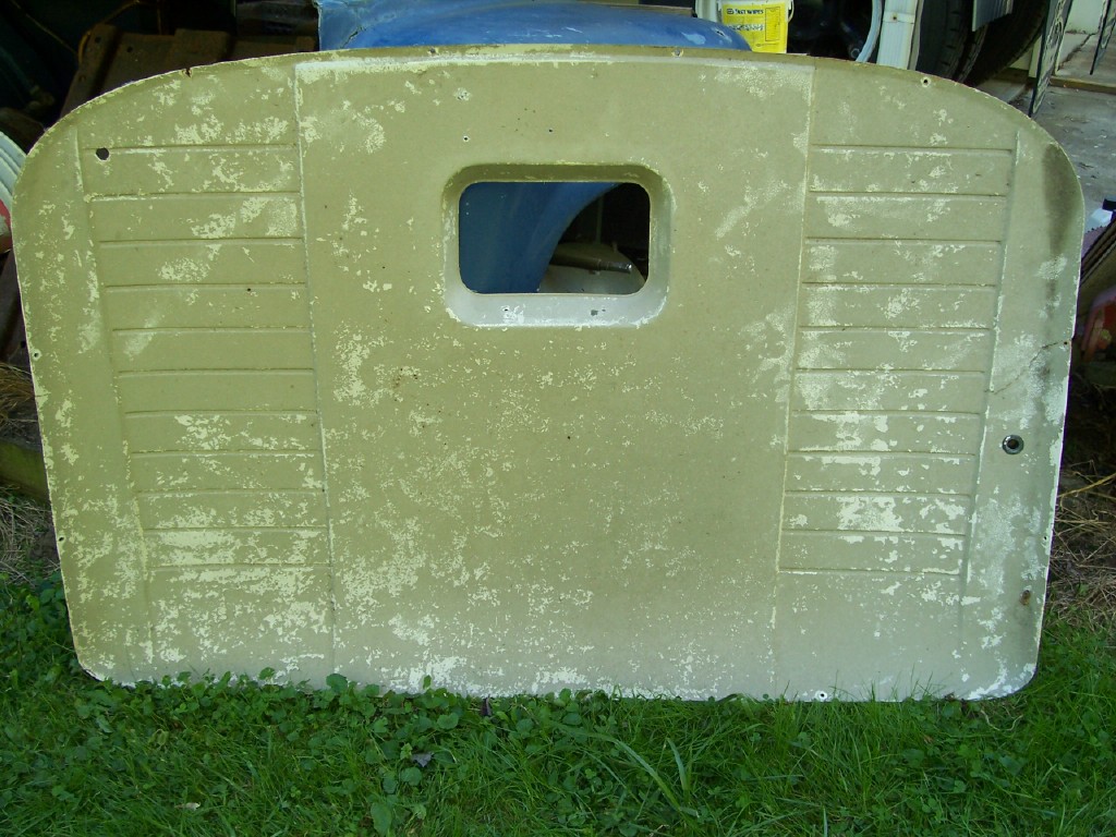

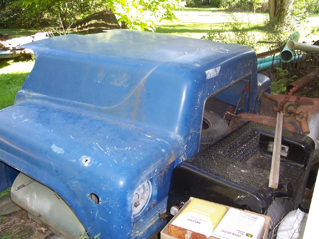

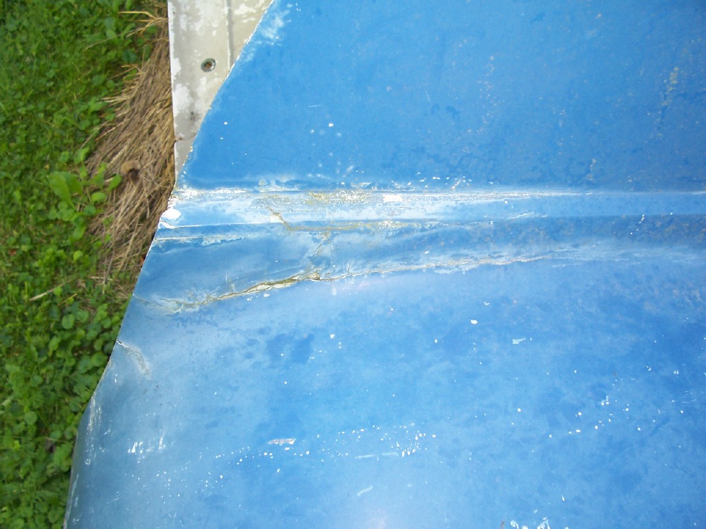

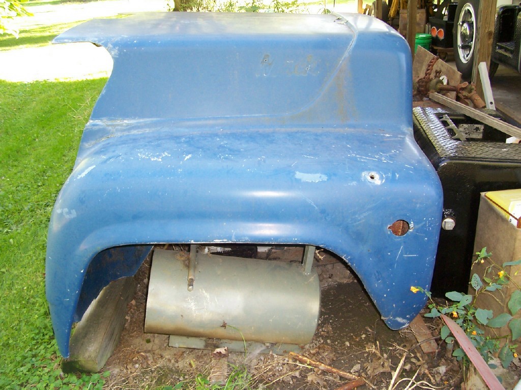

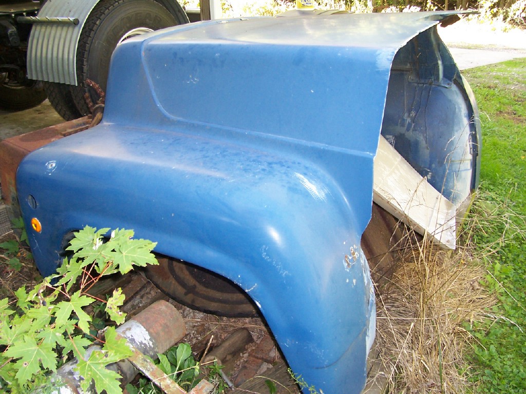

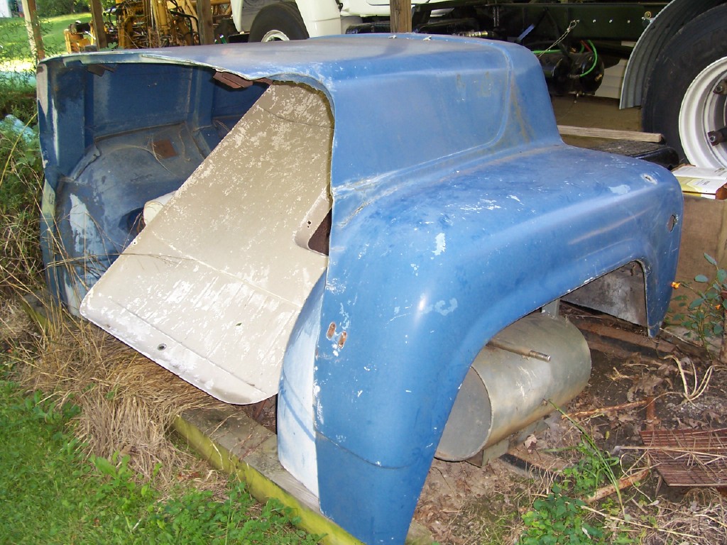

  15. I have a R model hood I would like to sell. The hood measures the same as the one on my 1968 R609. It has some old repairs and cracks and will need some glass work. I am asking $225 and is located in Grafton, Ohio Thank you, Jeff
