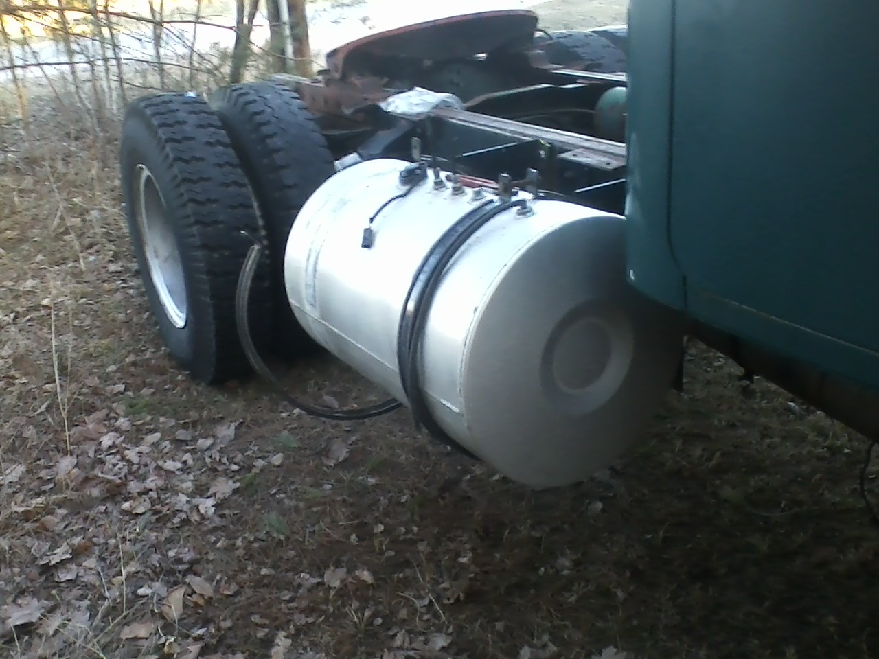

  14. Installed the new fuel tank just need some fuel line. A little electrical and rubber she will be ready to bounce around upstate ny.
