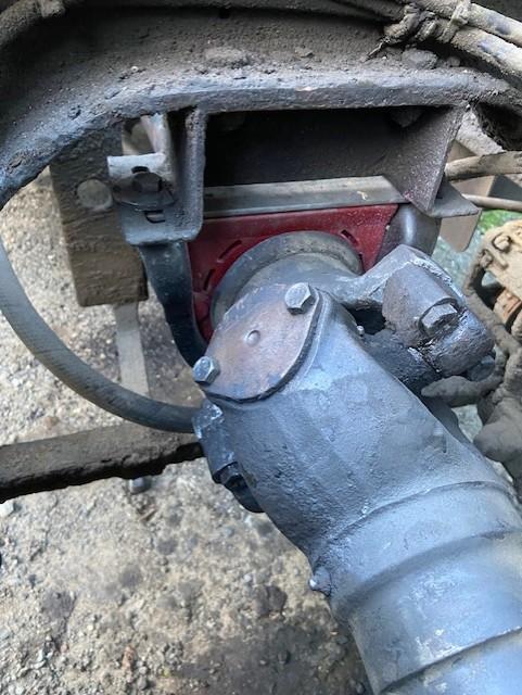

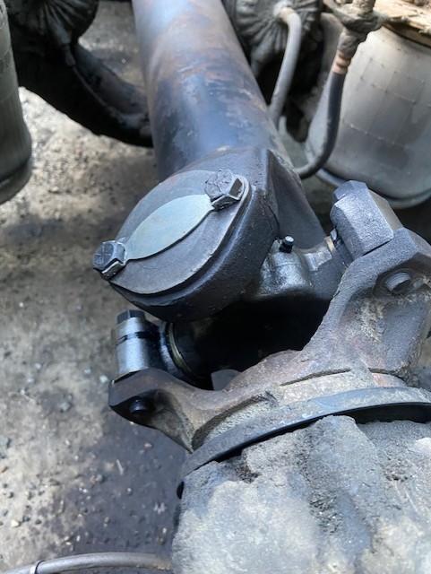

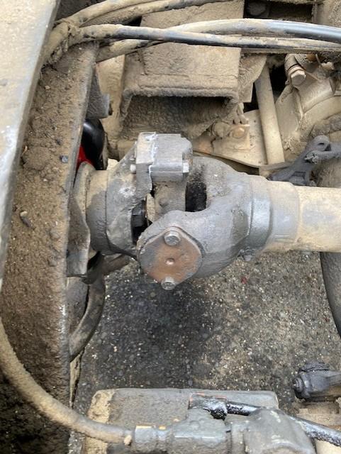

  1. To clarify it's a simple tri-axle dump, Mack 12 speed, driveshaft off the 12 speed to a carrier bearing then another driveshaft to the front rear, hence the 3 pics, then obviously a jackshaft as we call it here in the States that connect the 2 rears...
  2. Thanks guys this helps but now I'm a little more confused, don't take much lol ! Here is a little better explanation... Pics are as follows, 1 U joint off my 12 speed output shaft, TRTXL1070B to answer Joey LO LO air on the dash, 2 next U joint in line off the carrier bearing I replaced, 3 new $536 U joint I replaced connecting the driveshaft to the input of front rear... No slip yoke was disturbed in the process but obviously I had to pull yoke off the front shaft to beat the old carrier bearing off and clocked it wrong, hopefully that will cure my vibration... Ant thoughts ?
  3. I believe I clocked my U joints wrong when I replaced my carrier bearing, if this is incorrect would this be the cause of my strange vibration between 35 and 40 mph ? The U joint from the carrier to the front rear are clocked wing to wing press to press so I must assume what I did was wrong !
