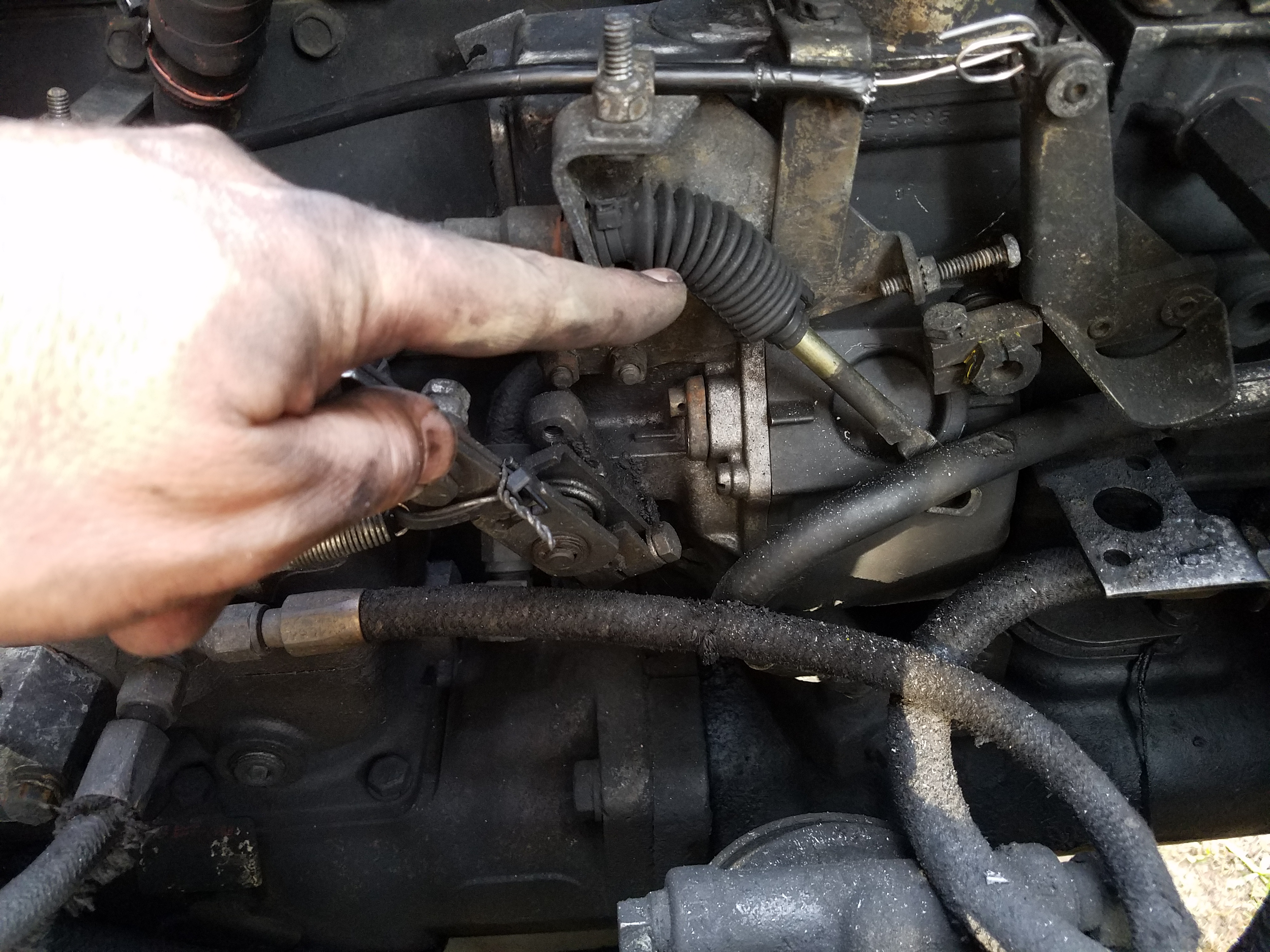

  11. Intersting idea. Its just long and the end appears to fit on the shut down rod beside the wire. Just don't see anything in the cab or firewall where it broke off at.

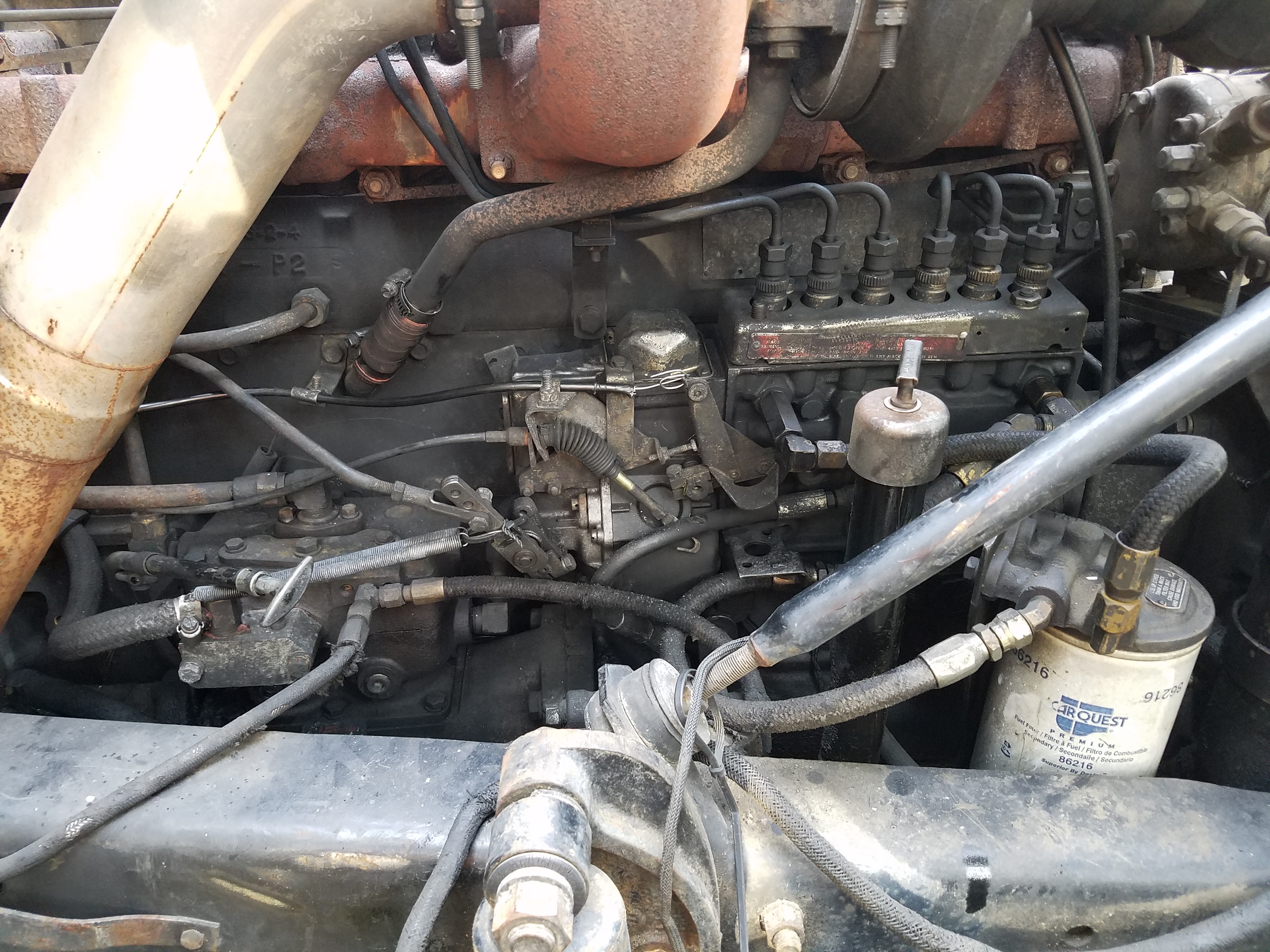

  12. Thanks. It just stumped me because I can't find the other end anywhere on the truck. Sorry I should have also stated it is a road tractor. Never seen a tractor with two kills before.
  13. Zoomed out picture .
  14. Going over my newly purchased 1988 Mack R with a 350 I found a cable unhooked and cut in half, its located just under my manual fuel shutoff cable by injection pump. What does it do and where does it connect. It looks important .

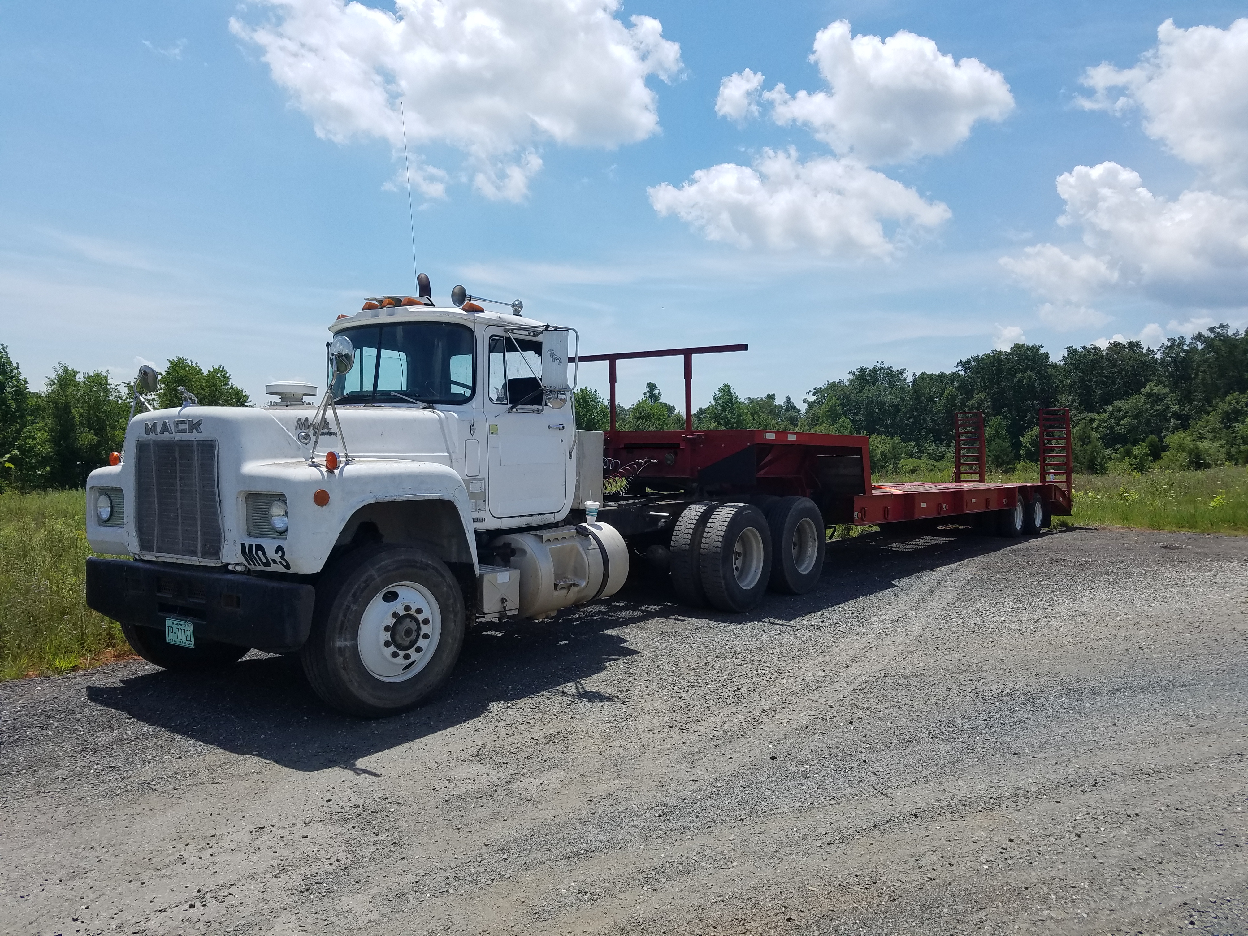

    Yeah, I just saw the owner for the first time a couple of weeks ago and she finally decided to take my offer on the combo. She wanted it to go with a detachable neck lowboy, but it was way out of my price range. Just happened that she had a fix neck too that was in my price range. I saw this other trailer which was just refirbed and I was sold. I'm excited as I was able to get my setup for a descent price and I can stop messing around with pickups& goose necks that I always overload! Its definitely a 25 footer, but its an R model that worked its entire life without being garaged. Really wanted a steel dash, but my CF will fill that void. Just put 100 miles on it today for fun. It runs out good, shifts nice. It runs out to about 80mph, that's exactly what I hoped. Now I can get on the freeway hauling my firetrucks and have no issues with speed. I just couldn't get my self to rip out the original 5 speed on my CF to make it go faster. It appears to have never been detailed or cleaned , so I have to give it a good cleaning. Change the fluids and replace the two aluminum rims on the front. Only thing I found that doesn't work so far is the air condition and the heated mirror on the passenger side. Other than that, I still going through it. Time will tell.

  21. I have been looking for a little while, but haven't pulled the trigger. Last month I was talking to a lady at a wedding, she said she had an old Mack out back. Her husband died, the trucks been sitting two years and the grandchildren didn't want it. So I said, I will take a look. Needless to say, she tossed a number out and I thought what the heck since its local. Its been driven, but I believe it was loved. So here's too my first tractor trailer! I picked this trailer up two days later, the stars must have aligned. I bought them quick, so hopefully I didn't make a big mistake. 1988 Mack R 6885st, (350 with a 9) and wetkit, pulling a 1975 SmithCo 40 ton trailer. I plan to pull my antique fire engines and farm tractors with it.
