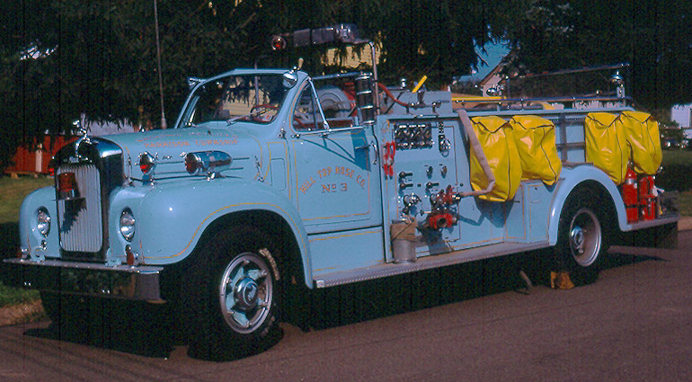

  23. The truck is now in vancouver. Truck was originaly from natrona heights pa (about 15 minutes from me) The owner in colorado sold the truck to a guy up in vancouver. I talked to one of the previous owners at the spaamfaa national meet in minnesota. From what it looks like the owner now has intentions to restore the truck and looks like he is keeping it.

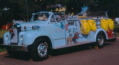

  24. The truck is now in vancouver. Truck was originaly from natrona heights pa (about 15 minutes from me) The owner in colorado sold the truck to a guy up in vancouver. I talked to one of the previous owners at the spaamfaa national meet in minnesota. From what it looks like the owner now has intentions to restore the truck and looks like he is keeping it.
