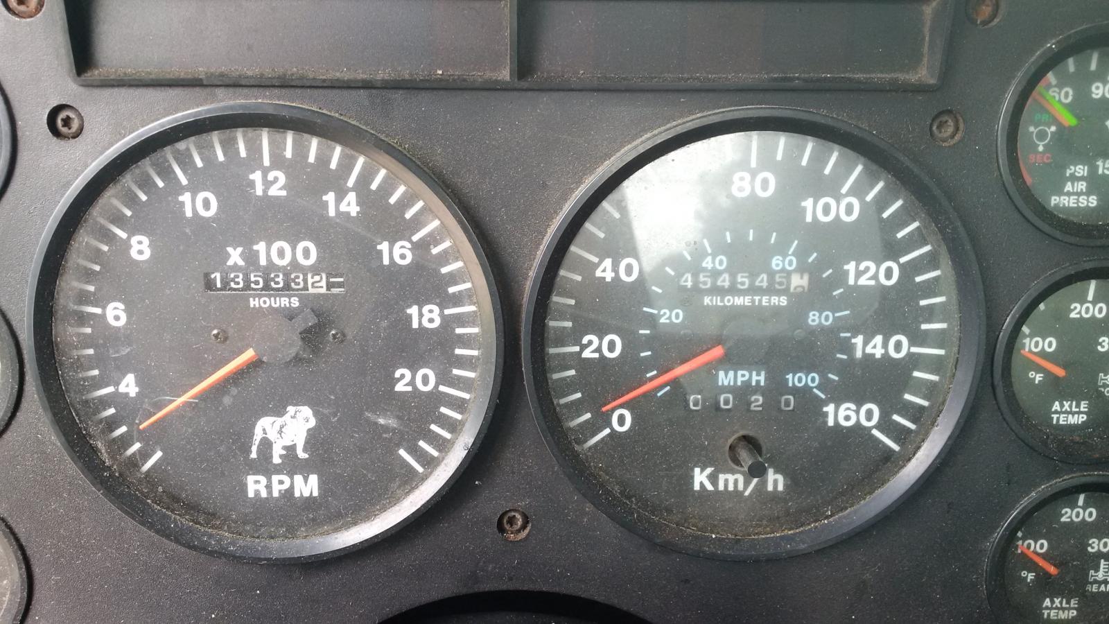

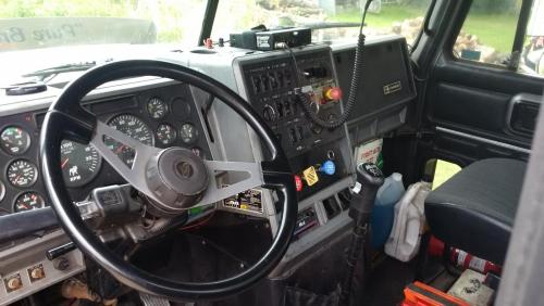

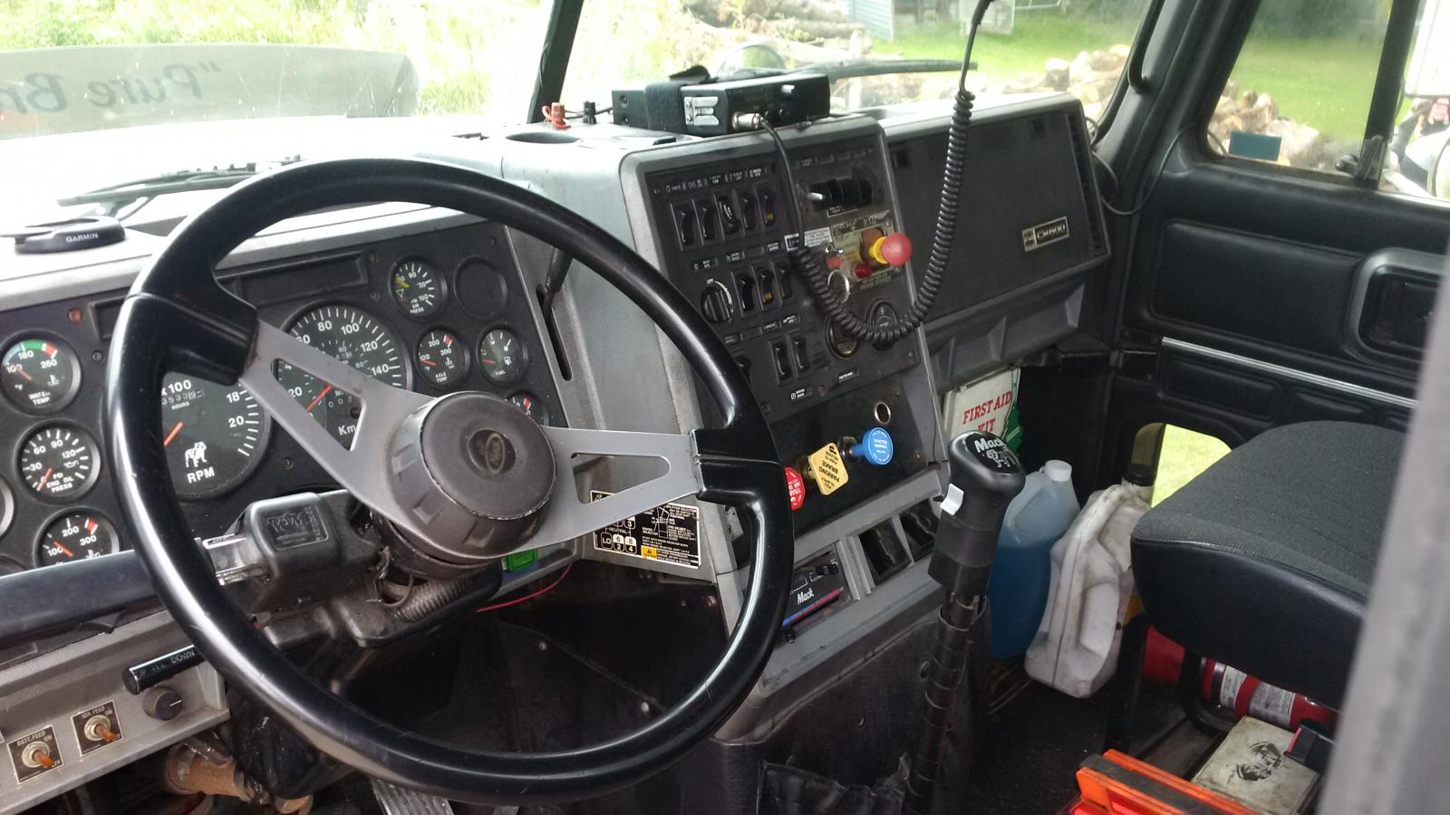

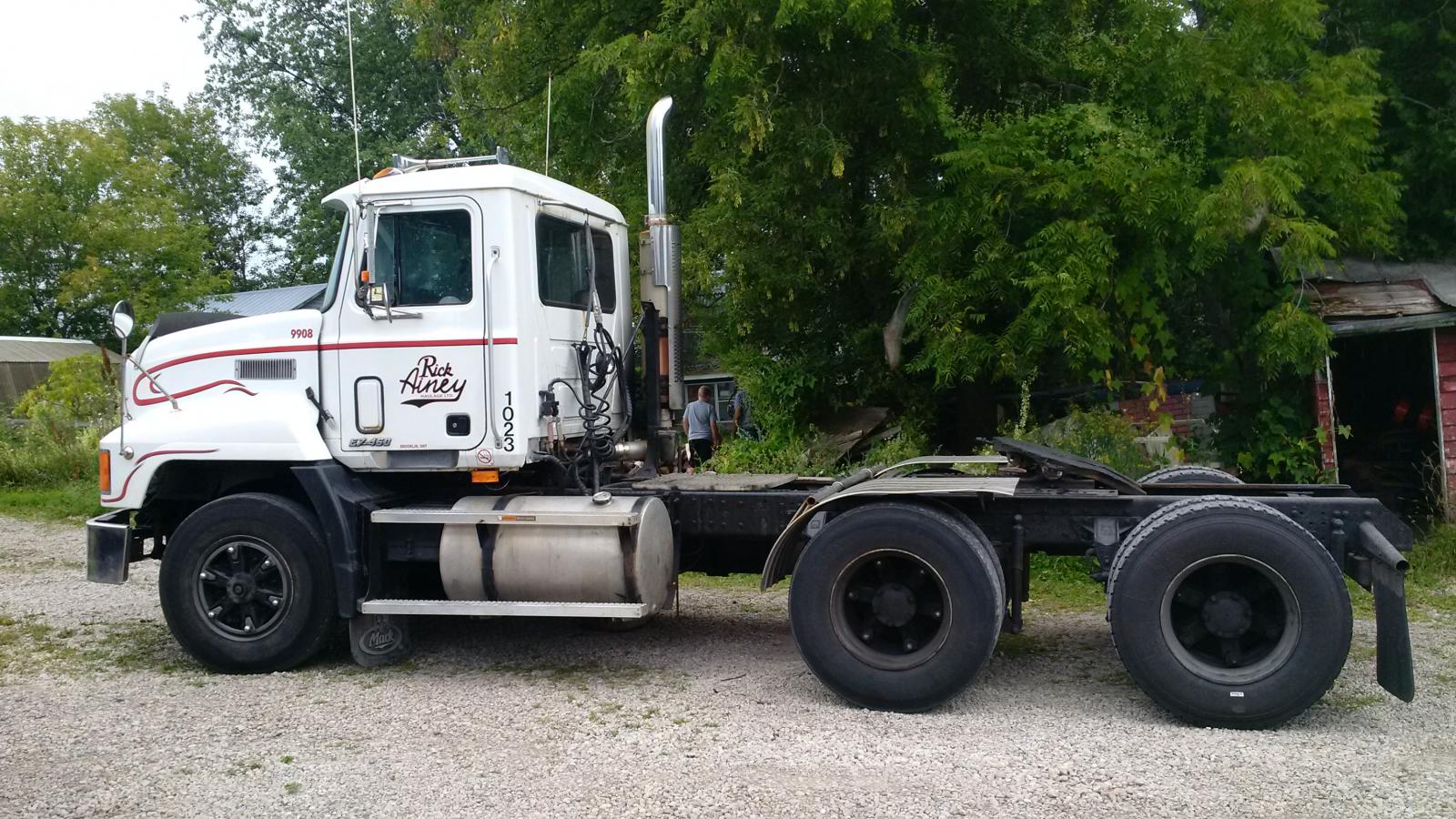

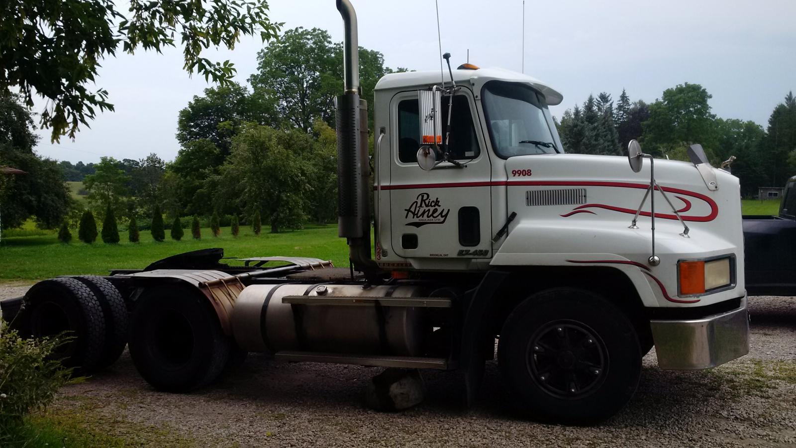

  1. I've got a 99 I'm thinking of purging... 460 etech 18 Speed Mack trans. 14F 46R on air 435 rear ratio Mack axles.
