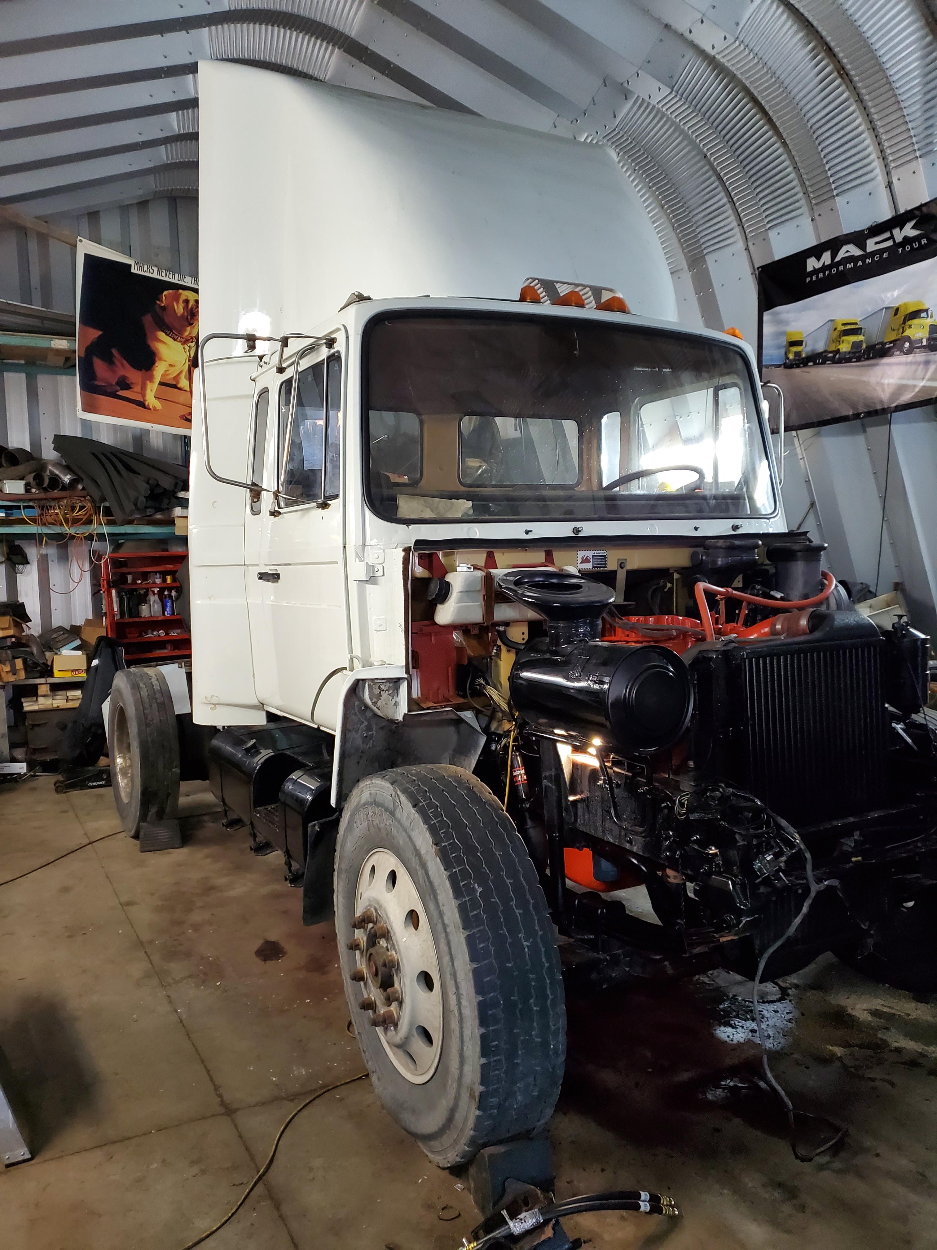

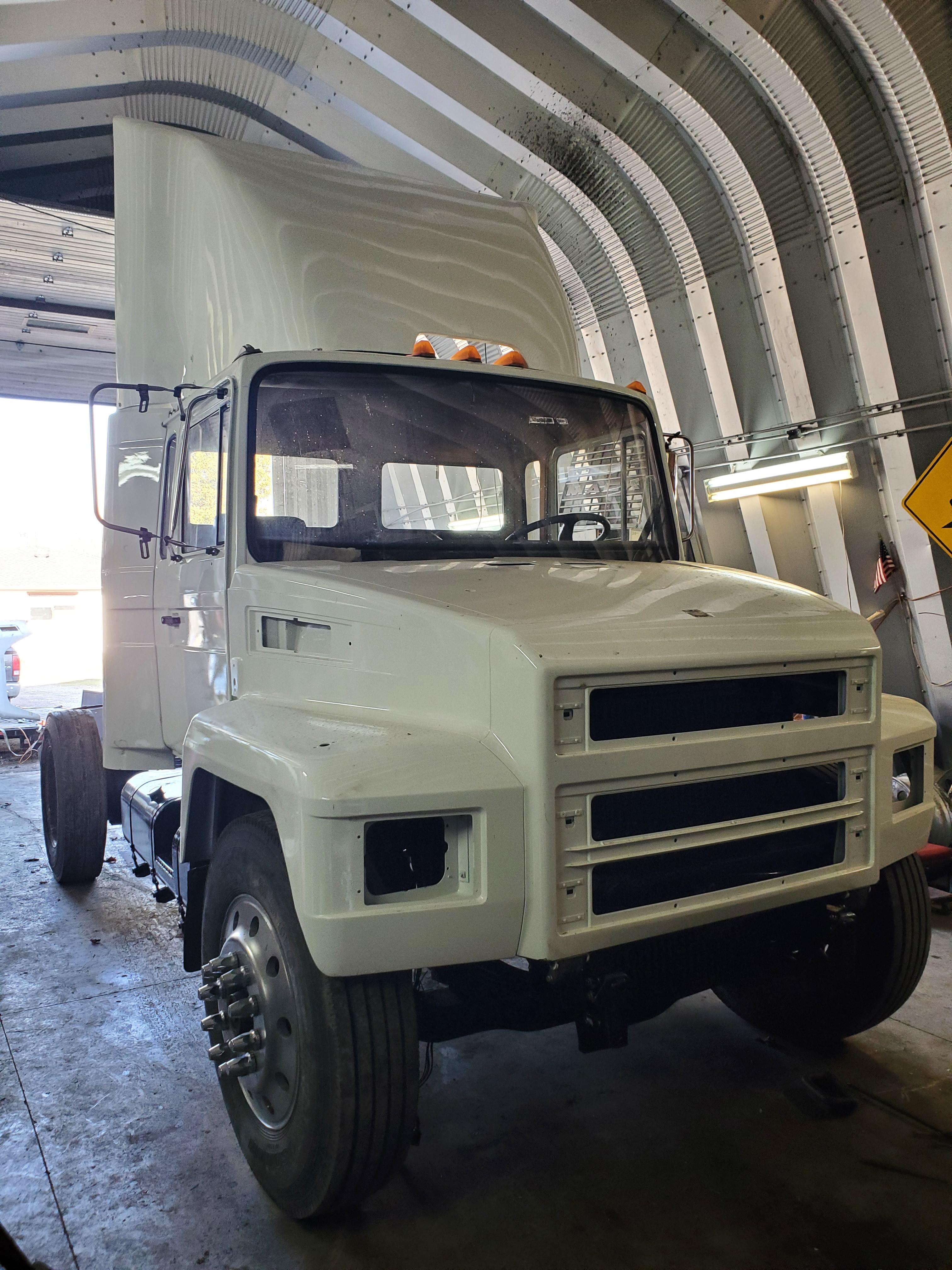

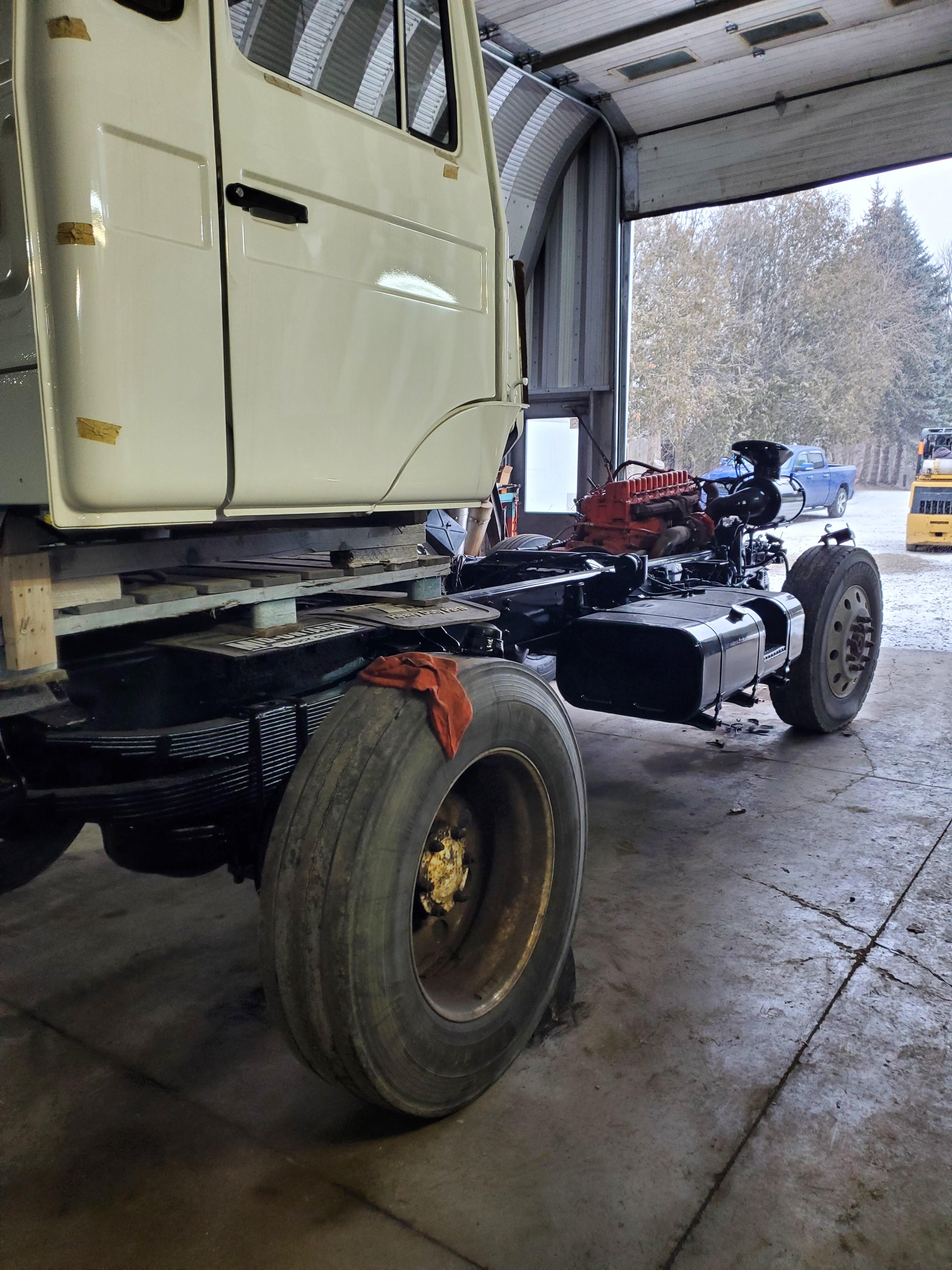

  8. We changed out the spoke wheels which it was built with to Hub Pilot aluminum disc wheels. Easy to do as these are Mack axles and hubs are readily available. (Mid liners never had spoke wheels as an option) Same wheel track as Mack R as same axles used on both models. The baby 8 was built to be smaller and cheaper then an R model but heavier then a Midliner. It was only available from 88 to late 89. Just over 600 CM422 (single axle Renault power) were built. Cab mounts were same as Midliner but bolted to Mack Frame rail.

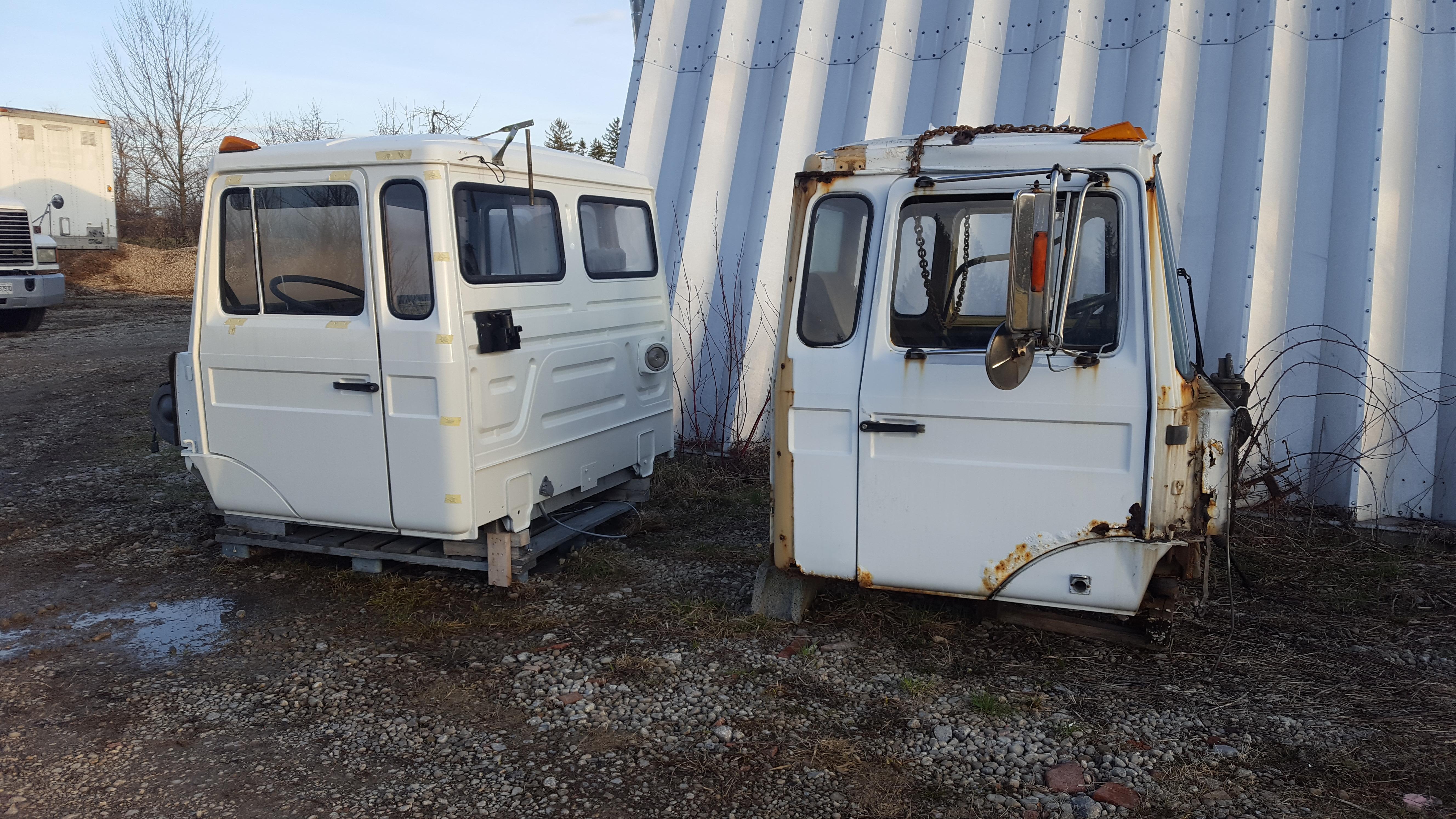

  9. The frame is "basically" the same as the CH. (Not Renault) the crossmembers are older single frame R model Axles were Mack front and rear and available in either spoke or stud pilot wheels (alum or steel) Engines were Renault (E5) or Cummins 8.3L Trans was Spicer or Fuller 7 and 9 speeds Besides the engine option cab shell and some interior parts, hood, everything else on the CM was Mack. For those that have seen Midliner wiring/fuse panel, they will recognize the picture I posted of the CM fuse panel. Complete air system is North American. Big difference.

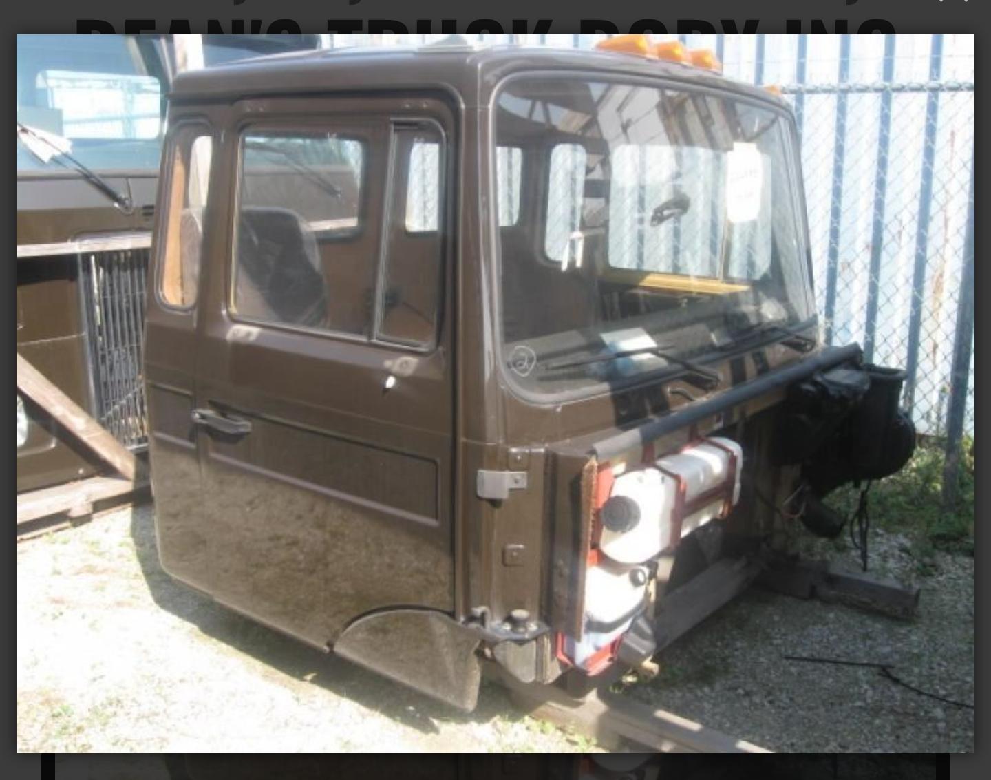

  13. The Brown Cab is a fully dressed UPS cab built up as part of the order for 5 CMs for the New York area which they didn't keep very long. This cab sat in an Ohio warehouse since 1989. It was even equipped with the UPS mirrors. Probably the only CM fully dressed cab in existence. CM and CS cab shells are the same but the inside wiring, gauges and air system is all CH/R Mack parts. To fit a CS cab for a CM is a crap ton of work. We got extremely lucky on this one.
  14. This is not a (Renault) Midliner CS. This is a Macungie PA built CM422. Different trucks.
  15. This one is a CM "Baby 8" not a CS. 2 very different truck models offered by Mack. Less then 600 of these CM422s built at Macungie PA.

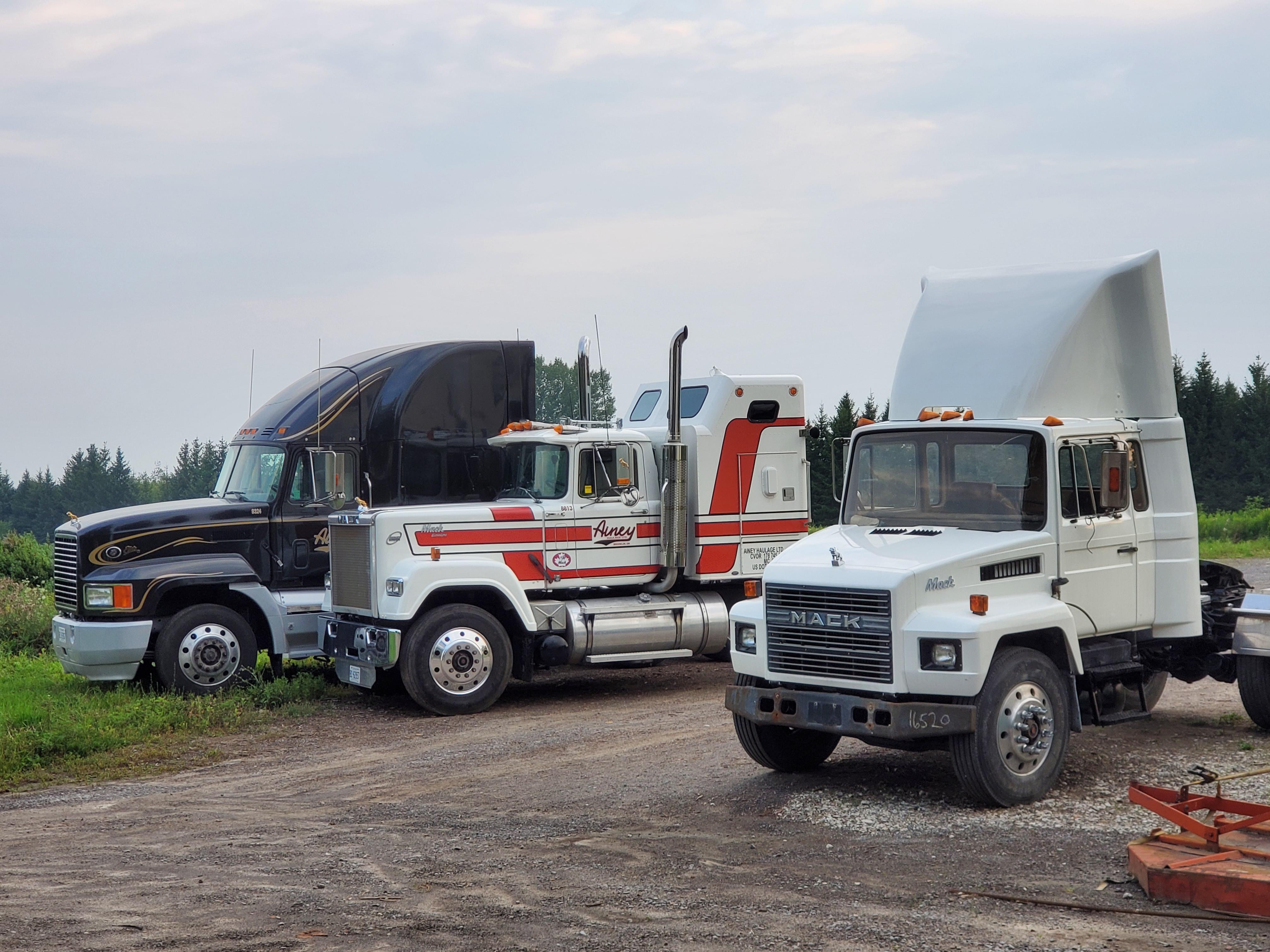

  16. This CL is one of the few CL Elite Limited Editions built. (Less then 150) My one has the E7400 instead of the E9 that was an available option.
