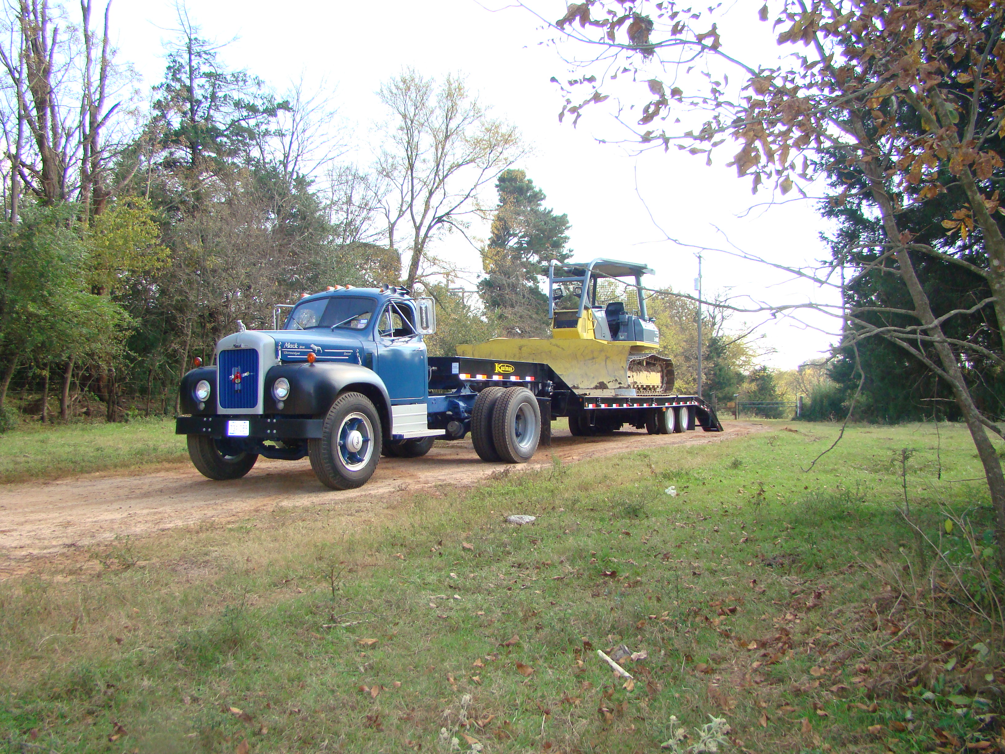

  12. Well Rob, may not be any parts for you after all, I made the longest drag to date with ole killer B today, 48 miles one way, and she just purred all the way up and down the hills with komatsu dozer riding her. I was a little wore down when i got there but it sure was an enjoyable trip, may just keep her doing dozer duty after all,,,randy

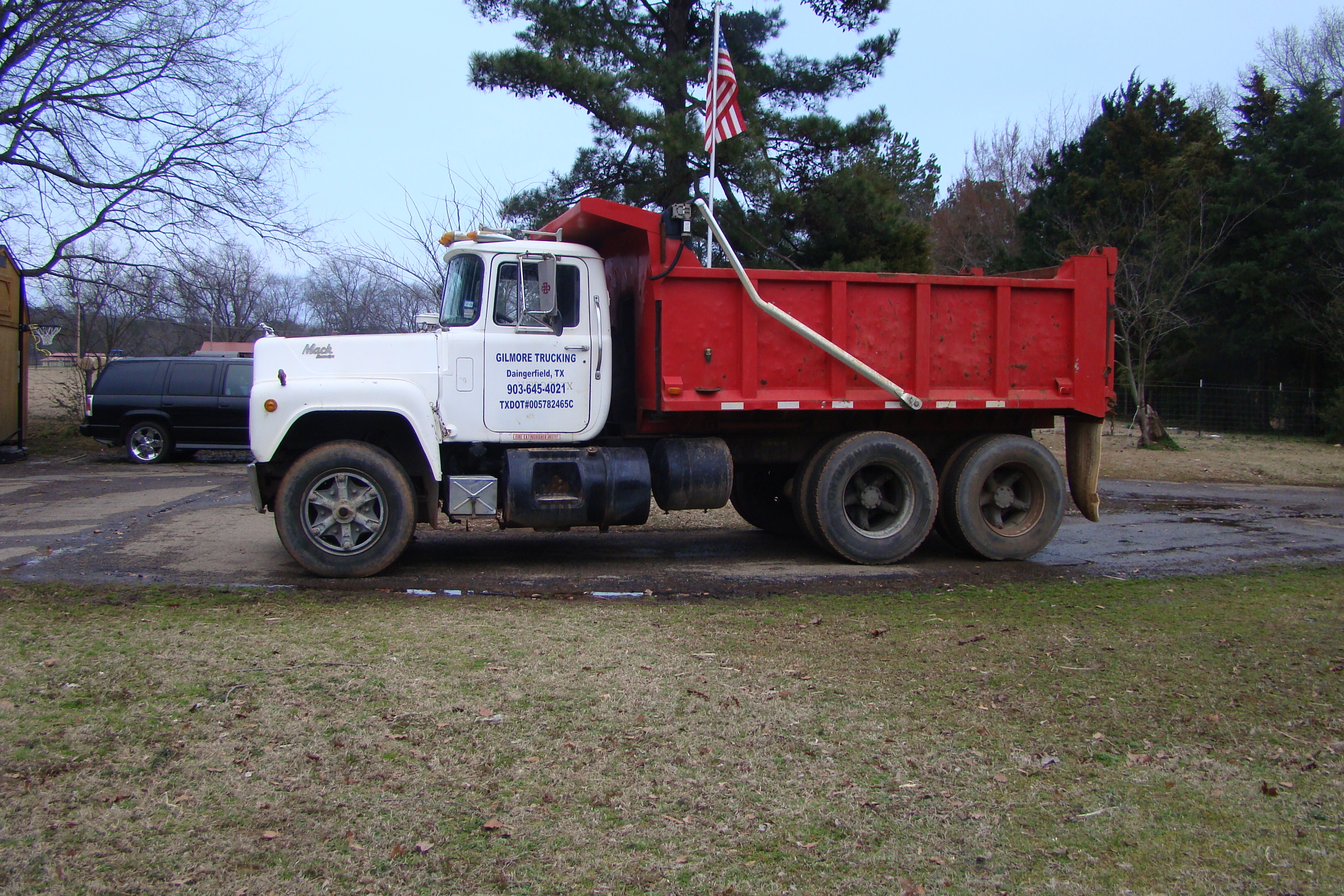

  17. Thanks guys, I had a hard time with a state trooper who just didnt wanna buy into no factory seat belt story, he wound up on his cell phone getting another ruling, finally got off phone shaking his head and said your legal, you can go, but i dont like it. While you are here, Vanscott, i bought a 1986 mack R-600 dump truck with 14 ft. bed. Behind the cab across the top of frame is big piece of steel,,welded to front of it extending under back of cab it has 2 small air bags with a short shock absborber on each side, there is a cover over it in cab of truck with 2 large bolts looking like they praobably go through center of each bag. Leveling arm is unhooked right now, when i moved it to cycle air to bags (cab is sagging back away from hood right now),,both bags are leaking pretty good, i guess thats why they had leveling arm unhooked. My question is how hard are these to get out and replace,,go from inside cab at top or underneath? thanks,,,,randy

  23. heres killer b getting ready to earn her keep
