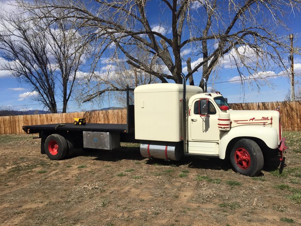

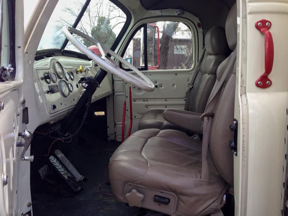

  2. Restored this B model mack back in 2015. Driven a handful of times. Just had it serviced this last year. Does need rear tires (weather checked) Started as a B-53 Original END-672 Sleeper from Peterbilt extended the frame, and rear end from a 1972 GMC Kodiak Many little upgrades, all-new rear brakes Quadruplex with 2 speed rear end. Always starts right up. Please let me know if you have any questions. Good looking unique truck. I am asking 14K for it. But open to offers.

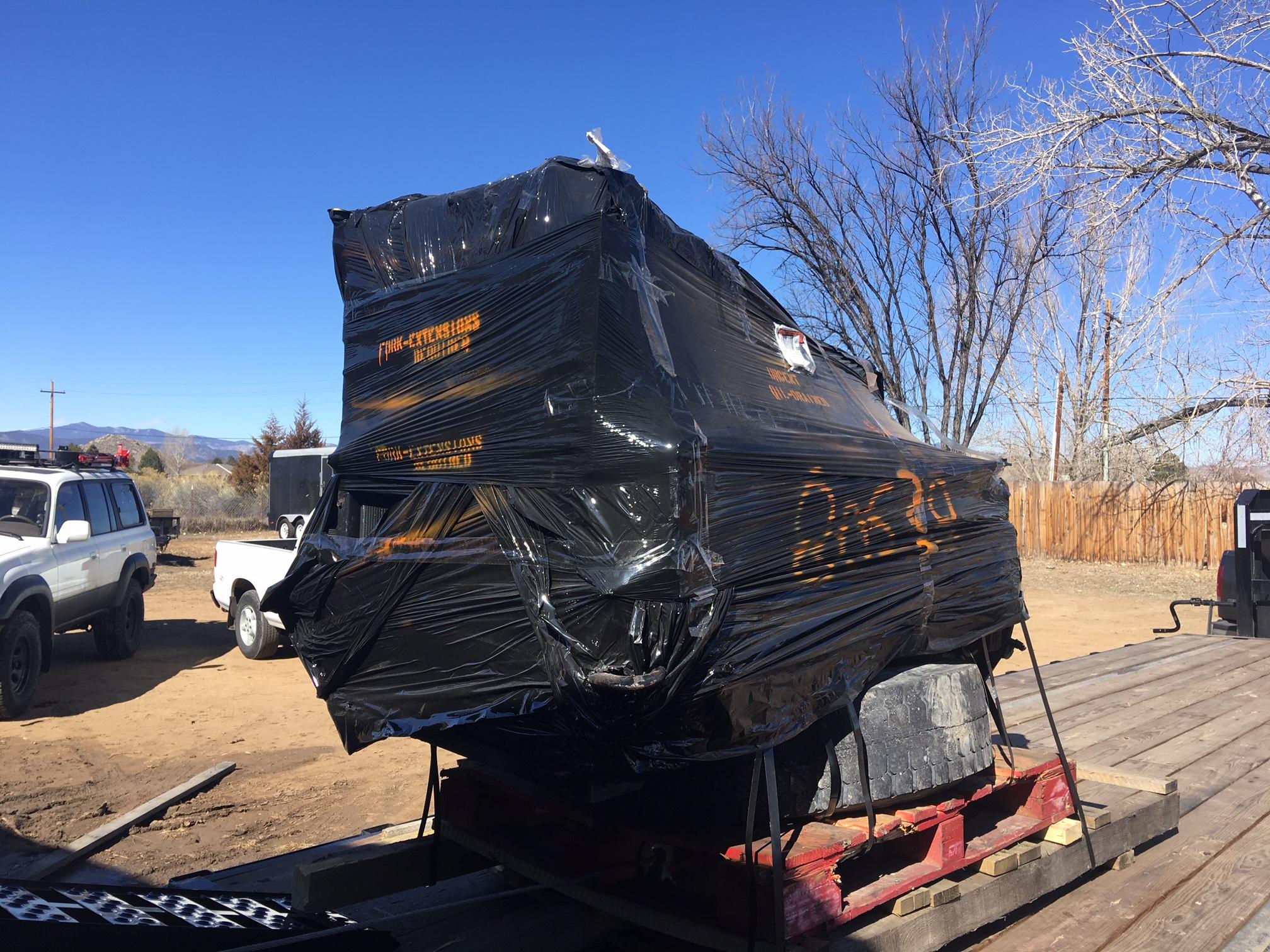

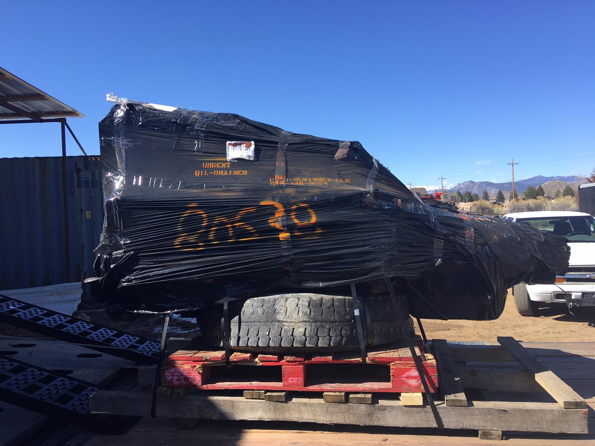

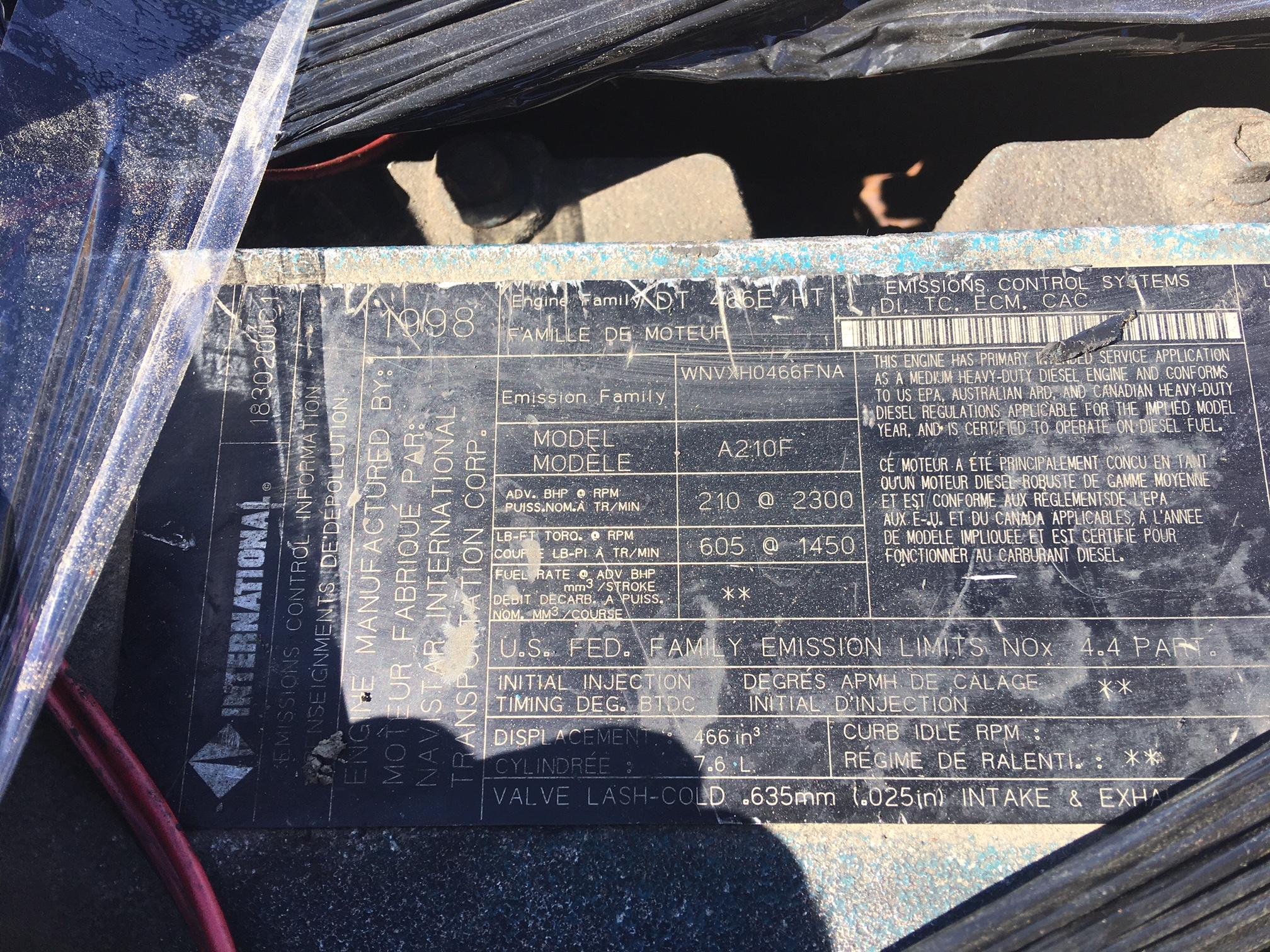

  3. 1998 DT466 complete, good used, not a core. Bought this frame cut all wired running motor with the intent of putting into my B. I've decided to go a different way. Engine is complete, wiring, turbo, radiator, everything. See link below to see the motor running before it was shipped to me. https://youtu.be/7MYACBMUA8k If you're in the Colorado / Wyoming Area I can look to help deliver.

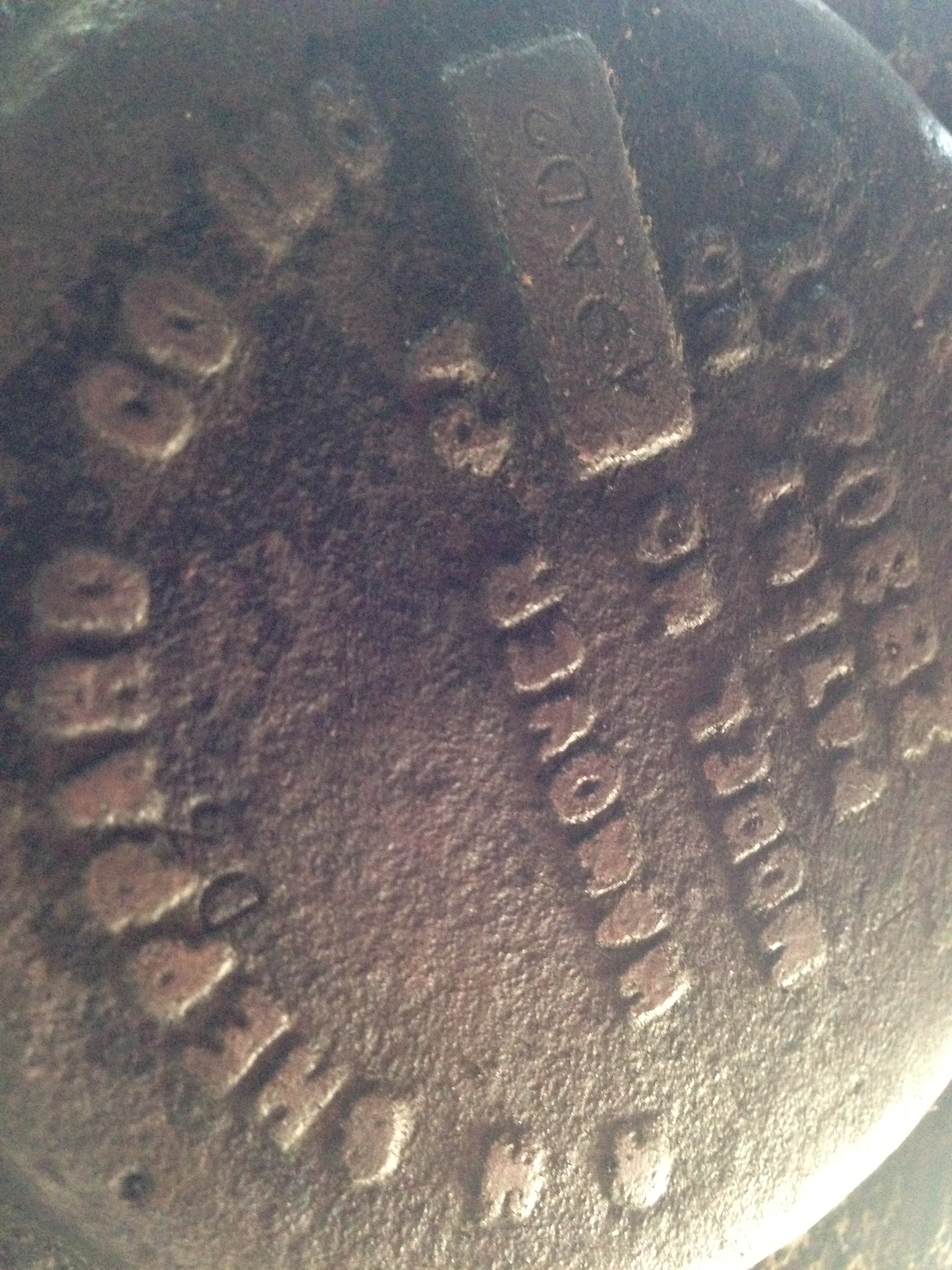

  8. I was just looking through my albums to see, and I don't think I do. I will need to take some. Only ones I could find are the pics I took of the steering box end cap to get the model info from. Will need to take some pics...

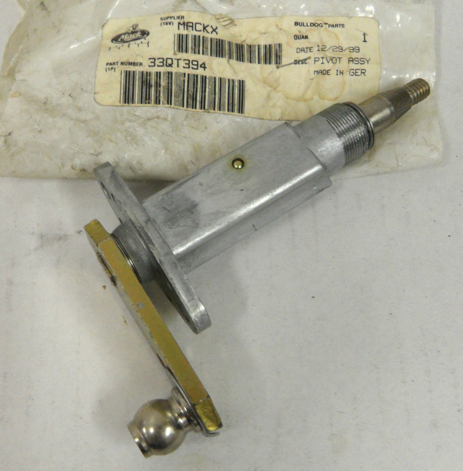

  13. Hello! I am need of some wiper parts for my B model. What I need is the wiper mounts (wiper pivot assembly) that mount on the cab. So far all I have found are the modern ones, need a right and left on for my B. I have a good motor, and linkage, just need the pivot assemblies. Thanks! Here is a picture of the modern versions, but give you a idea of what I am looking for.
