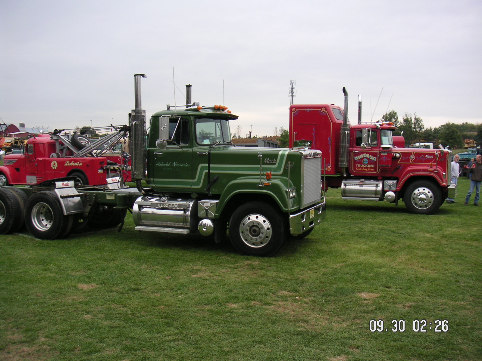

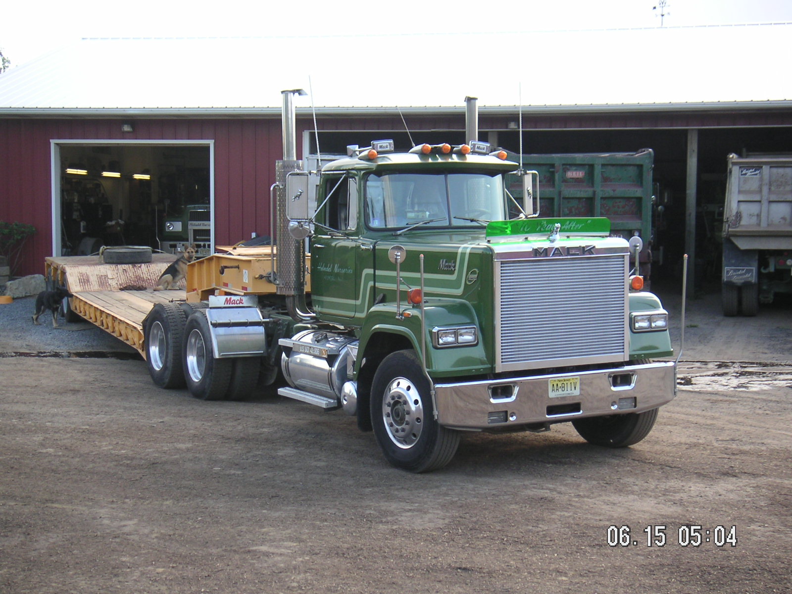

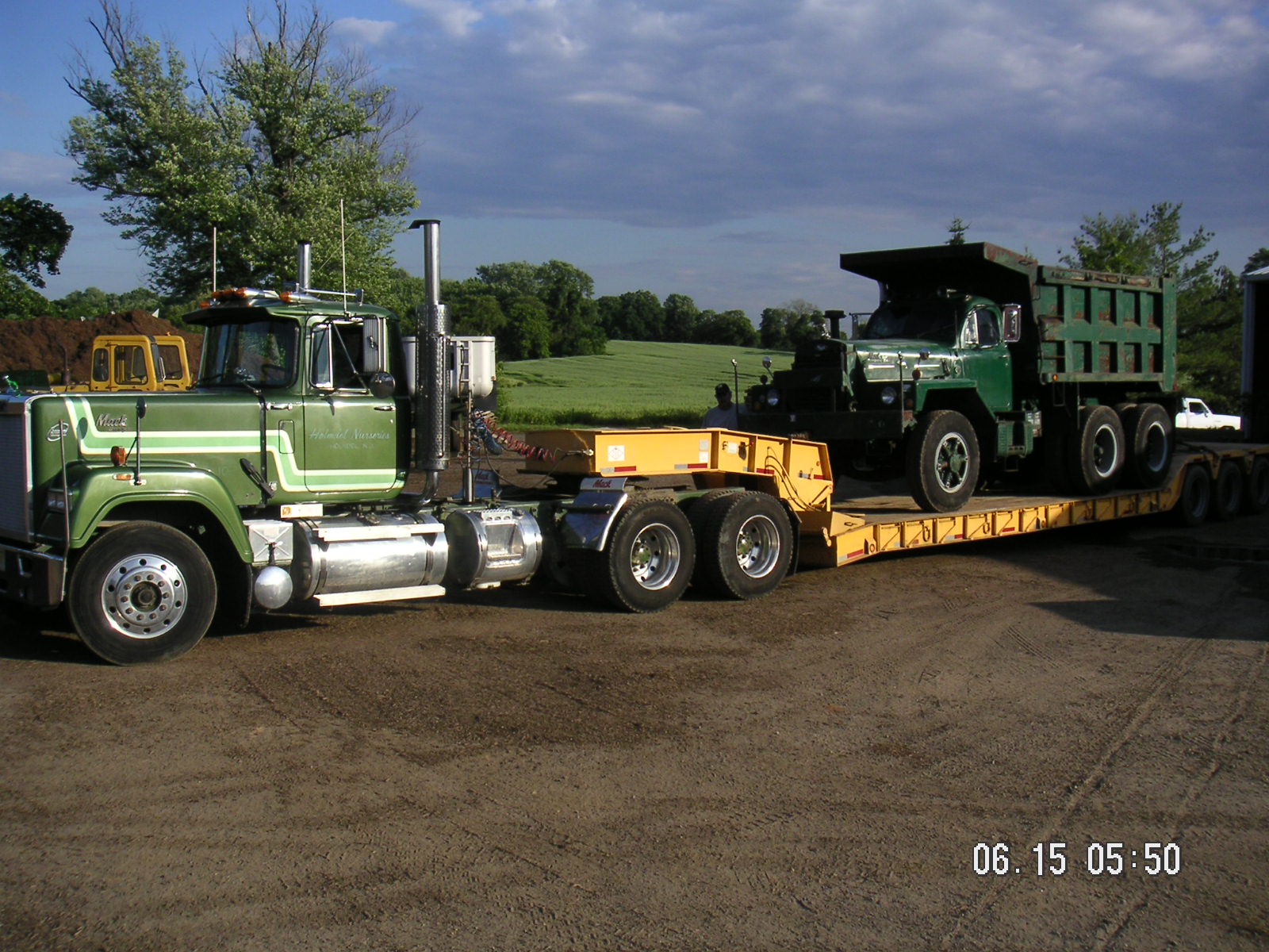

  8. was that color sceme your design or was that a companies color sceme ? Pretty neat, not to knitt pick but you need a set of bulldog mud flaps(like what Barry sells) in place of the car quests! Nice truck tell us more about it
  9. So NYC DOT had some of these crew cab r's in service as dumps etc? Being from NJ i would have thought I would have heard of one so I guess they didnt have too many. Boy some more pics of these trucks would be cool(like seeing one pic of a crew cab r isnt cool enough)
