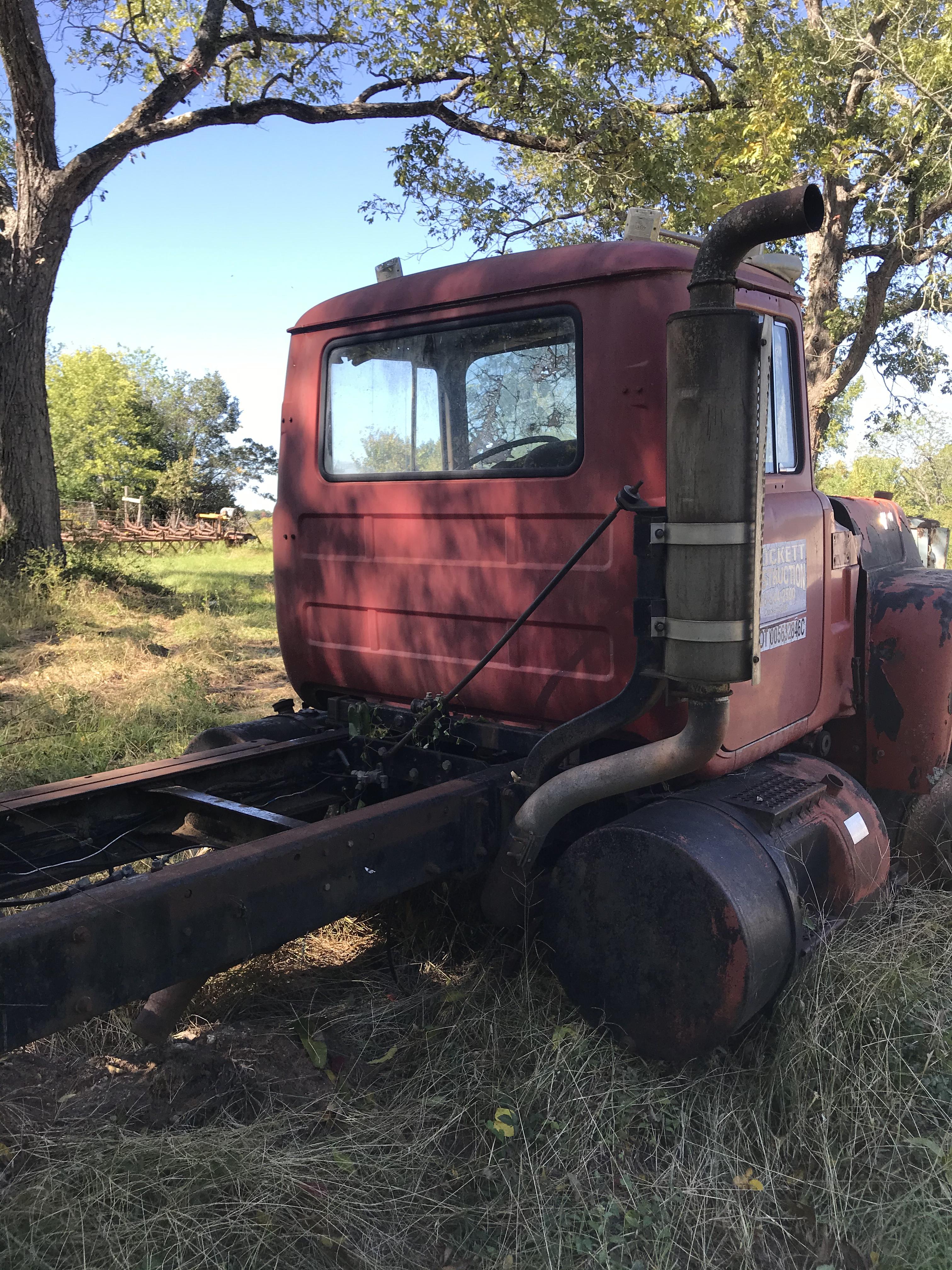

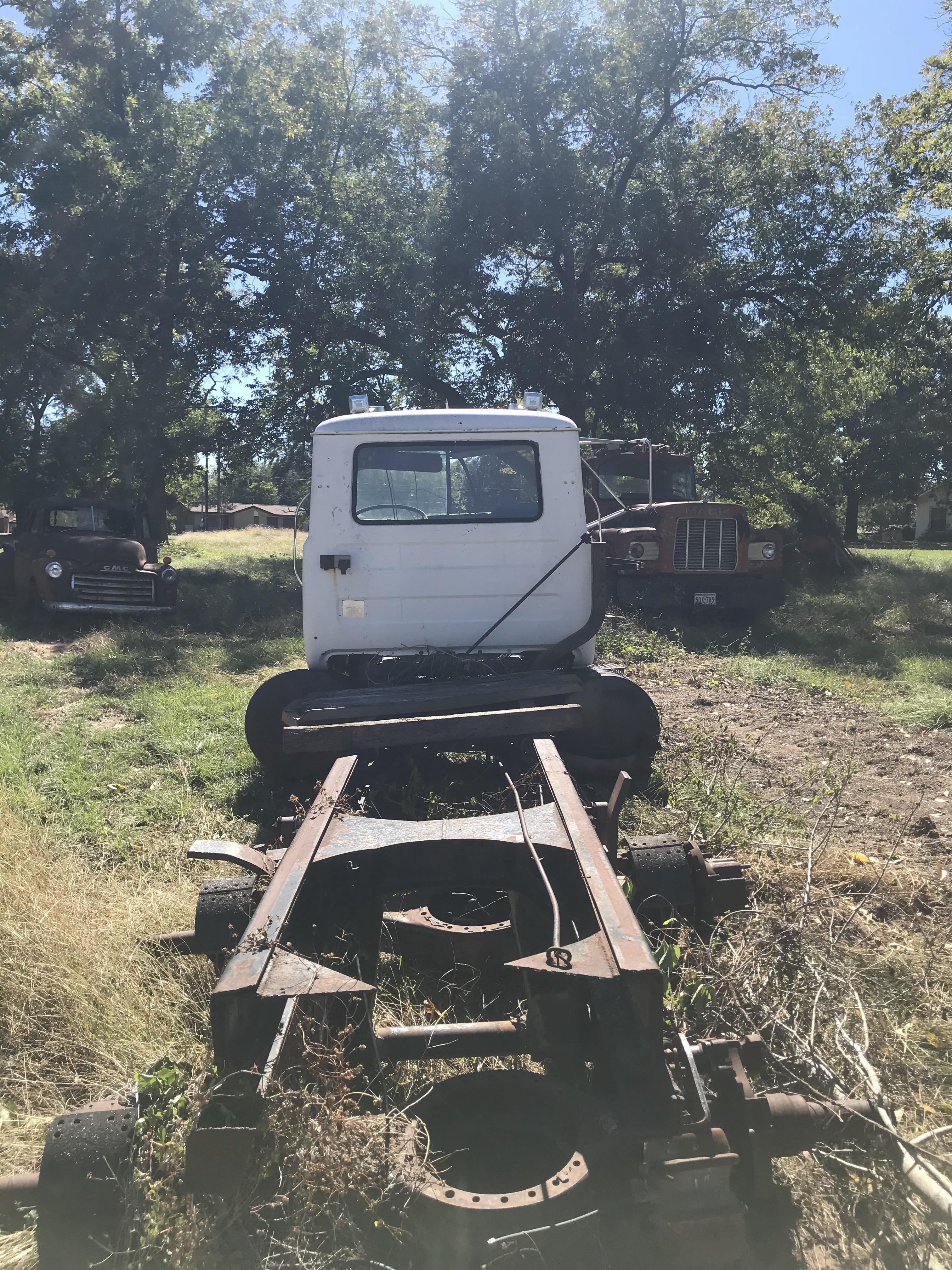

I have two mid 80s R model cabs and frames. Red one appears to be 1985 very clean rust free cab and double frame. Cab appears to be the galvanized base metal. Good doors. Has E6 300 4V short block , 6 sod, radiator and charge cooler. Decent rebuildable hood. Has steer axle in place. No rear hubs of third members. White truck is late 80s . No drivetrain . Front springs only. Rear hubs and third members have been removed. No drivers door. This cab is very clean and rust free. Double frame with no rust. Asking $2500 obo for the red one. $1500 obo for the white one. located in Crockett Texas. For more photos message me with your email address.
