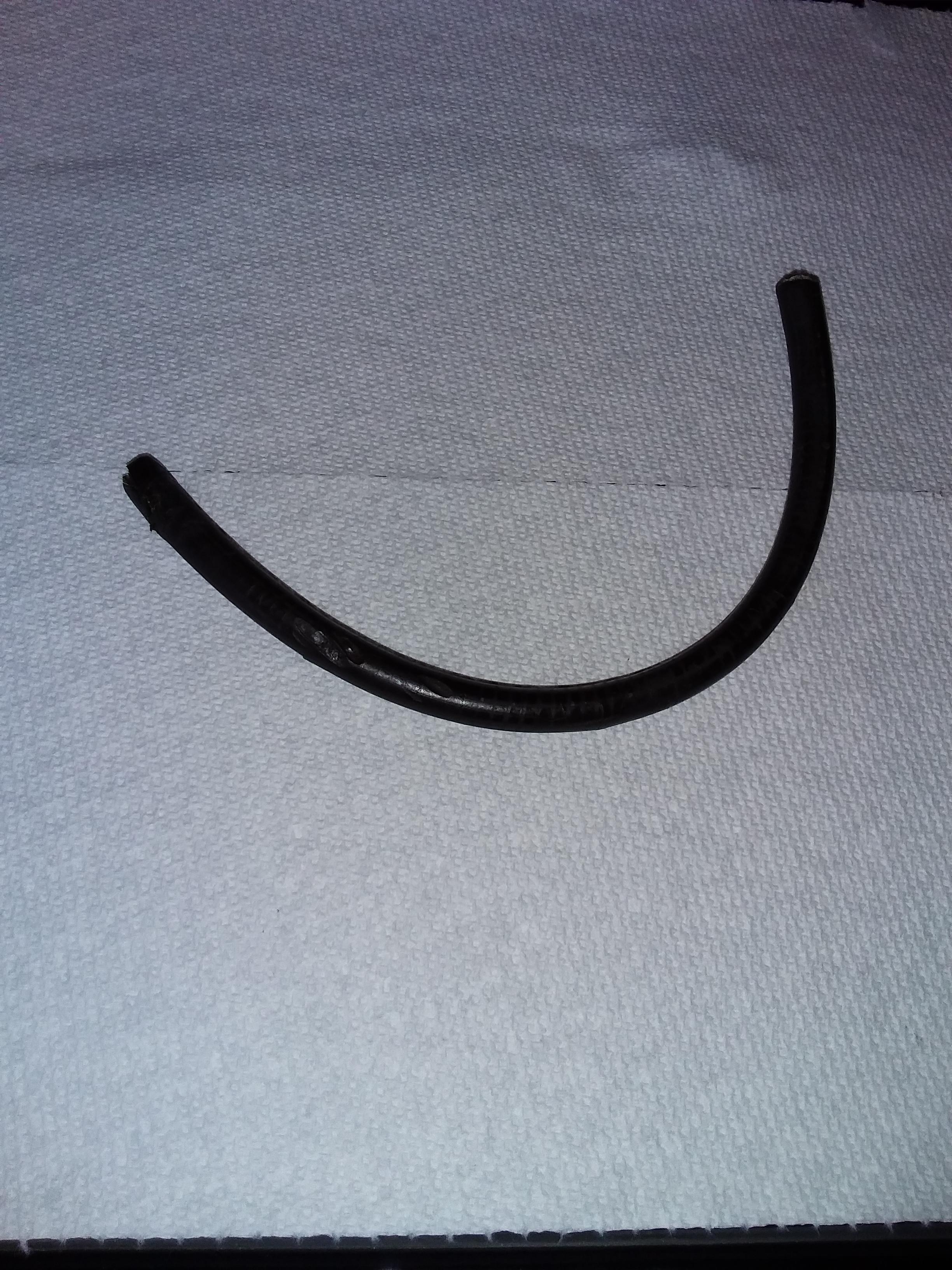

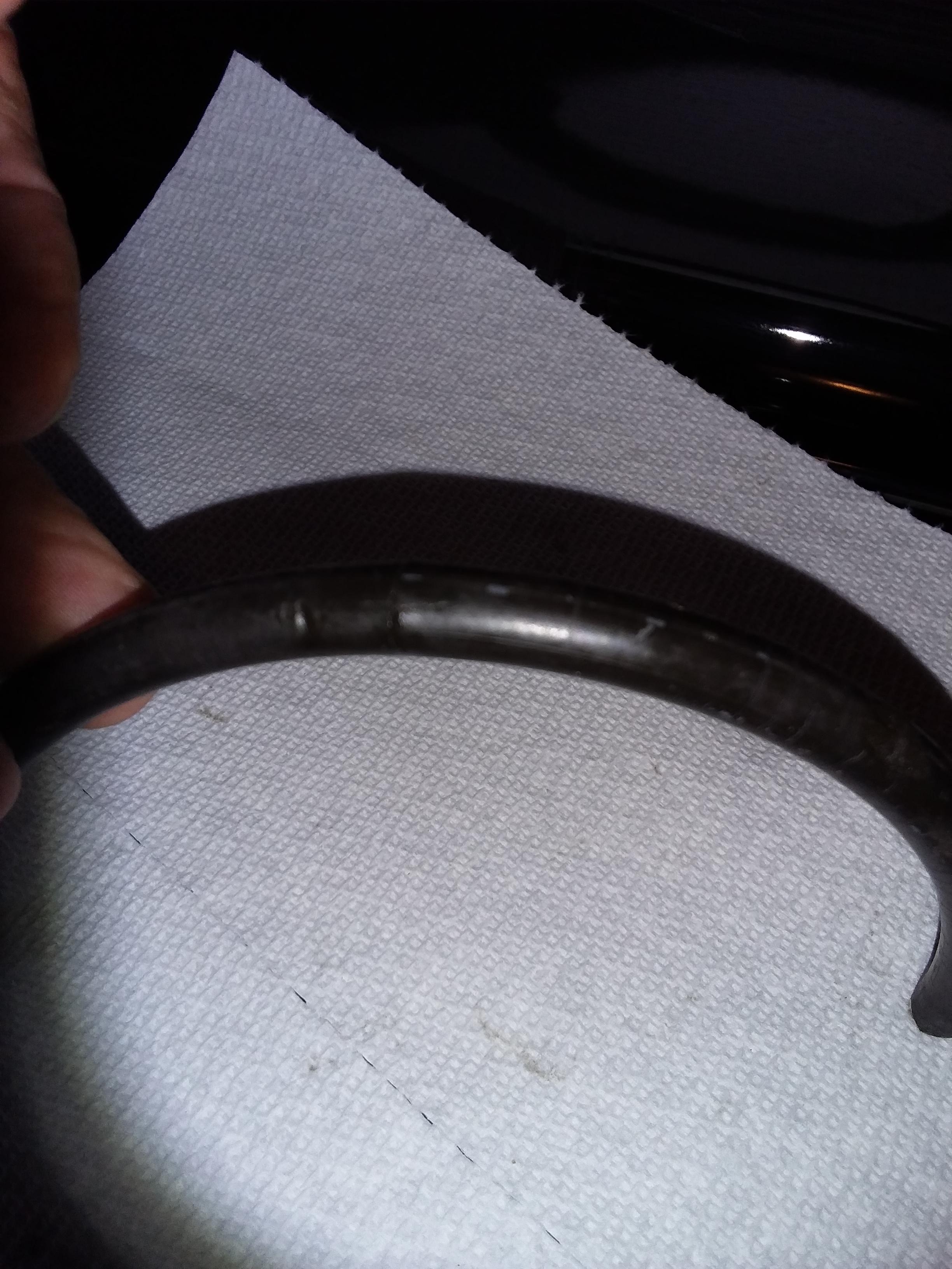

  1. Well changing that hose didn't fix it but no problem the hose needing replacing anyways. Took a closer look and found a cracked small plastic line. It was shot. It was connected to a banjo bolt with tees on the driver side of inj pump and went to a fitting on the passenger side.. I attached a couple pictures you can see the wear and cracks. Thanks everybody for the help
  2. Ok got a chance to take a look and noticed the line coming from the injection pump to the one side of the secondary fuel filter was cracked up. Replaced it and gonna give it a couple days to see if that fixed it. Will post if that cured things. Thanks

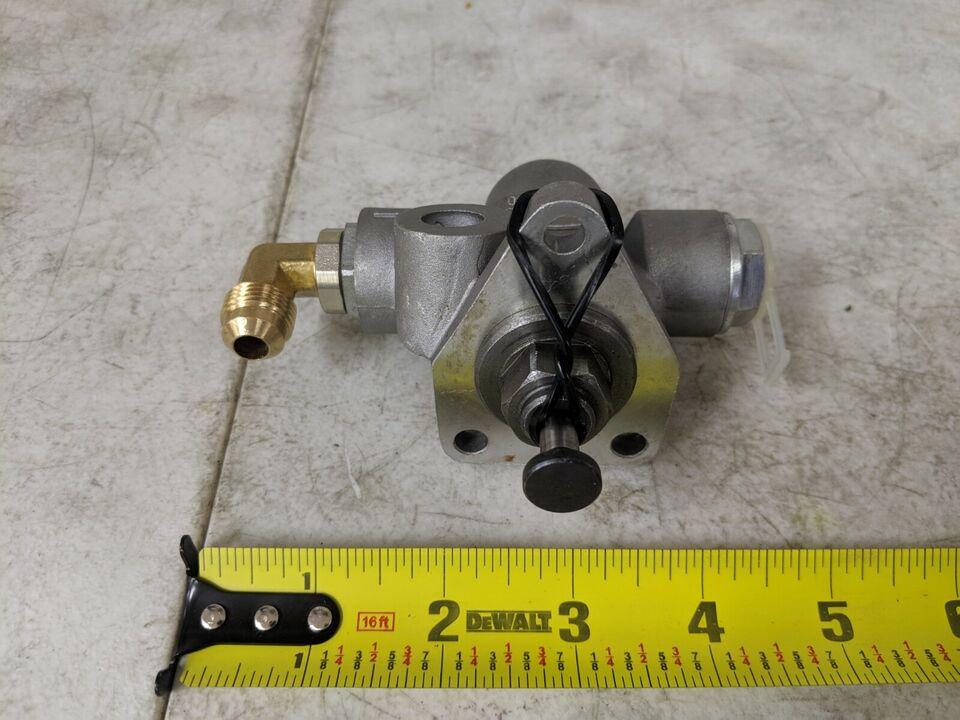

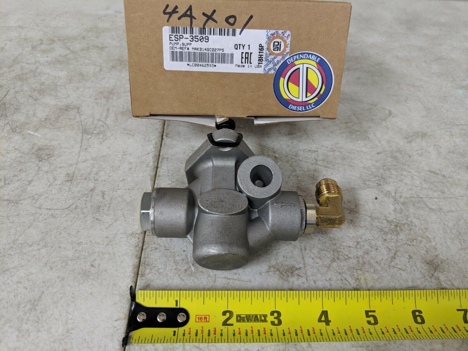

  8. Here is what it looks like. Its from ebay Thanks
  9. Got my 96 mavk with a e7 engine. Any advice on replacing the fuel supply pump. Pump has 2 lines and is mounted on the side of the injection pump and is secured by 3 bolts. Any advice is greatly appreciated Thanks

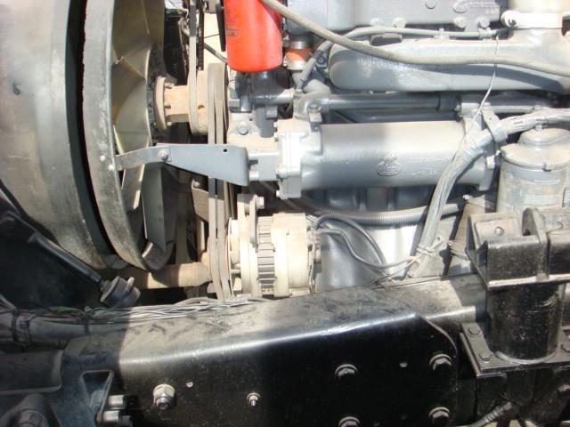

  13. Developed a oil leak on my cooler. I am not familiar with a oil cooler and therefore any help is greatly appreciated. Does oil or coolant go thru the small tubes on the core? Also in the pic is that (about 1 in or 1.5 in) steel line above the cooler oil or coolant. I think that is where my leak is. I believe there is a couple of o rings and a gasket there. Again any help is greatly appreciated. Thanks
