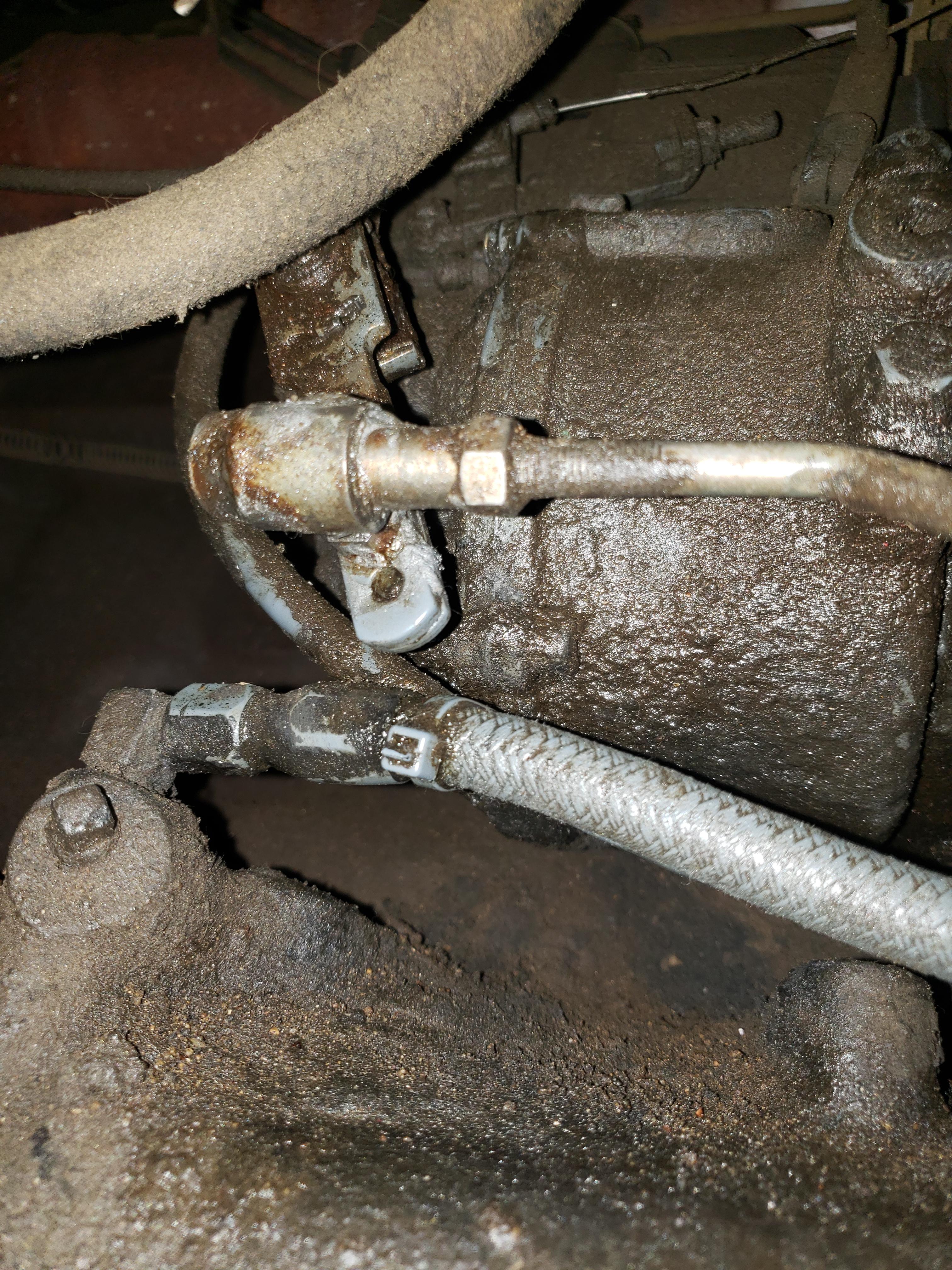

  1. Well changing that hose didn't fix it but no problem the hose needing replacing anyways. Took a closer look and found a cracked small plastic line. It was shot. It was connected to a banjo bolt with tees on the driver side of inj pump and went to a fitting on the passenger side.. I attached a couple pictures you can see the wear and cracks. Thanks everybody for the help

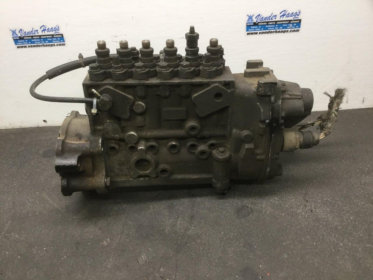

  18. Found this pic online. I believe i may have leak at this fitting on the side of pump. I got this pic online and my pump seems to be leaking at the fitting pictured with the zip tie. What is this and can it be fixed without removing the pump? Thanks

  24. got what looks like a oil leak developing on my fuel pump. there is a short approx 12 inch braided hose that comes off the side of the pump that looks like it needs replacing. my question is does it have to be a braided hose and is this a oil line? thanks
