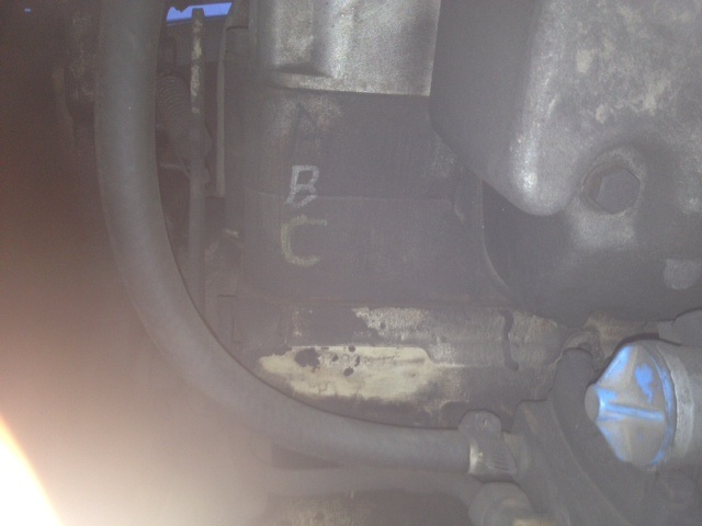

  2. The numbers are stamped on the left side of the engine block, right below the head.
