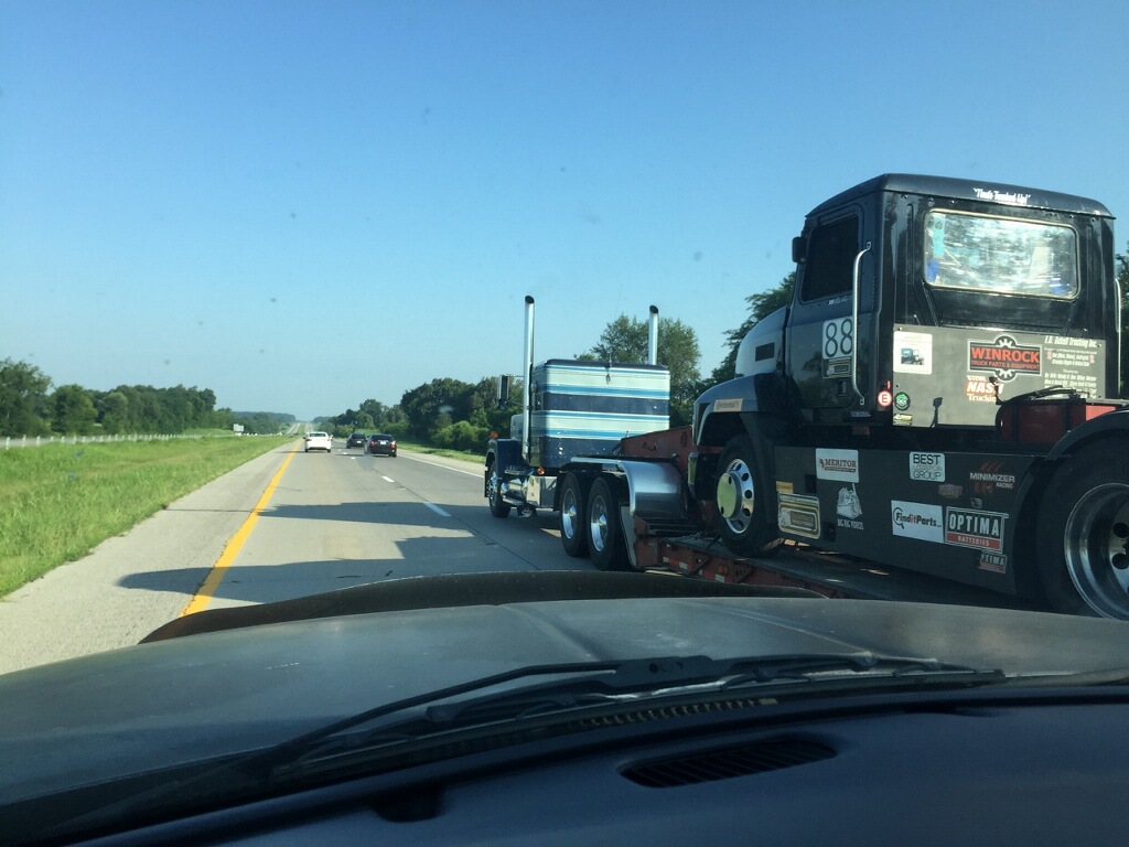

  19. Headed to St.Louis last week, the dog ran good, the race truck too!
  20. Well Paul, I'm happy on my end, I got one of a kind Flaps in the US,lol.
