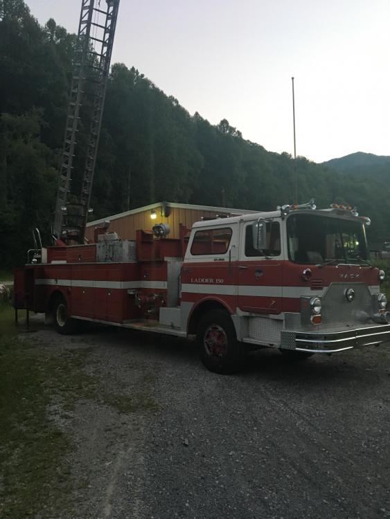

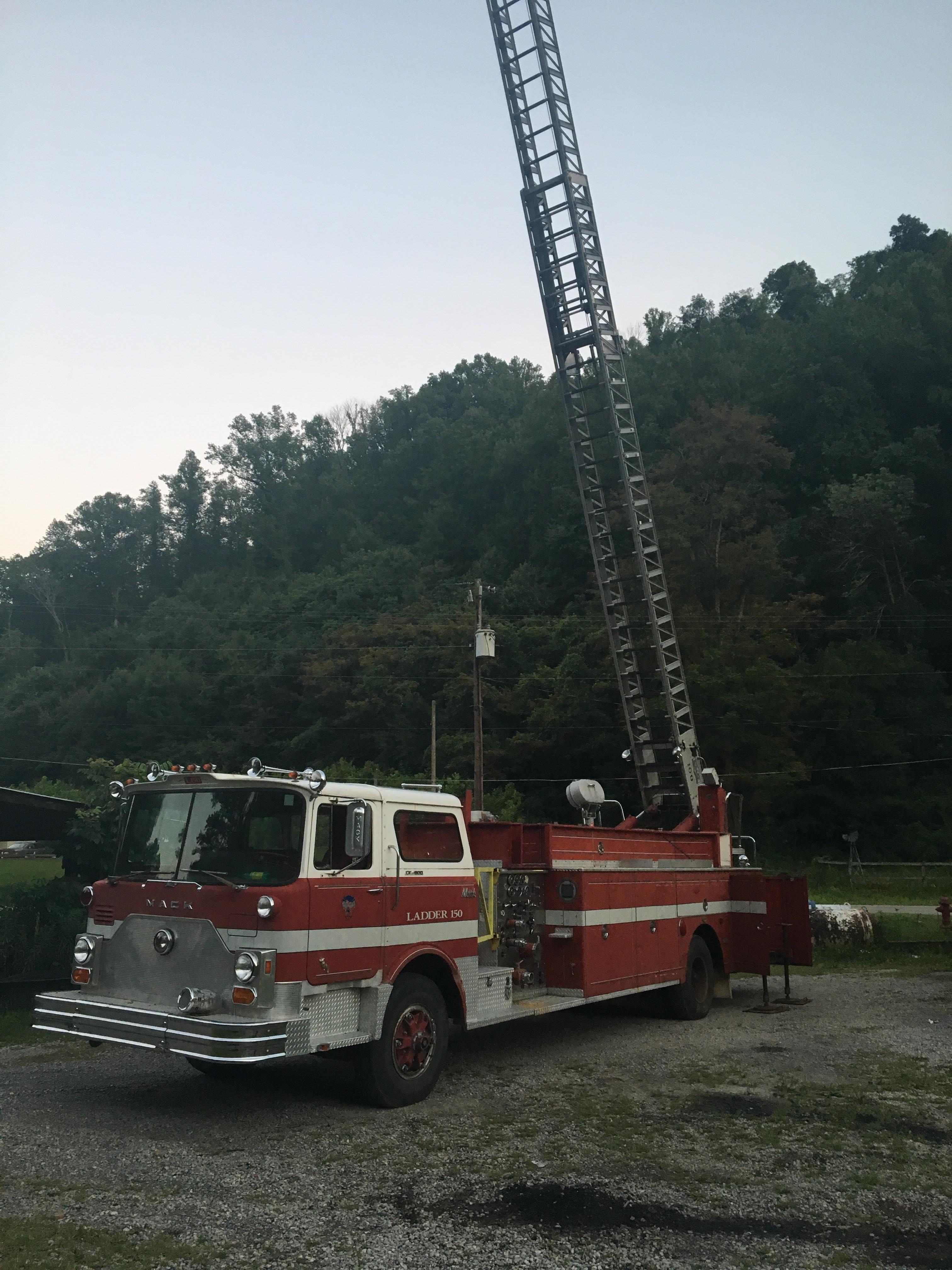

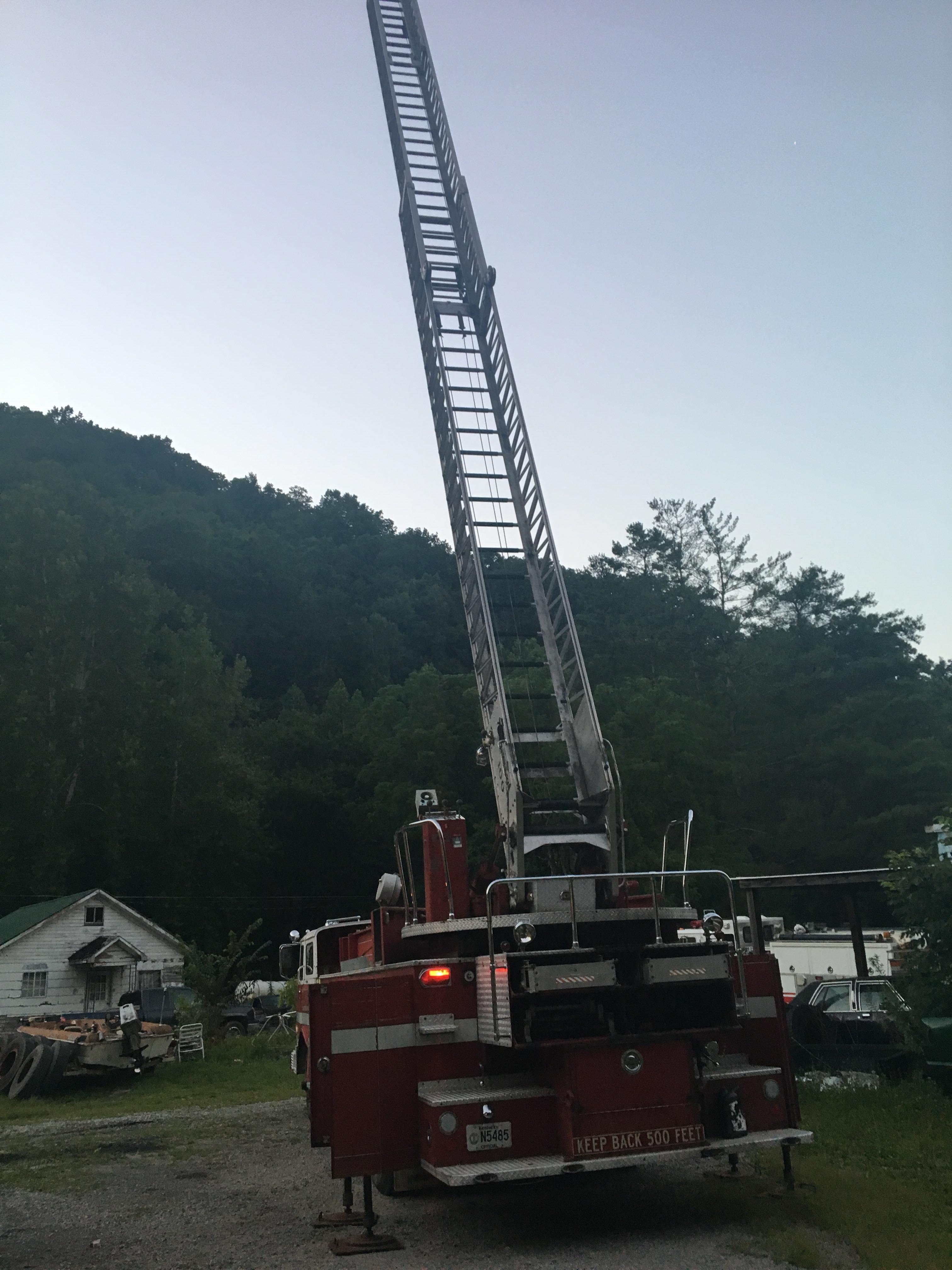

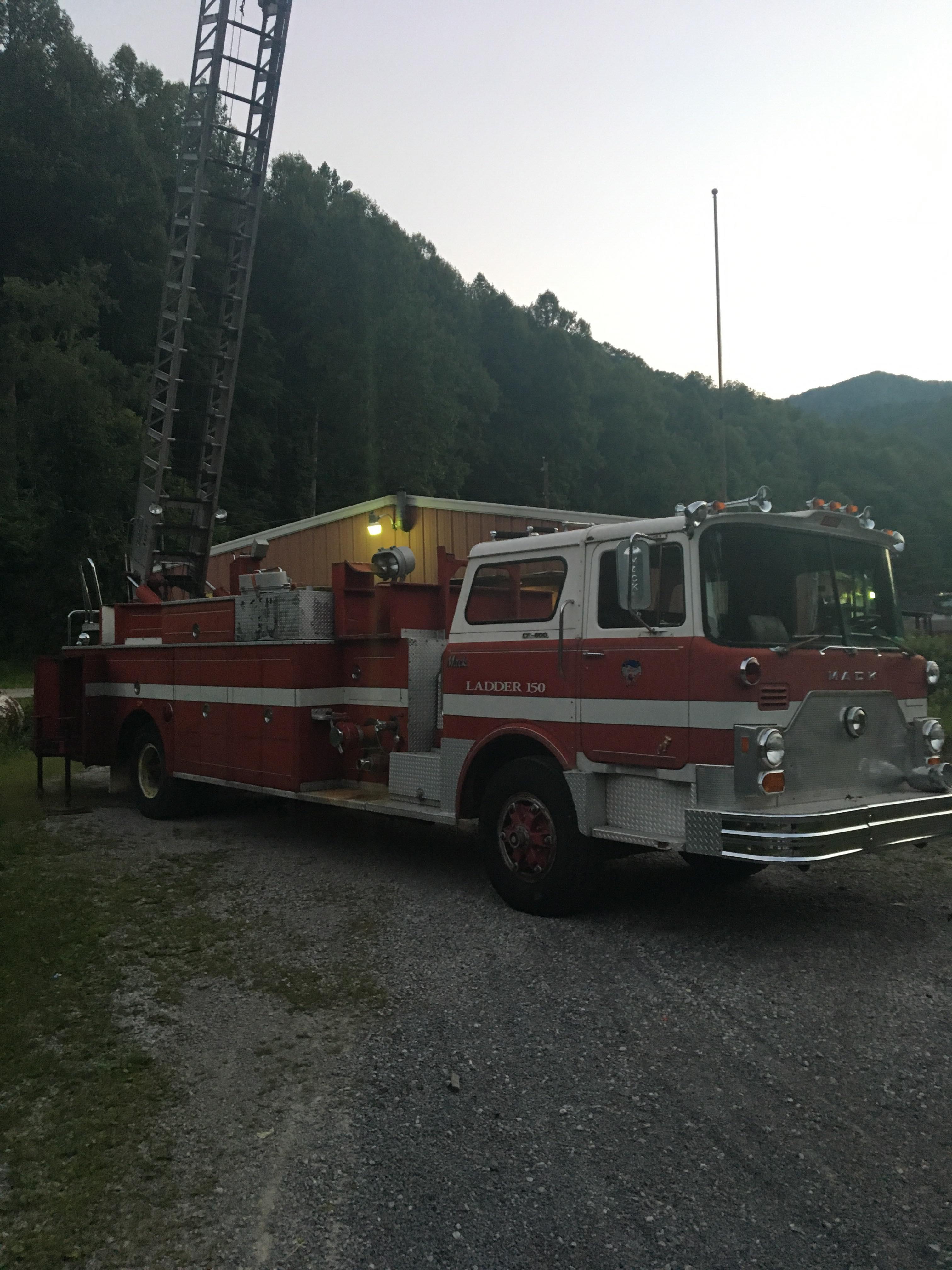

  15. We have a 1974 CF Mack pirsch 100 ft ladder truck for sale we got the truck about 3 months ago and can not use it in our area because it is too big she is 37 feet long. the truck orig was owned by river forest il. she seems to be a good solid old truck with the last ladder cert in 2017. she has a 1,000 gpm waterious pump. the dept we got it from retired her in 2018 when they got a newer ladder. if anyone is interested we are asking $3,500
