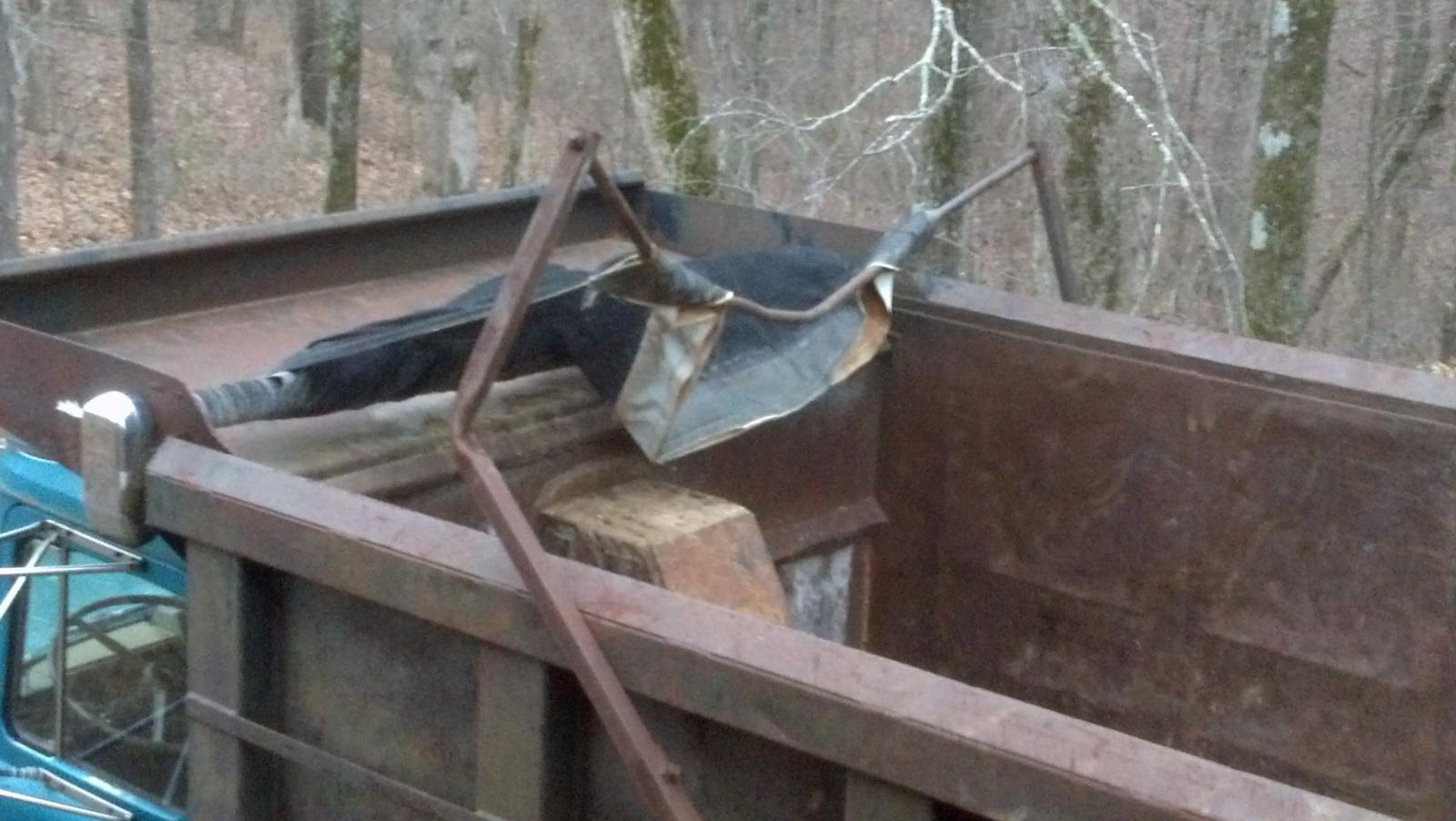

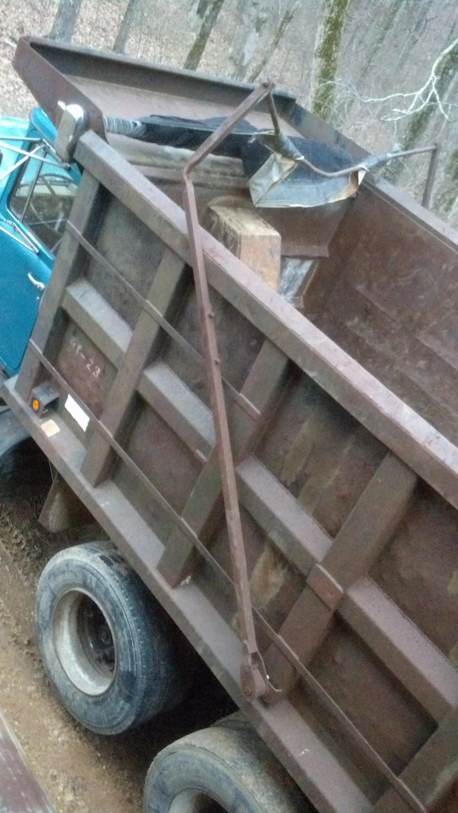

  4. Hello, as most of you know I just bought myself a 79 RD dump. I'm trying to bring a few things up to par and one of them is the tarp system. This my first dump so I'm not familar with this stuff....lol. But my upper arms and axle are in need or repair of replacement. I was wondering which to do. They are the square tube type and I've did some searching but didn't have much luck. Tarps aren't hard to find but the arms and axle parts are what I'm having trouble with. Not even sure what brand etc. mine are. I would also like some recomendations on a tarp. Photos below..thoughts?

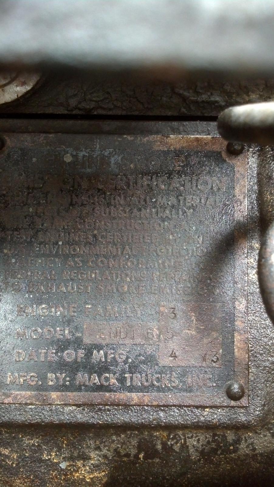

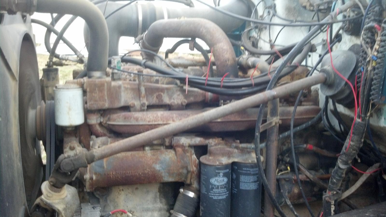

  7. Been messing around with the truck today. Got the engine tag clean to where I can kind of read it. I beleive the 2nd owner may have changed the engine and possibly the rears. Thats why I thought I was told wrong from my local Mack, I'm guessing. Got a call into the 2nd owner. As you can see on the engine tag the manufactors date is 4- 73, engine family 3, and model END T (?) 675. Thoughts?

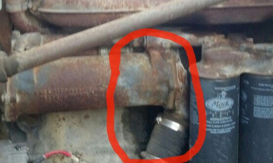

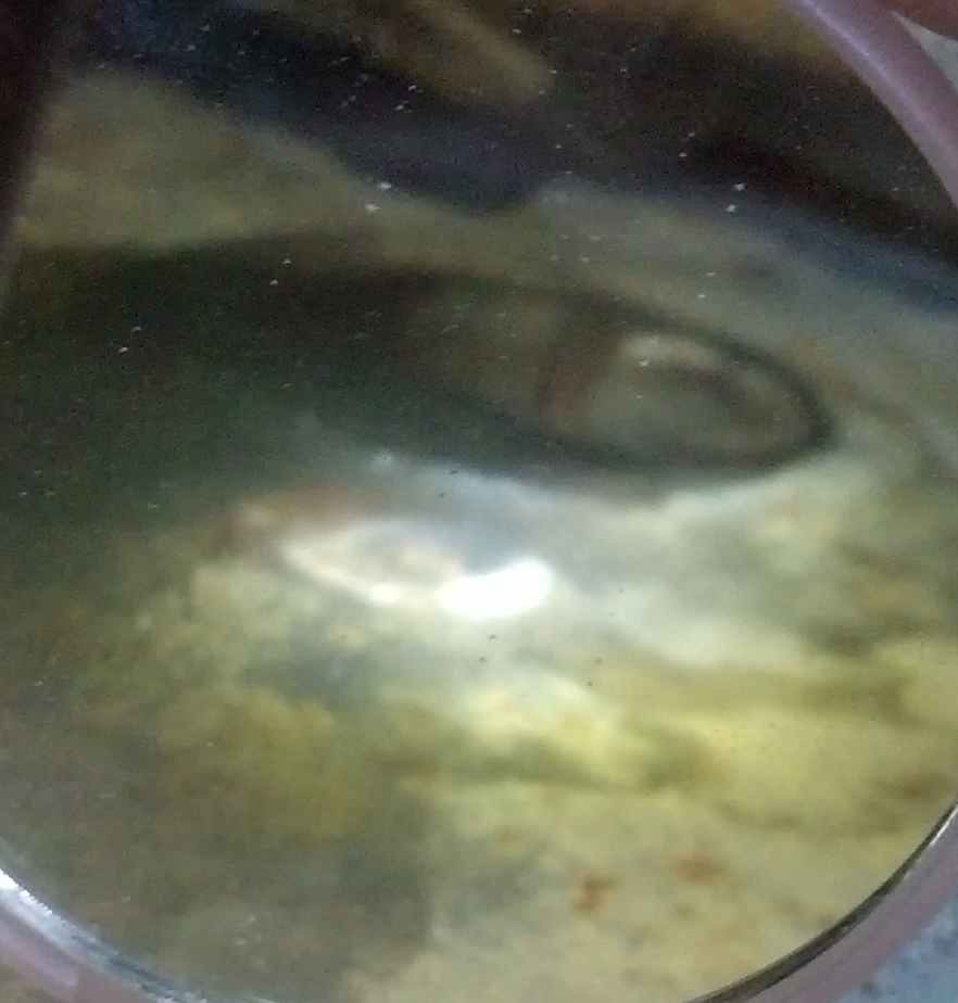

  8. Nope thats one of the plugs. Its leaking around it pretty good. Its behind the oil cooler so its hard to see and get to. I took that pic using a mirror.

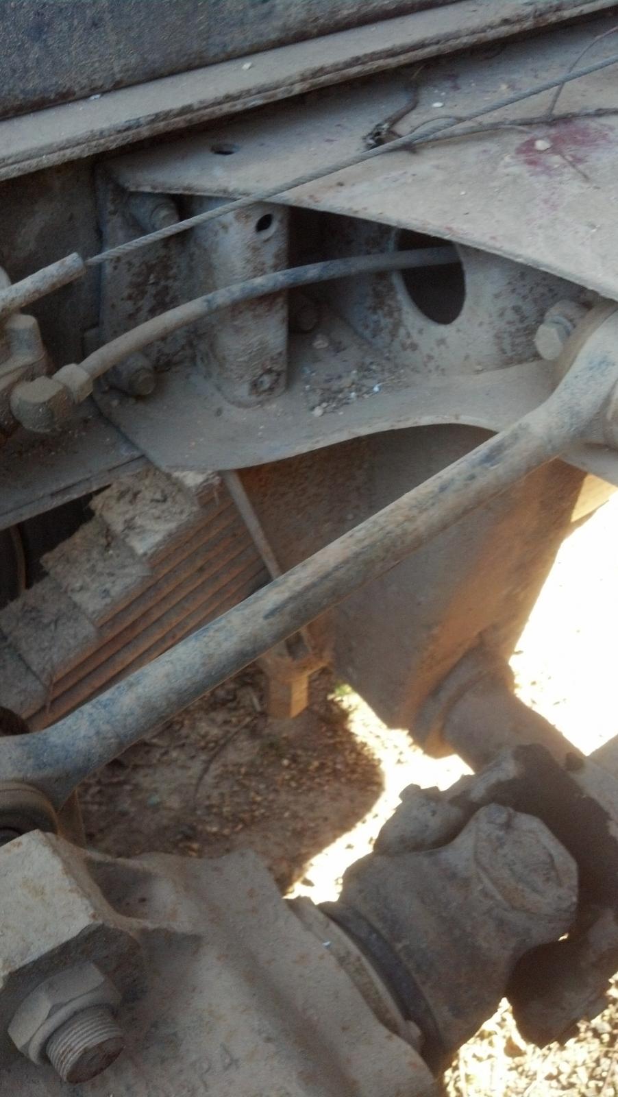

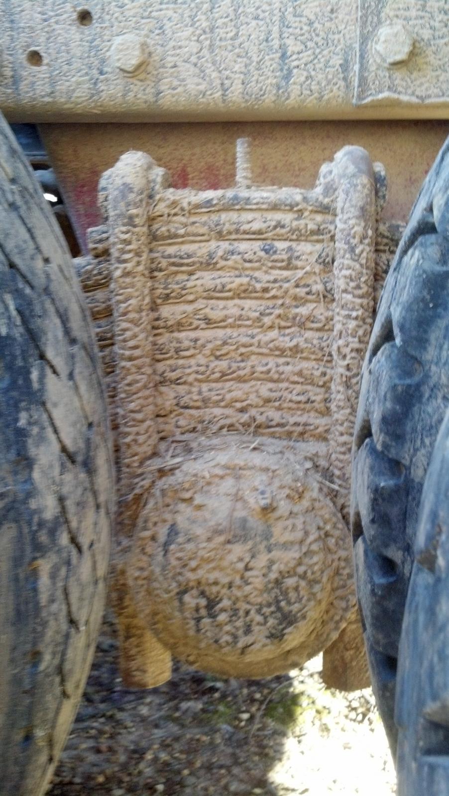

  11. Here's the coolant leak, I've also attached a couple photos of the suspension.
  12. Wasn't for sure how things hooked up or if there's a plug behind the cooler. Seems to be on the high side between the cooler and block.

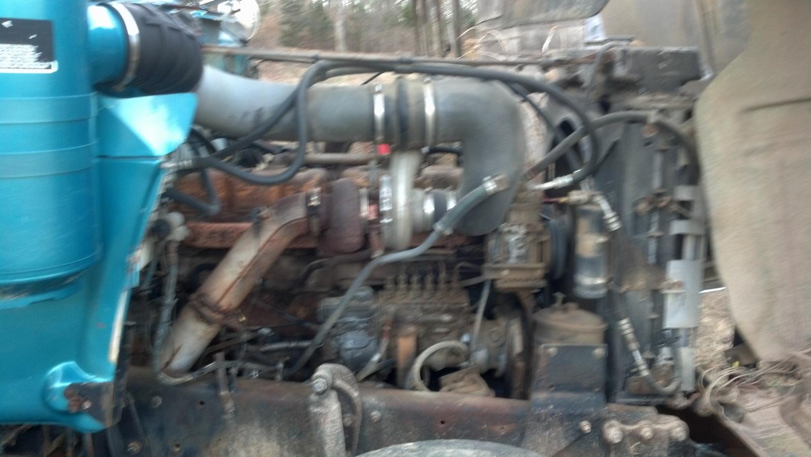

  13. Any tips on where this coolant leak might be? Hoses seem tight, it almost seems to be around the block behind the oil cooler.

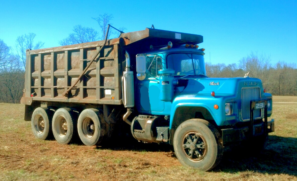

  14. I just had enough time to snap this shot on the way in today. In respect to the previous owner I removed his name from the door. I also just emailed the Mack Musem in hopes of receiving the correct information on the truck, mainly axle specs etc. I do beleive the engine is a 237.

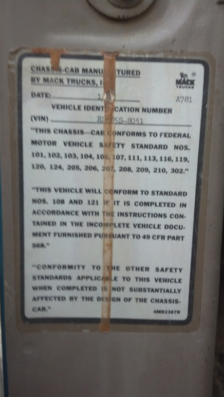

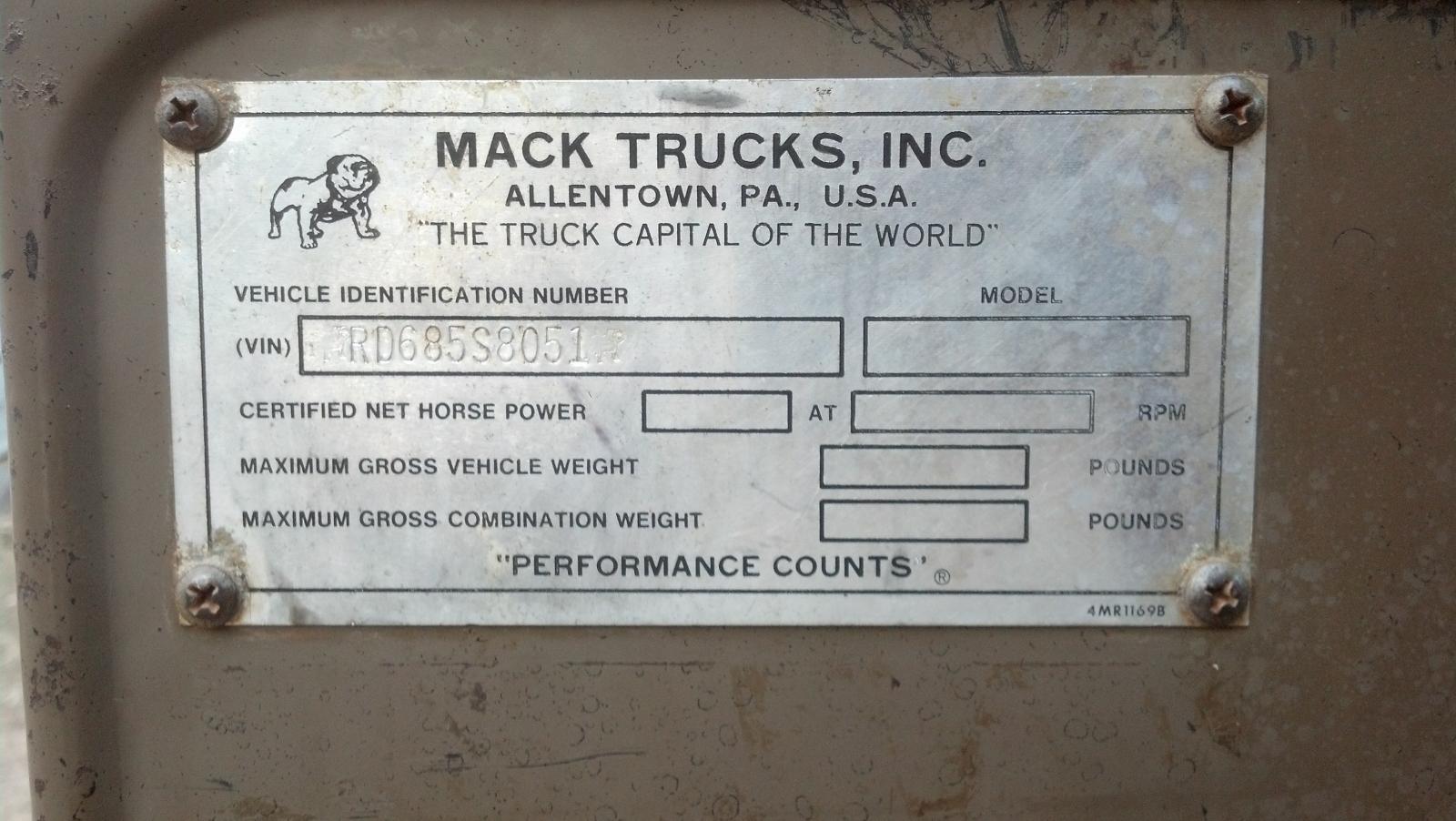

  20. They are now Nextran, used to be Premier Truck Centers Tuscumbia, AL. Always been very helpful, I'm confused why they got all this wrong. Here's the door tag which the vin matches up with a another sticker in the door jamb.

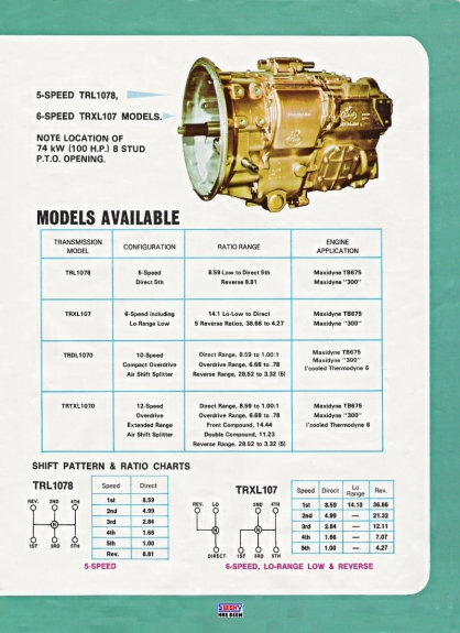

  24. Just made it home! Easy as pie! I feel more at home in that truck than my CH. My Mack dealer ran the #'s and had this to say: Mack 300+ engine (315 HP) TRXL107 2 stick 6 speed compact trans 464 ratio 38,000 rears with anti sway 18,000 front axle Build date 01-09-79
