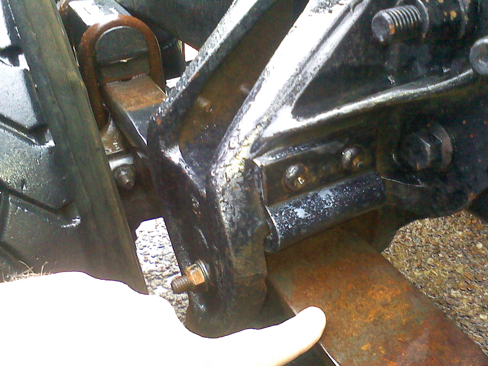

  4. For the record, when I talked with the service manager at my local Mack, he called the "Z" spring an "S" spring. Never the less, the main support member had a cost of $191.00 at the dealer and they charged me $150.00 to put it on. So once again, I'm truckn'....

  8. Looking at the parts diagram from hendrix and the "Z" spring is called a main support member, although I do like Z spring better. I also noticed that depending on which one I have, I see that some of them are for Mack only.

  12. Yea man that's it. I'm wondering if it's a mack part or not?
  13. Not for sure the proper name for this part (leaf spring?), but its broke. It slides threw the u bolts to the bottom of the rear air bag. How hard would it be to replace and what do you think it will cost?

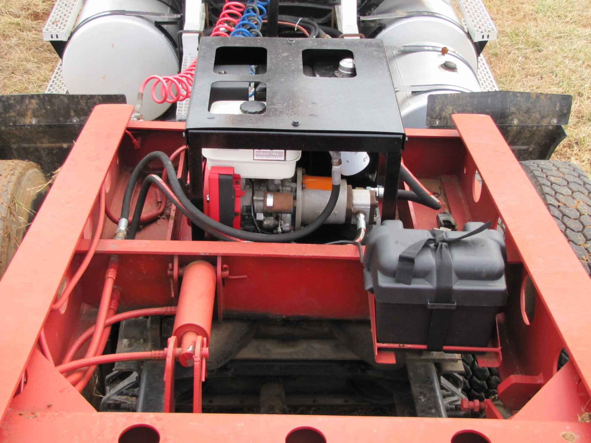

  18. Is there a general rule of thumb for slack to allow on the hydraulic lines coming from the truck?
  19. Thanks a bunch!. I forgot to mention that my trailer has two quick disconnects that the pony is plugged into. Could this take the place of the T's?
  20. My truck (96 CH613) has a single wet line that I have never used. The previous owner used for a dump trailer. I would like to add a dual line to operate a detach trailer. I also want to keep my pony motor, so I'm thinking I will need a diverter valve to keep the pony. Anyone have any input on what it would take to do this? Thanks
