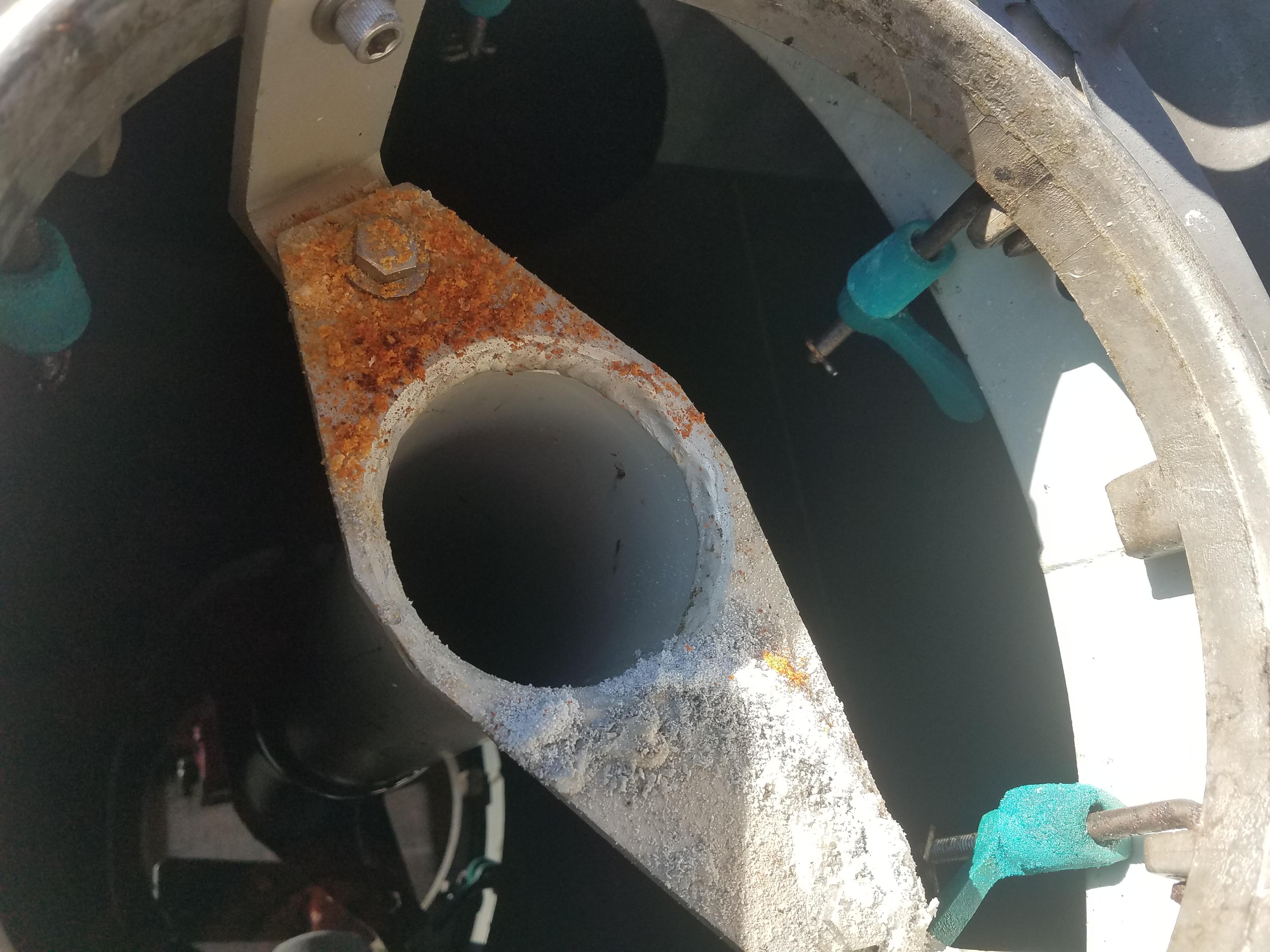

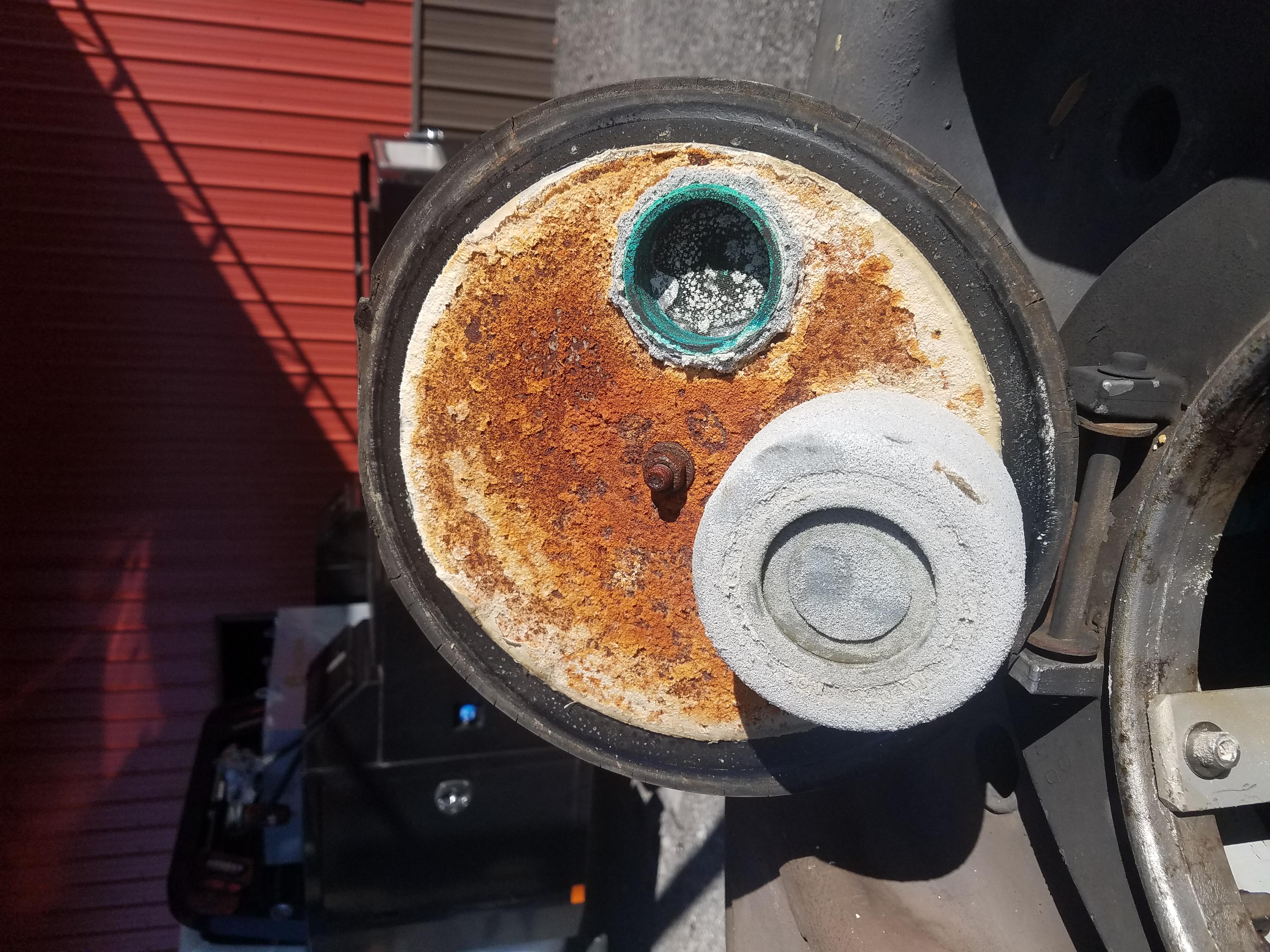

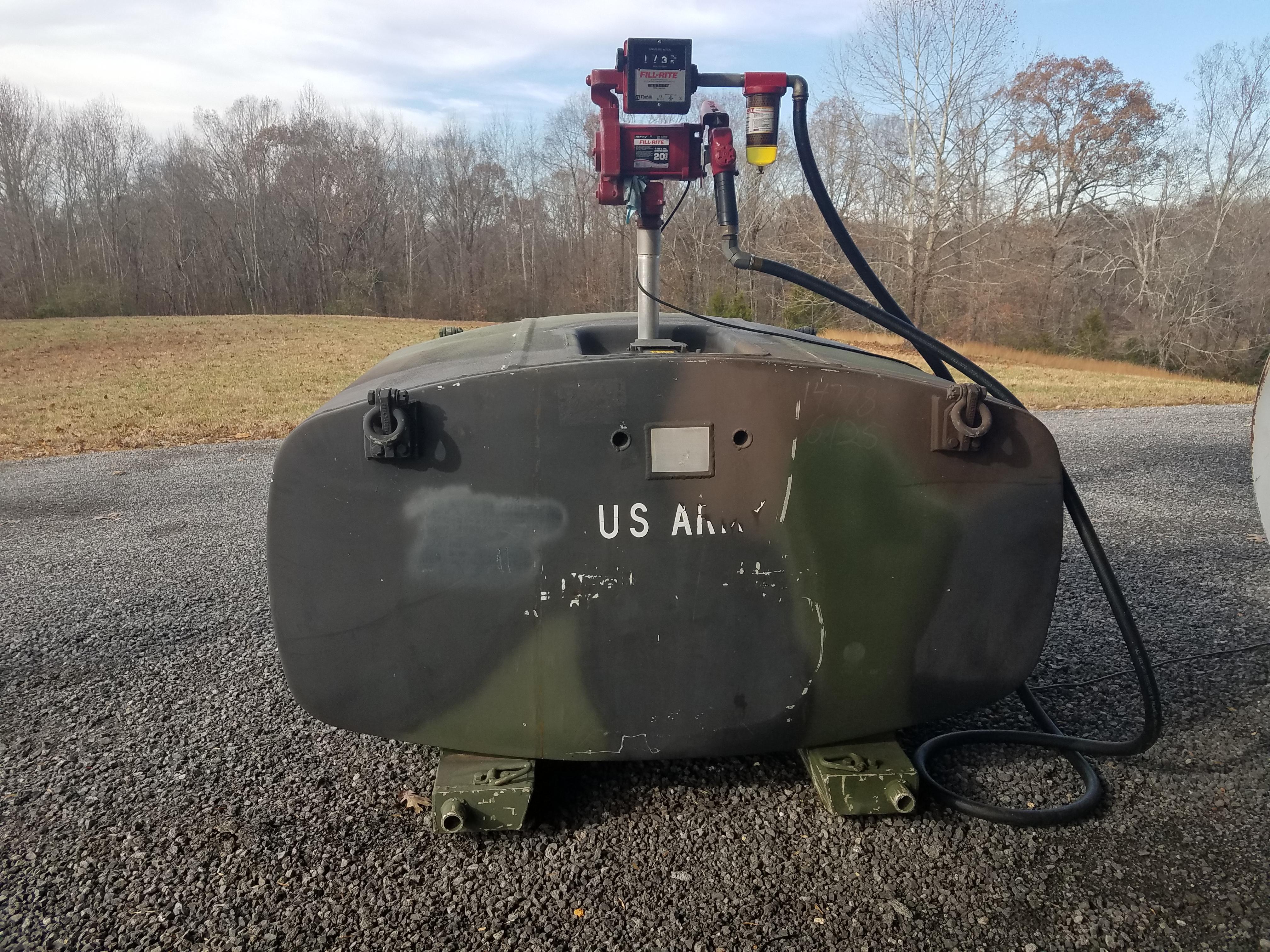

  1. It has always sit right on the edge of an awning and only gets wet in a blowing rain. That green circle on the lid is a vent and I'm not for sure what the bigger contraption hanging down is. That seems to be where the mystery powder is born. All the brass parts have turned green, but I'm thinking that's normal.
  2. Also, I don't think this tank was ever used for fuel. I believe it was used to transport water.
  3. Not sure, maybe I can talk my neighbor into tasting it..lol The tank was clean when i got it, then I washed it out with a brush and water before I put it to use, no chemicals. I keep a lock on it too. My fuel man says he's never seen anything like it. I'm a little worried if a 10 micron filter will catch it.
  4. I've got a 550 gal military storage tank I use to store diesel. I have it filled about twice a month so it doesn't stay in there long. I've been using it for about the past 3 years. This year is started doing something a little weird at the lid where you raise to fill it. Its got a very fluffy powder like substance and it seems to have accelerated corrosion setting in. Any ideas?

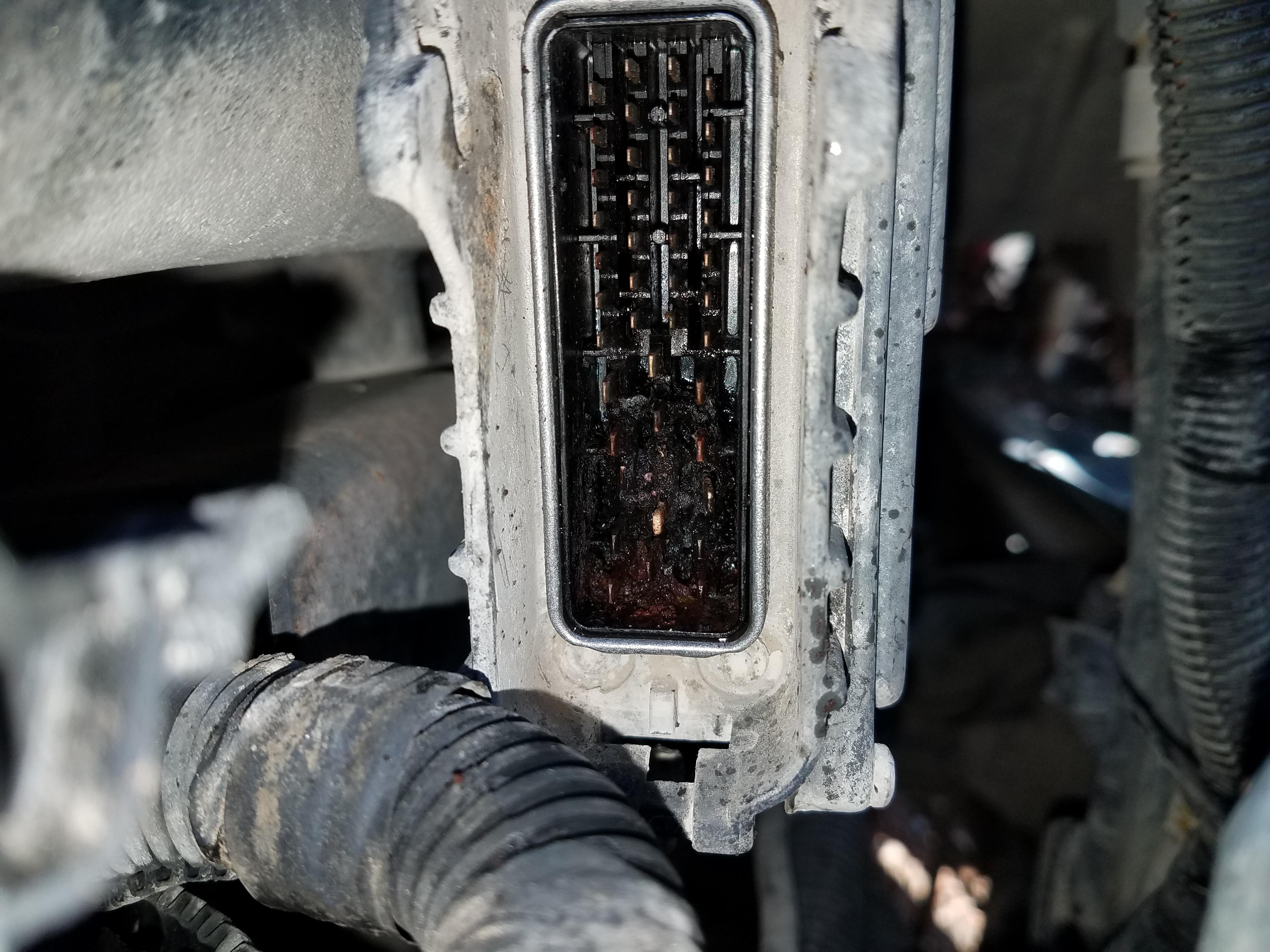

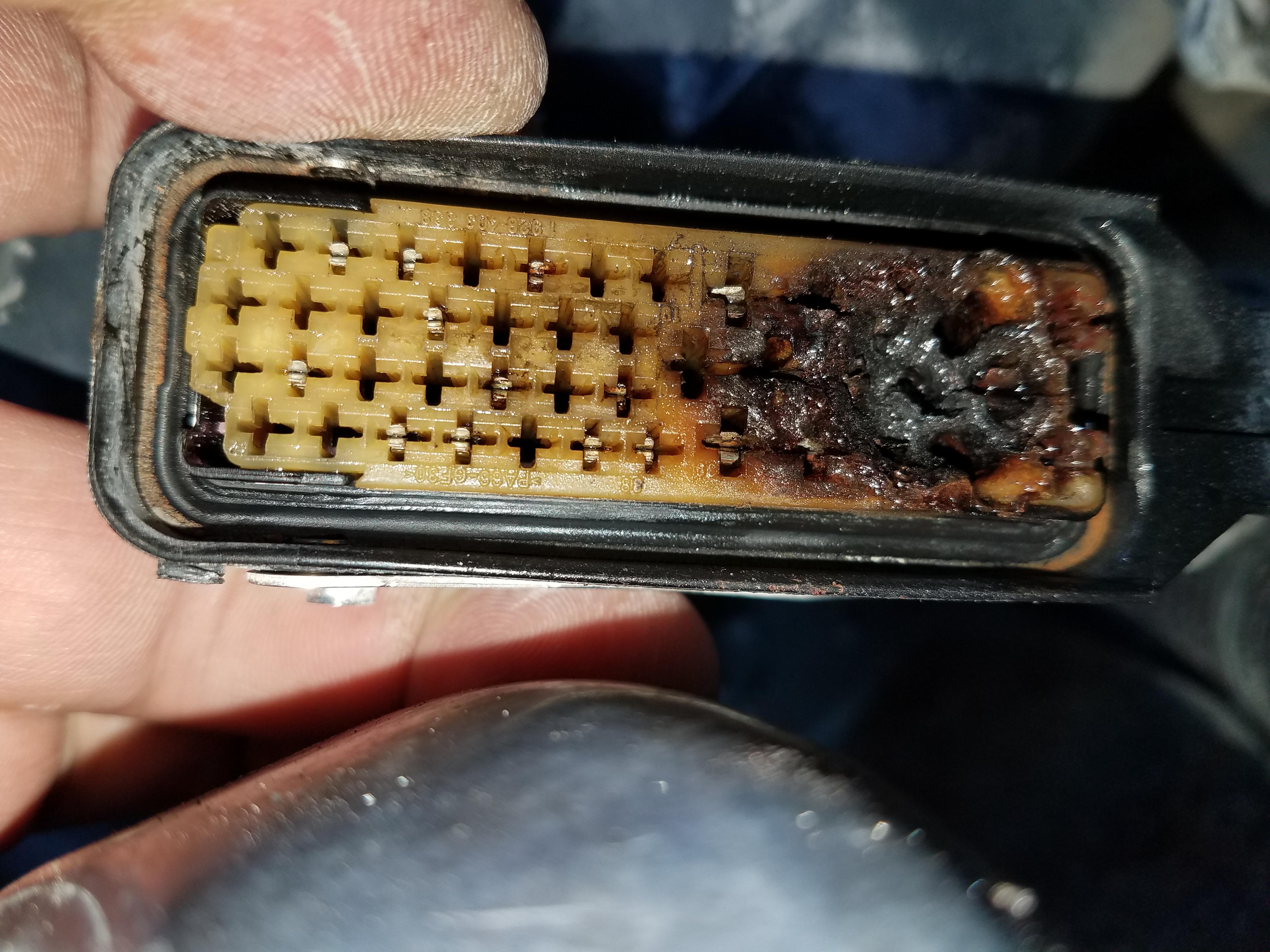

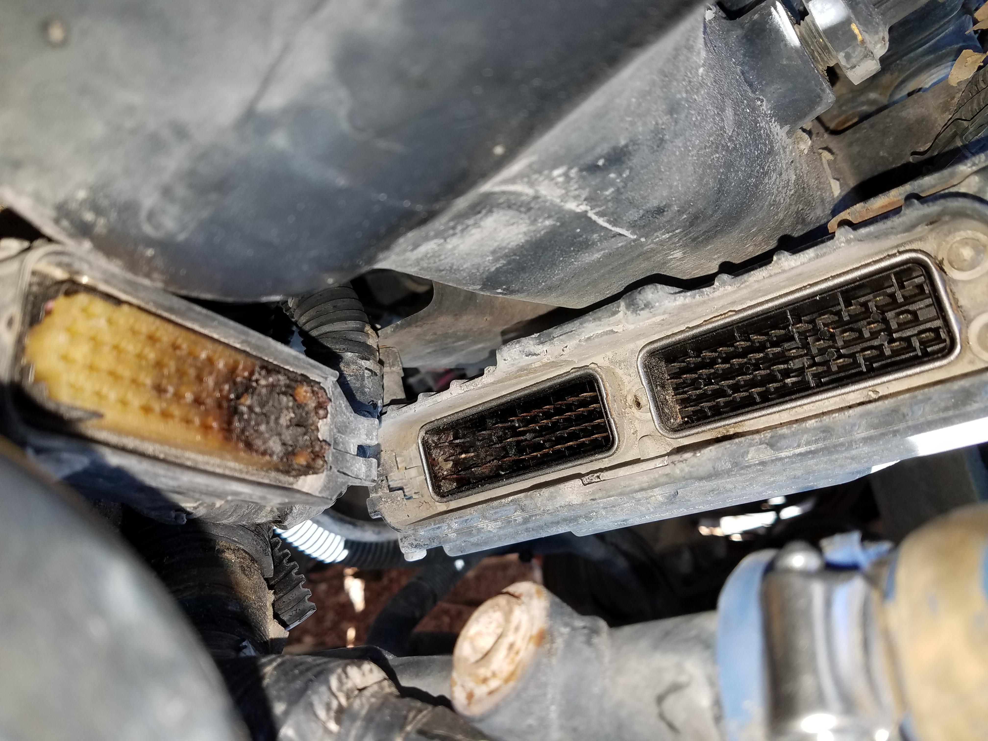

  6. No other fuses are blown that I'm aware of. Until I removed the connections and cleaned them at the ECU the fuse on the firewall would blow immediately. I cleaned up the connections today where it was toasted and it started, ran for maybe a minute and died with a blown ECU fuse. Pulled it apart, cleaned it again, replaced fuse and got it to run long enough to dump the bed then it started missing really bad and I just shut it down. I figured it was getting ready to blow another fuse so I was hoping to save enough of the ECU to get it loaded tomorrow.
  7. I went back out to the truck. I cleaned the connections the best I could. The harness connector and the pined connection at the ECU are both toast. Managed to get it running long enough to dump my load off. It kept blowing the fuse and when I would unhook the bottom connector on the ECU gas/pressure would escape. Going back in the morning with the lowboy truck and hopefully get it running long enough to load it up.

  10. It had leaks from the coolant tanks when I got it. I replaced those and the sensor etc. I'm thinking the coolant leaked down on it and caused the corrosion and short, especially since all the trouble is at the bottom. I'll take a closer look tomorrow and check the pins out. The pin connector/harness looked to be toast.

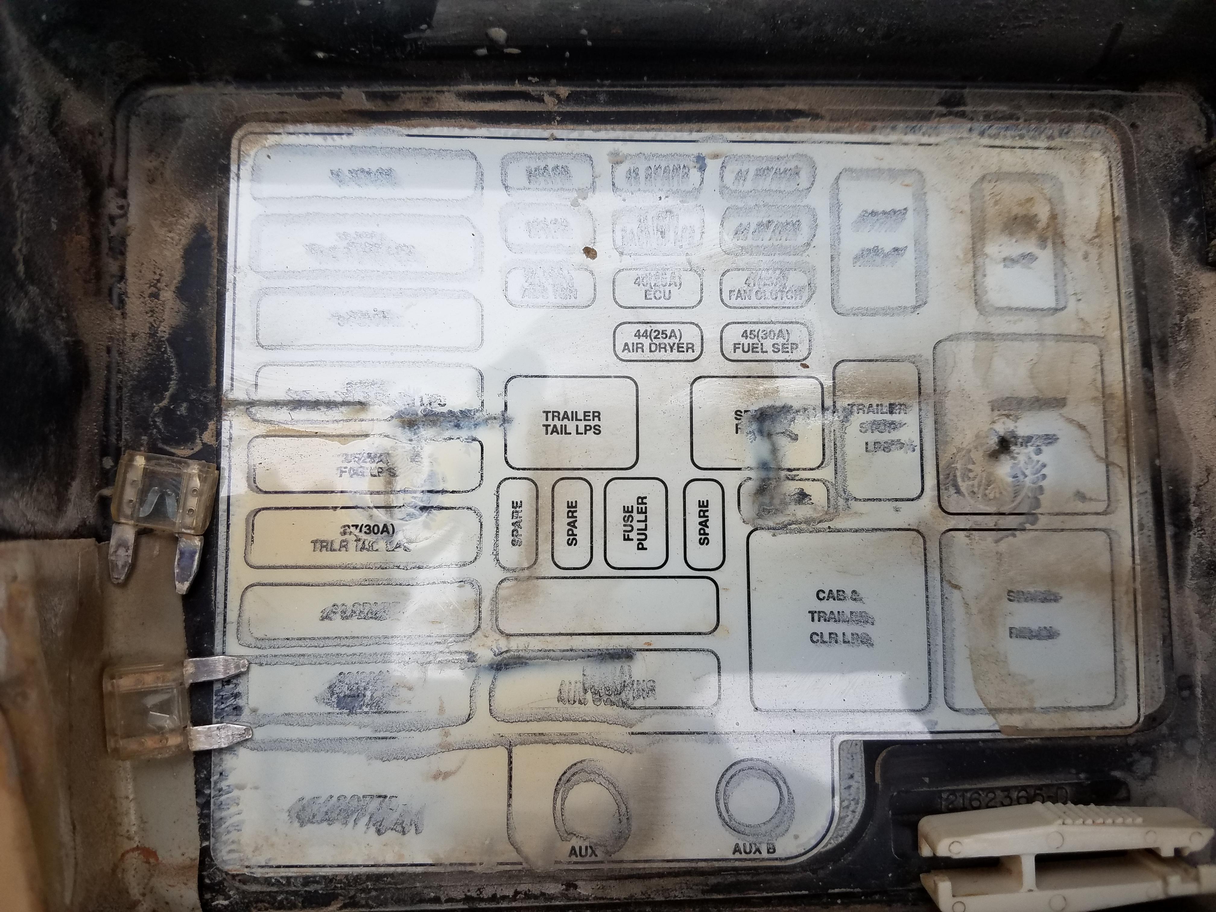

  13. One of the few fuse descriptions I can make out from my panel is ECU and its blown. Replaced it and immediately blew again. I've heard of the firewall fuse panels giving trouble. Think its possible or it's the other. I haven't had time for a full diagnostic test due to rain. Gota brief break and found this.
  14. Does anyone happen to have the diagram for the fuse panel on the firewall. Mine's smudged up and I cant read it.

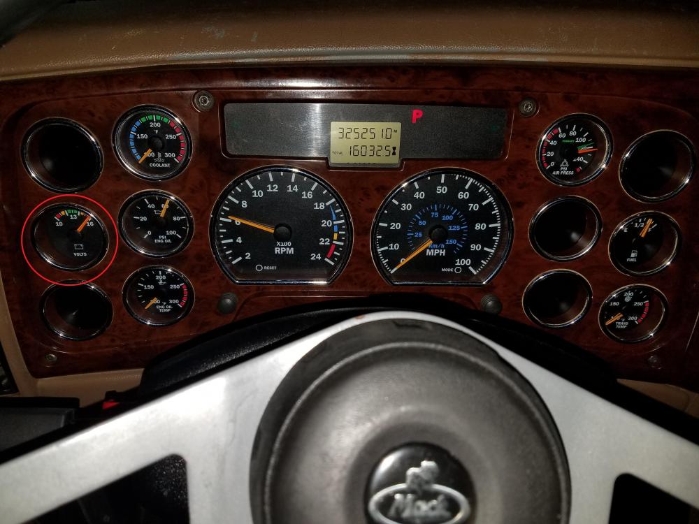

  15. I can't thank you enough. I'll let you know what I find out. Let the fun begin!

  17. Thank you for that information! I'll check that first chance I get.

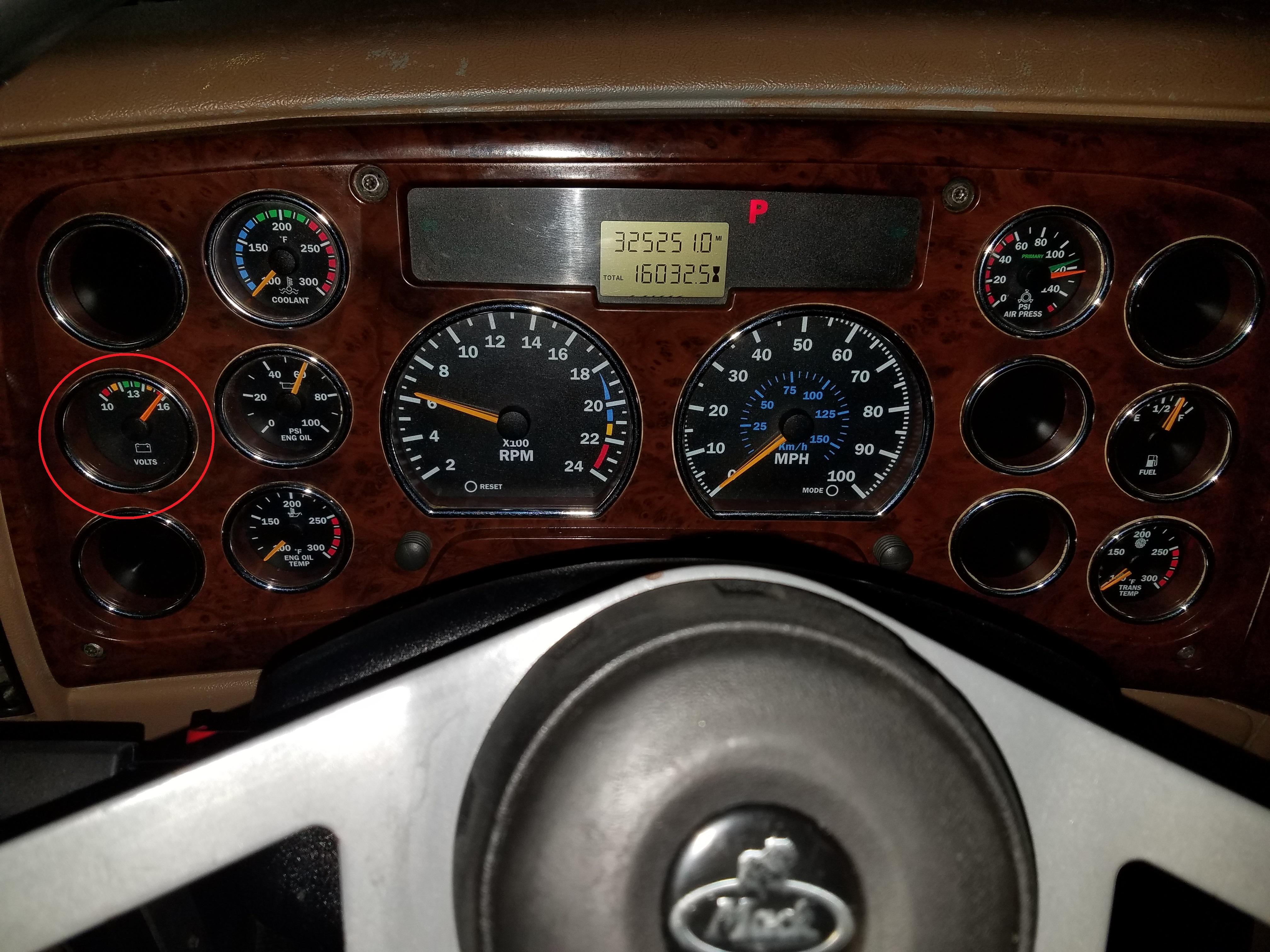

  19. The possibilities of the previous owner are endless. For example, he welded my gate pins in place. I mean come on now! Had to carry it back to mack today because they turned off my engine oil temp gauge from the previous update 🤦‍♂️, so I had them to look at while it was there. He said it had to be the in the dash because everything else checks out. All other gauges work fine except my fuel gauge, it can be squirrely at times but I'm sure that's probably the sending unit. I've attached a photo showing my arrangement with the voltmeter circled in red. If it's right or not I couldn't tell you.
  20. I'll check it out again when it gets back this evening. It's been like that since I got it earlier this year. The only problem I've had is one time it "glitched" and the lighting bolt and ABS light came on with loss of engine power for split second. Then it cleared up almost instantly but I honestly feel like it hasn't run the same since. Mack said it did have a stored code, cant remember what it was. but basically something had shorted out somewhere, but unless the code was active it would be hard to pin down.
  21. I've got a voltmeter pegging out. I've checked all the grounds, replaced the meter itself with no luck. It's charging normal, everything checks out with my hand held. I'm sure its grounding out somewhere but I was hopping someone might point me in the right direction. Thanks in advance!
