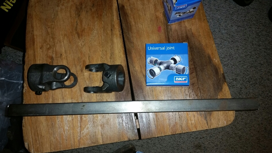

  21. It never ends...lol, The PTO has never worked better, didn't realize how bad it was until it was fixed. But, didn't get to dump my last load yesturday, somewhere in between the load before and the pit, I lost my PTO drive shaft. Someone must have forgotten to tighten it or push it back far enough. Twenty mile round trip from job to pit, needle in a hay stack! Rain, snow and sleet today so guess I'll be burning up the phone searching for one.
